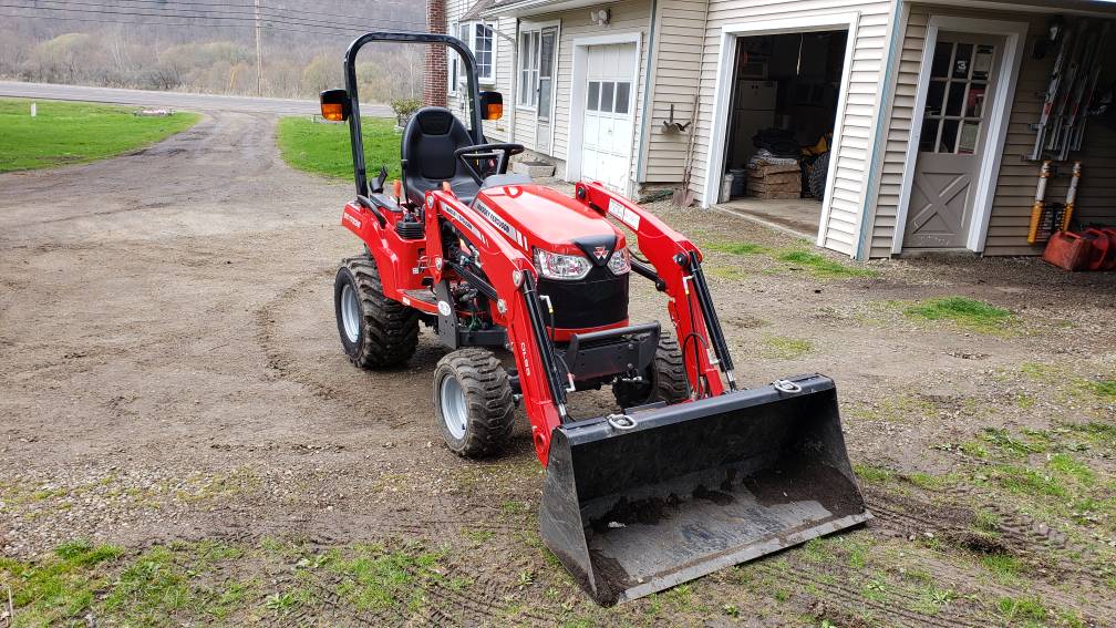

I had a tree branch put a baseball sized dent in my hood the day I brought it home new. I pulled off the hood, pounded out the dent, touched up with Bondo, masked the area off and sprayed it with rattle can bed liner. Looks factory nobody has ever questioned it. Told my neighbor about it and he searched the hood for a few minutes, then told me I was full of it & never dented it....... Had to hide my F-up 20200429_094317.jpg20200429_101829.jpg20200429_105600.jpg
