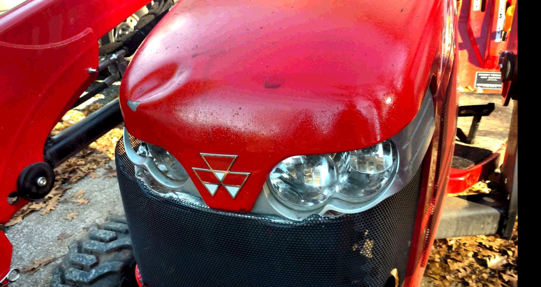

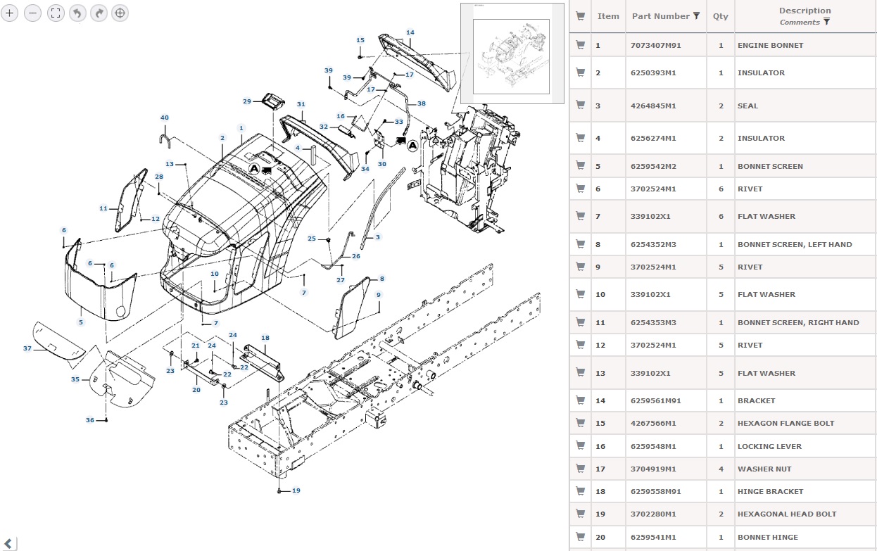

Looks like your hood hinge may have detached partially from the hood. Might require a quick weld.

As long as I watch the temp gauge, can I run my tractor a bit with no hood? Or might that cause a cooling airflow issue or some other problem?

I'm away from the tractor now, but I was able to download this picture taken the day of the damage.
As a thank you, I gave each person a $100 Amazon gift card and we took them out to a steak dinner. Total about $1,000. If a new hood is $1,000+, it cost me over 2 grand to get about 5 cords of split wood. :(

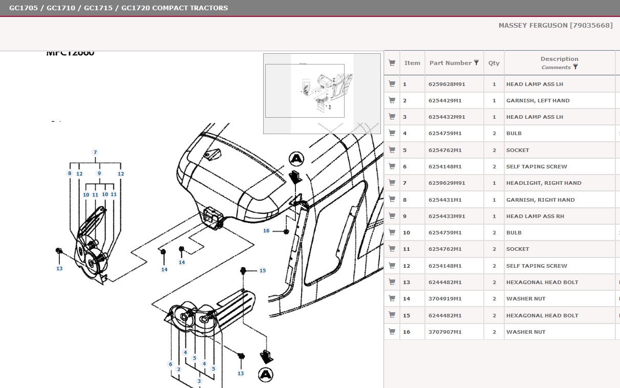

Now I'm wondering, as someone suggested, if a body shop could do a reasonable repair? If I could come up with a headlight assembly?
Looks like a good place for a pair of shark eyes and then teeth on the lower grill.....like a P-51 Mustang.....

That paint on your hood looks to be in rough shape anyway. I doubt if any paint will ever be a perfect match. Tractors are Tools and are meant to be used. Dents and scrapes happen.
I noticed that. it is a long way from a show room finish when it came from the factory. That is why a good experienced Rattle can applicator, with some proper matched paint (dealer usually) would be just fine after the dent is knocked out, filled and sanded. No way I would spend more than $15 on paint and a shot of primer.
I dont think cooling will be an issue. Cover it after use, to keep rain off of it. Should be fine for a while.
