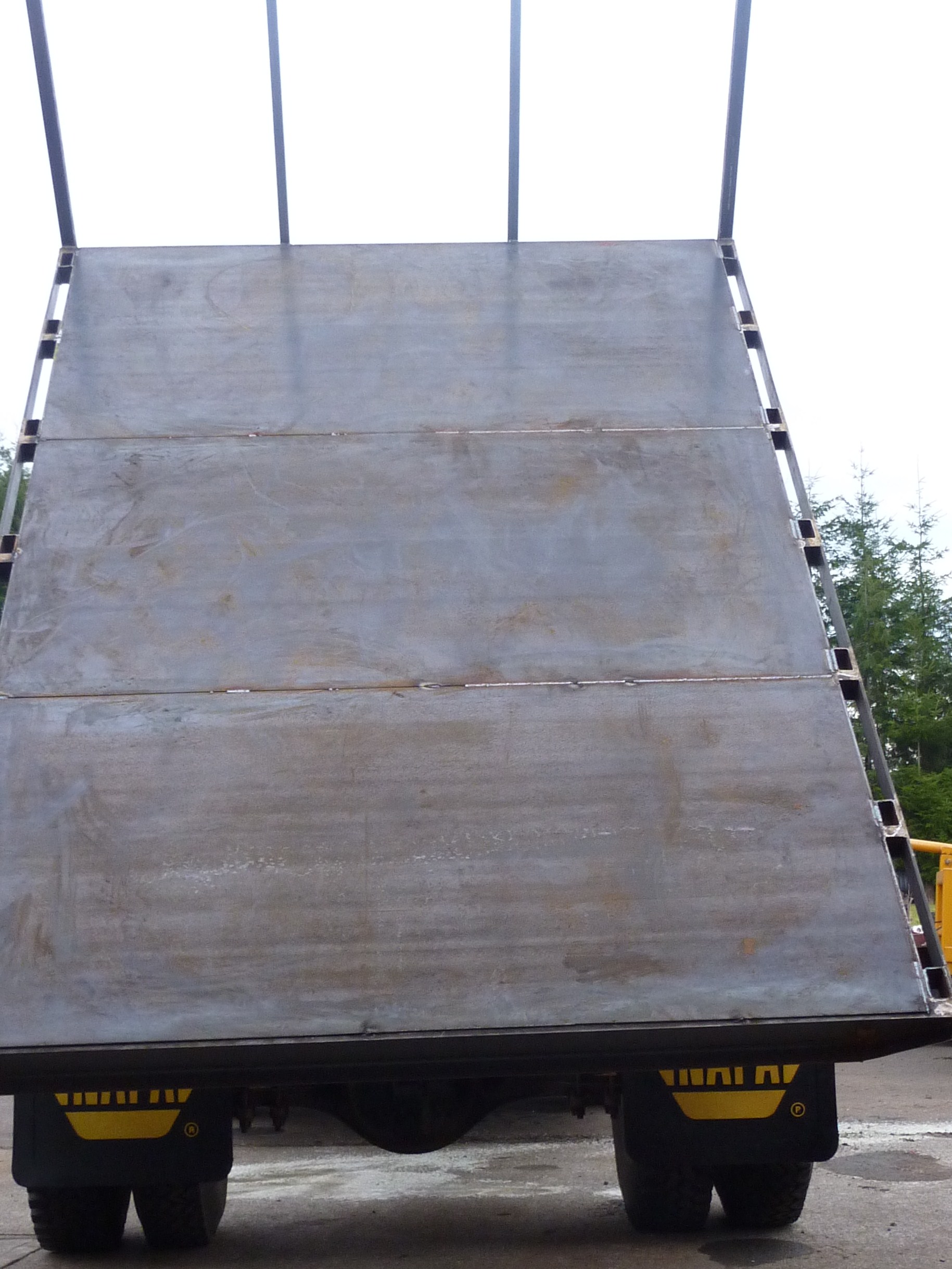

few more pics. Put the ladder on the left front, and tacked on the deck. Will finsh that up and take care of the cabguard tomorrow.
I'm happy with the hieght of the lift. I don't think much will stick on that except wet dirt and clay.

Finally finished the welding today. Put a coat of ospho on the whole thing top and bottom. Of course it started to rain again so painting is out of the question. Too damp, even in the shop.
It turned out pretty good with the cabguard. I did the upper half with expanded metal. Was thinking of tapering the upper part to conform to the cab, but went straight up instead. Far as looks go, hey, it's a work truck, not a parade limo.
Oh well, now for the trailer hitch. Did I say finished with the welding? Just one more project lol.

Well folks, this has been the build. the bed and all is finished, it works great and looks nice.
