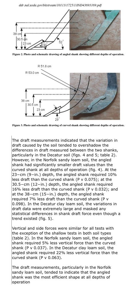

Subsoiler shank style comparison test:
Bruce
Bruce
Thanks Bruce, I'm happy to see its easier to pull an angled ripper than a parabolic. The plow frame I have has an angle of about 54*(could be 52*). To make things easier to cut/fit I set everything up on 60*-30*.
I tried it today and it didn't go very good. It's still pretty wet so the tractor had a hard time hooking up after 10"s. With both rippers it went in the ground nice and even but was to much so I removed one ripper. There's no way I'll be able to pull a single ripper with the set up I have now, I only have a chain connecting the lift arms. I need a turn-buckle on the left side of the tractor because when the ripper starts to enter the ground the other side of the plow frame goes up causing the ripper to tilt while its in the ground. I'll give it another shot in a few days after things dry up. I'll grab a turn buckle from tractor supply too. Worst case I'll make a new mount for the single ripper to keep it centered behind the tractor.

It seems we have some conflicting information. The artical Bruce posted showed that an angled ripper was easier to pull in different soil conditions. In the URL it looks to have come from the USDA.
