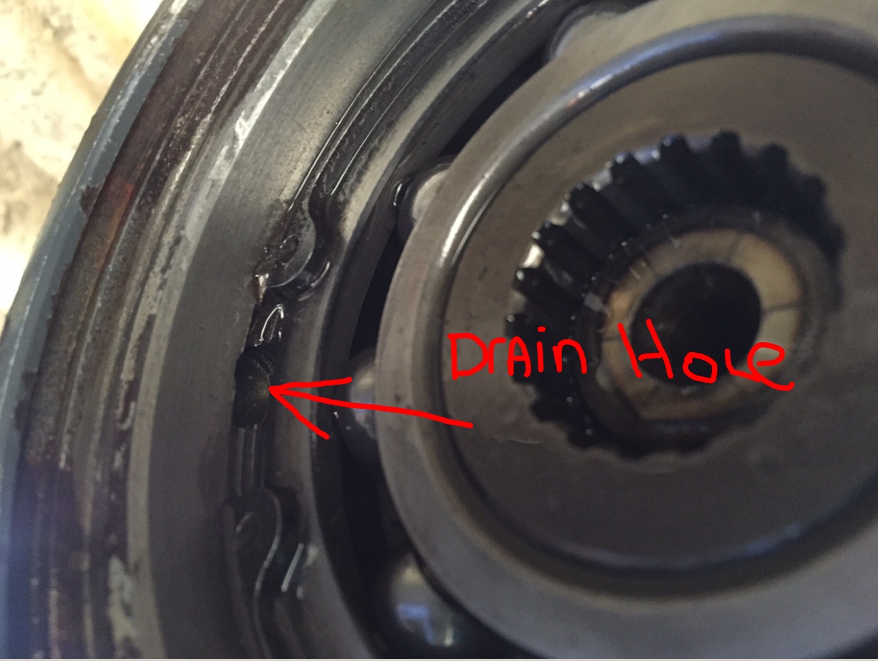

Was draining the front axle,center bolt,decided to check the small bolts on each end one came gushing out,the other just dripped real slow as if it was empty,so I opened the top big plug and it came gushing out the top.I ran a wire thinking the bottom plug must be restricted,but nothing?I gave it a shot of air and it all came out the center plug on the axle,never did come out the bottom plug on that side.I decided to drain the axle because the site gauge was reading empty.I dont have a manual,but It seemed to have almost 2'gal in the axle.When you fill the axle thru the top plug,I'm assuming it all eventually goes where it should if on level ground??? This is a dk40 se 2013 with 110 hours. Anybody have any ideas??

I had this problem. When looking into the drian hole I could see something real shinny. I called my dealer and spoke to the service rep. I explained what happened and what I saw. He figures the bearing race was put in wrong.
   / Front axle draining #5
No, it is not the bearing race. It is the plug in the bottom that seals the assembly. Look in there and you can see the top of the o-ring [at least you could on mine] where it seals the bottom section. I believe the housing was just machined a little deep. I pulled mine apart just to be sure. CJ

Fix for what? If your concerned about it not draining out all the way, you can take it apart and grind a slot by the drain plug to allow it to drain faster. But to me it was not a big issue after cleaning out the little bit of metal that was in there from the new gears wearing in, I just reassembled it. Would not be a problem to leave it as is. CJ

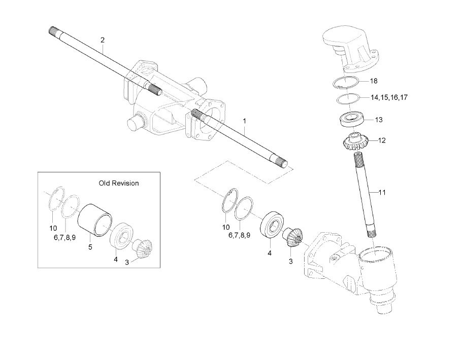

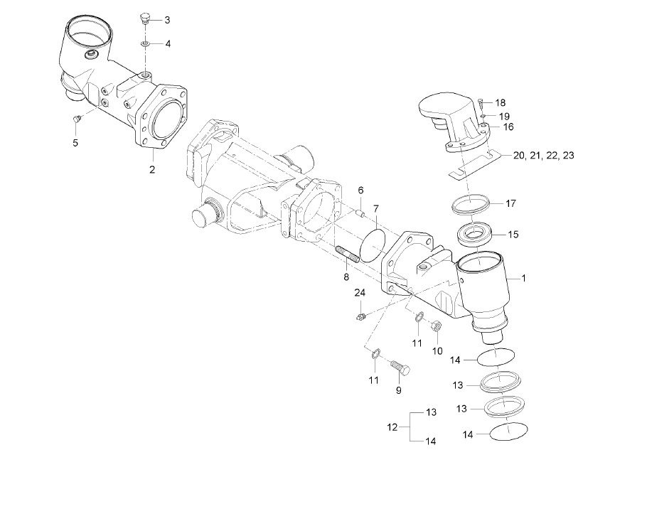

Here are a couple exploded views of the axle that may help everyone talk about it.
