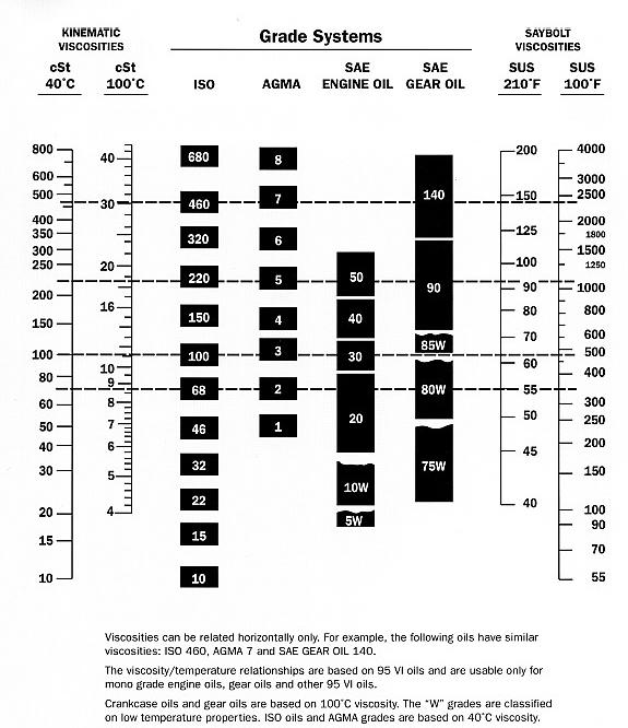

The 80/90 is not heavier than the transmission oil. They are about the same viscosity.
The gear oil viscosity scale is not the same as the scale used for motor oil, giving people the impression that it's heavier.
Pour the trans oil and the 80/90 side by side, and you can see they are basically the same viscosity.
If you want better cold weather performance, you could use synthetic 80/90. Some brands are only a few dollars more than conventional.

   / Front Axle Fluidf #8
I do not think that is true . The oil used in my hst is a 10w30 viscosity ( oem fill). I actually use Amsoil ath which is a 5w30. Alot thinner than a 80 w90 gear oil.
   / Front Axle Fluidf #9
I understand that people find this hard to accept. Believe what you want.
If you are really interested in knowing, do a timed viscosity test yourself. It's very simple to do. I have, it's not "a lot thinner". I tested ATH, (which I use), and a conventional 89/90. Both had similar characteristics at 70F. As I said, pour them side by side, and you will see that.
As the chart indicates, viscosity varies widely. Each brand is different. No oil you test in the 30-50w range for motor oil, is going to have a significant difference in viscosity at 70F. No 80/90 gear oil will have a significant viscosity difference, between it and hydraulic transmission oil.
That is precisely why they are interchangeable in a differential. They are both basically light weight gear oil. The transmission oil just has different additives.
   / Front Axle Fluidf #10

   / Front Axle Fluidf #12
What happens when you try pouring that at say 20 degrees F ? I believe my Amsoil will flow at -50 F. Gear oil will be solid.
No one questions that synthetic oil is better at extreme temps.
No 30w transmission oil, or 80/90w gear oil, is going to be thick enough to be a problem in that diff. at in there at 20F. Manufacturers would not allow either to be used in this application if it did. My manual, specifically says it's fine.
As I, and the other poster said, you can spend $3 more, and use synthetic gear oil if you are worried about it.
