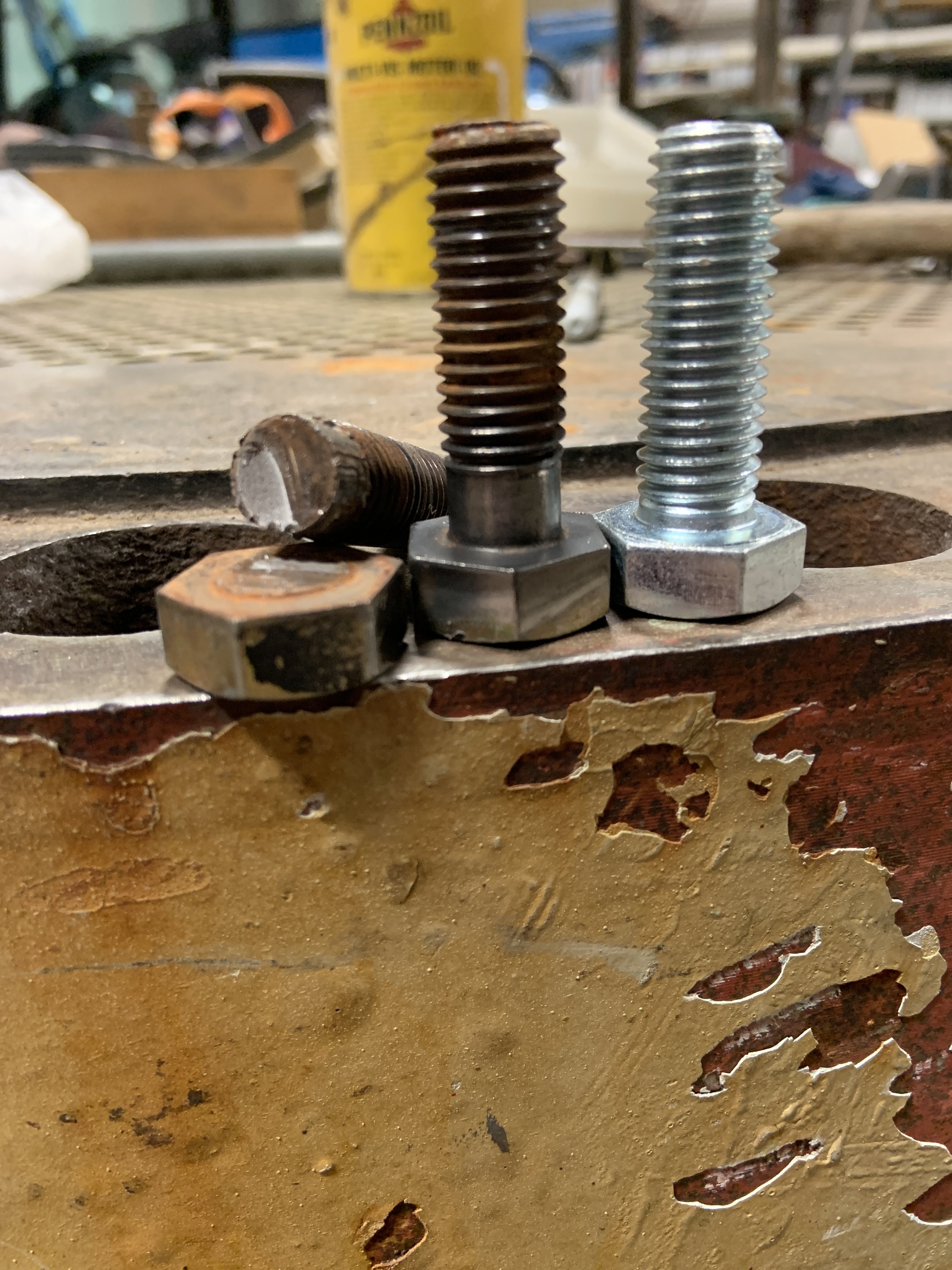

Broken bolts on front axle
   / Broken bolts on front axle #21
The problem is the bolts are junk they have a very sharp stress point under the head. I had the same issue.

My experience with fasteners demonstrates that most commercial graded fasteners are below the spec’s in their grade. I was in a test in graduate school at Texas A&M and checked grade 5 & grade 8 fasteners with hardness testing and tensile testing. Everyone was below the standard.
Later in industry, I ran into this with run of the mill commercial fasteners. The best solution was to specify particular brands and hardness test them for compliance for important applications.
I fought our buyers because they tended to choose Chinese suppliers with predictably bad results.
I was a manufacturing engineer manager with a Japanese forklift company. We were very careful with correct torque on most assemblies.
As a result, the warranty issues were nil during my time there.
