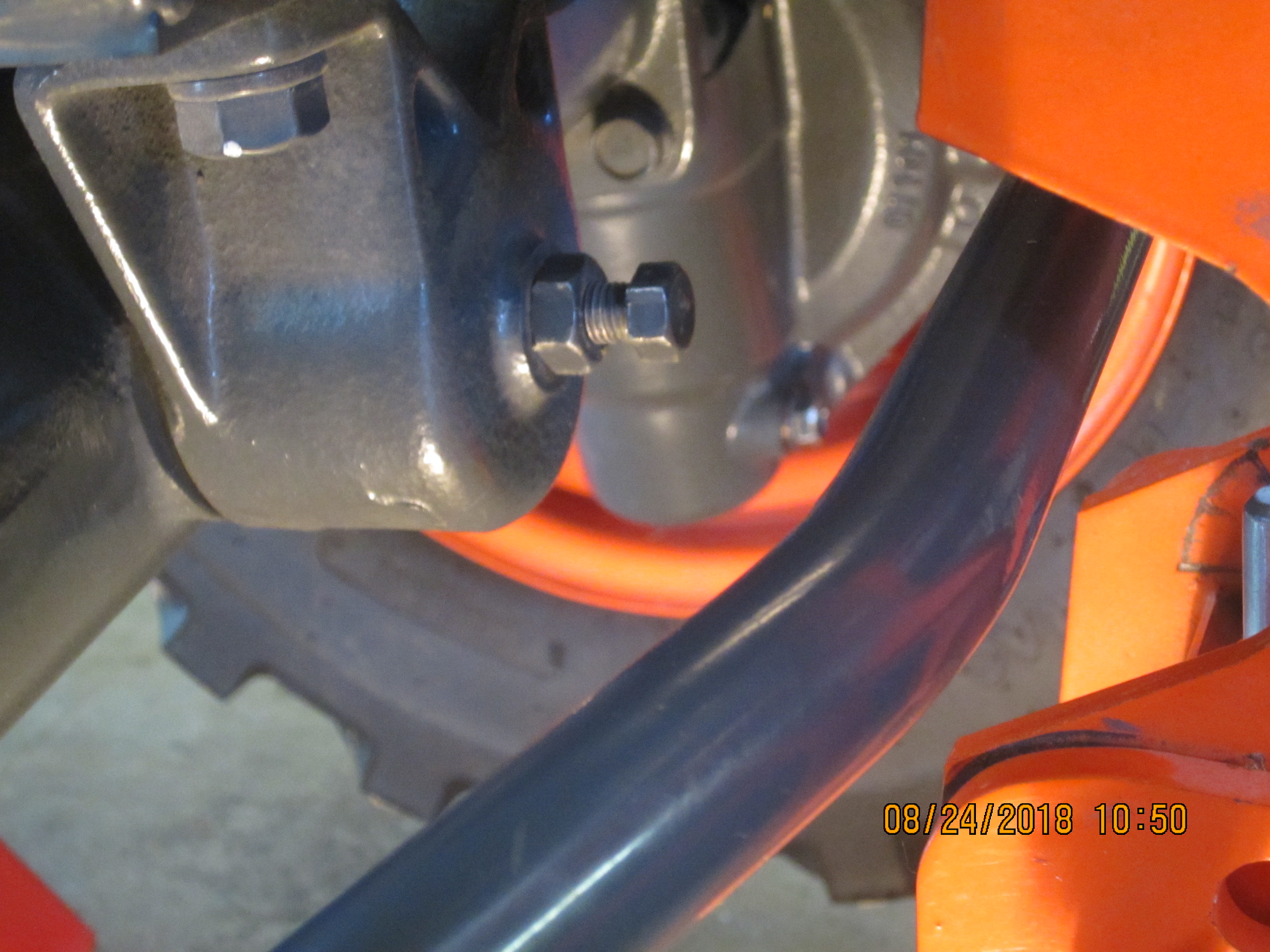

Hi TBN'ers
I am doing some more B2620 maintenance. According to the OE manual the Front Axle Pivot screw is suppose to be 11.2 - 22.5 ft lbs..."oscillating load"...whatever that is?? At 600 hours the adjusting screw took several turns to get at approx 16 ft lbs with my Torque Wrench. The tractor was sitting flat on the concrete.
I do not want to get that screw too tight, but rather adjust it per the manual. What is your experience?

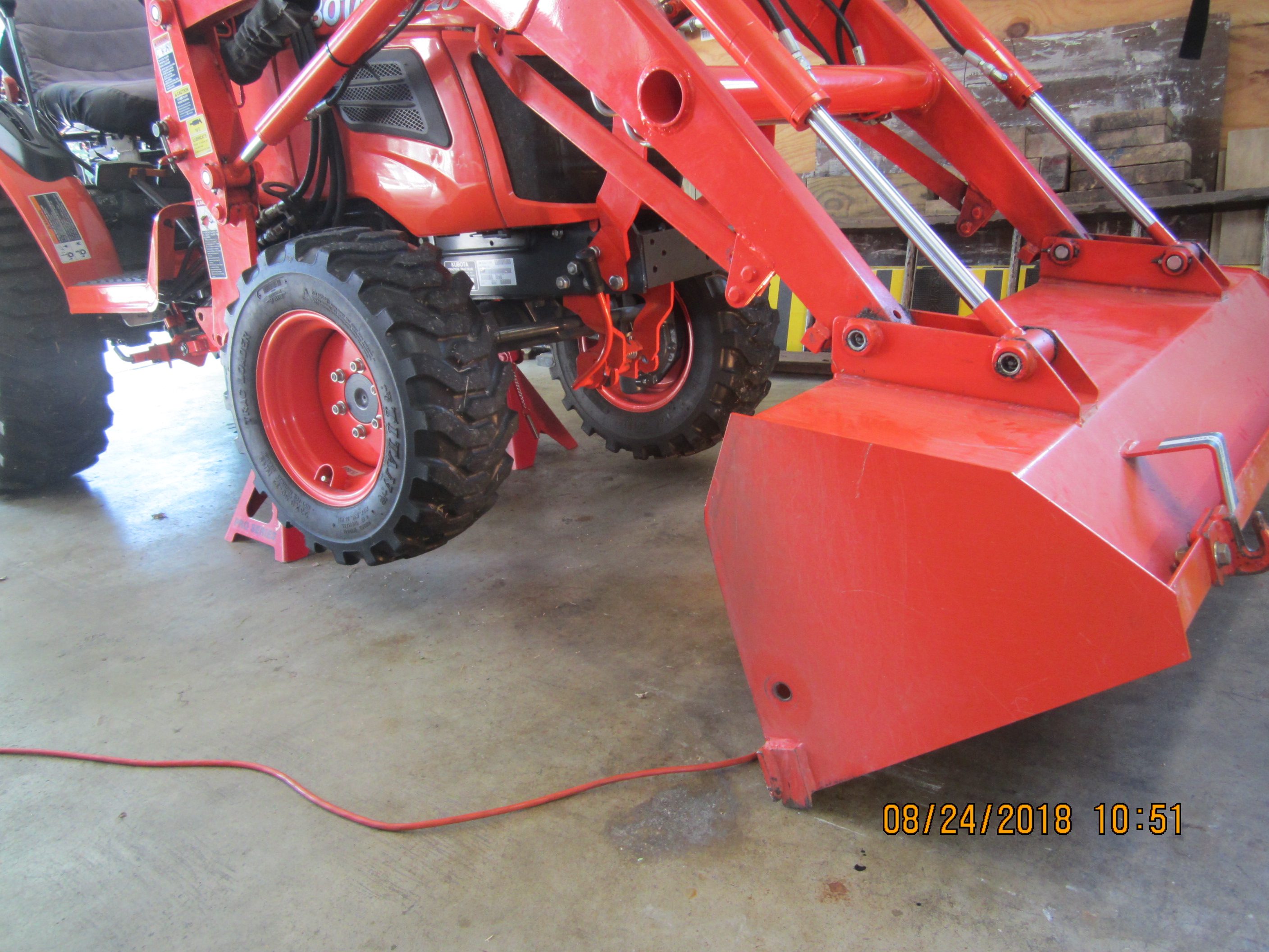

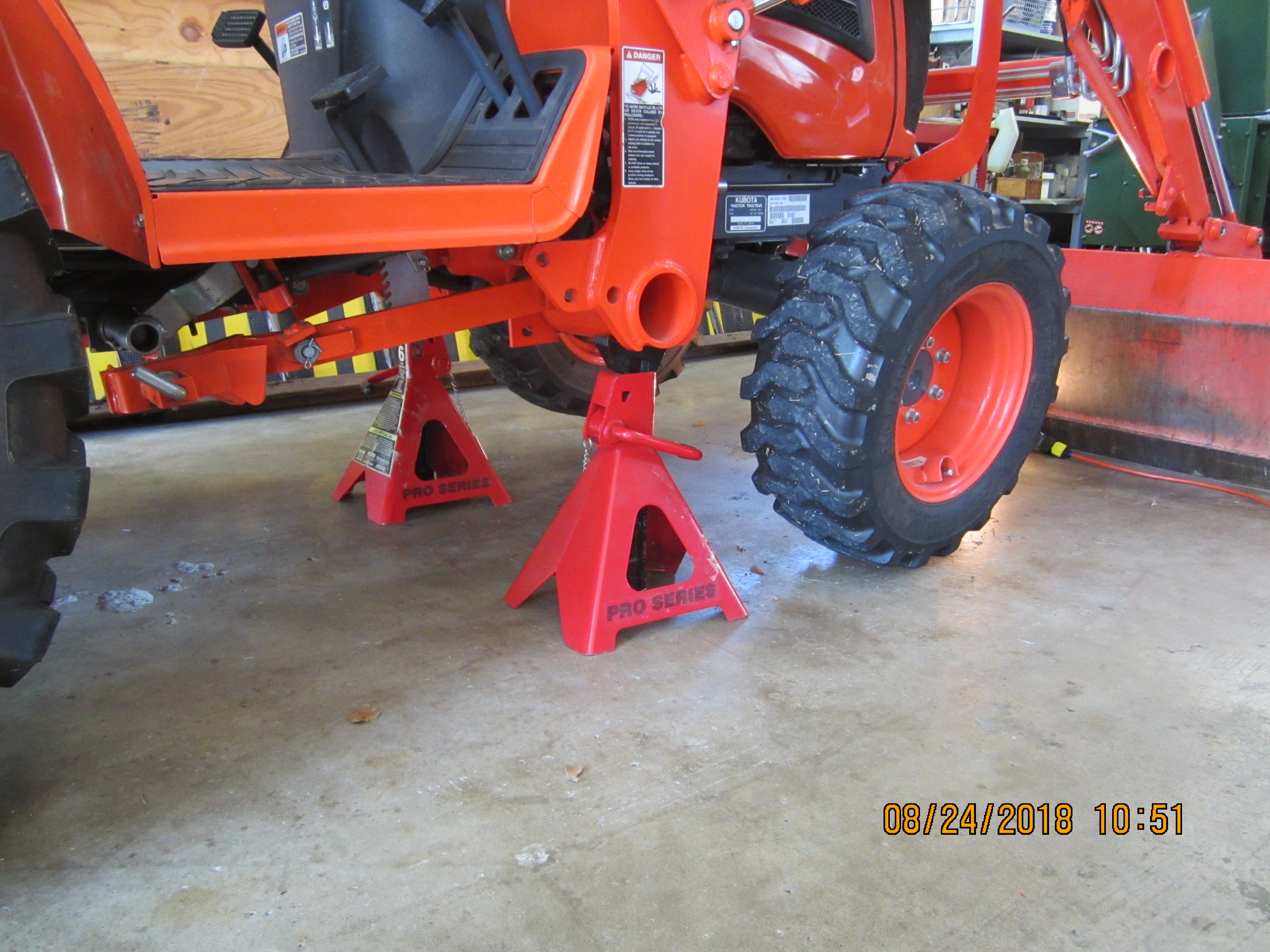

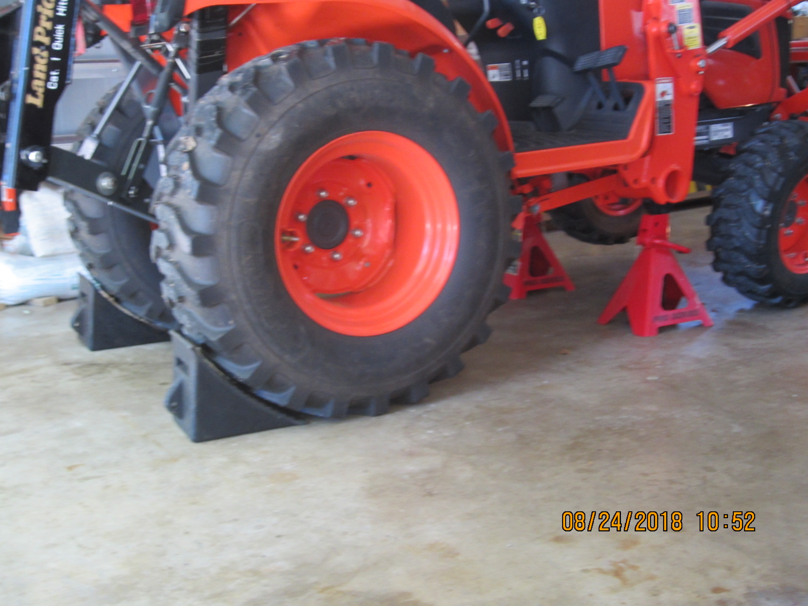

Gents,
In appreciation of your help, here are some pics for others that might be interested. BTW, It was a good thing that I went thru this procedure, because my first understanding of the torque on the adjusting bolt had the axle locked up tight.:eek:
I used the by guess and by gosh method, since I had no "spring balance". I tightened the adjusting bolt till the axle would not budge, then loosed it up to what I figure was enough.....certainly better than my previous faux pas.
