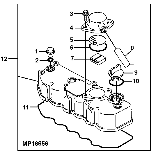

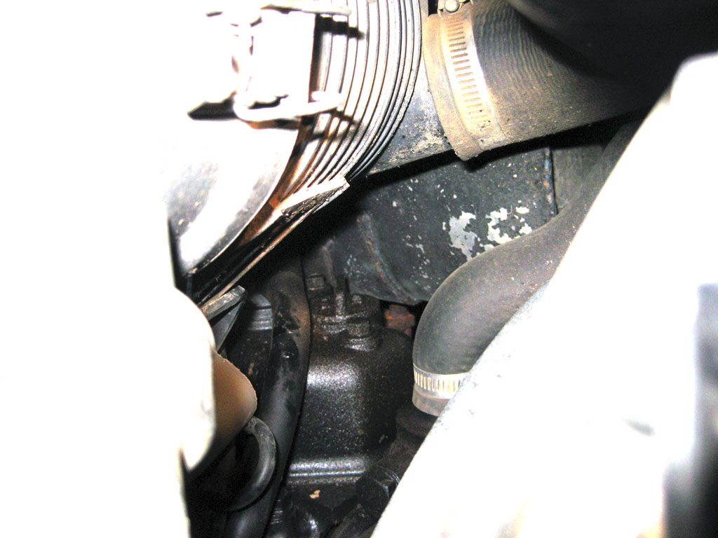

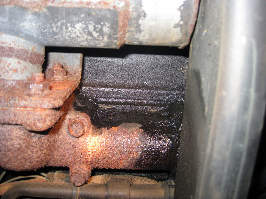

BUT, since you ask, the hose (#8) to the left of B goes to the top of the engine to some kind of breather cap (#4) or something. I attached a parts breakdown. That hose is also not pinched, but something there (or somewhere) is leaking like a sieve. I just noticed that today. I attached some pictures of the leak. Any ideas where thats coming from? Wish I could get a better picture but the entire valve cover, top to bottom, is covered in oil. And you can see where its leaking to.
Either the breather tube is leaking (#8 in your drawing), or your fuel overflow tube
is allowing diesel spillage to land on the valve cover. Your leak looks chronic, so
I lean toward the former.
Maybe you can remove the muffler to see in there, and do a valve
adjustment while you are in there. The muffler is easy to remove.

if it was your valve cover leaking, you would not see oil on top of the cover.
Thats what I thought too. Still, why would oil be coming out of an air breather either? I guess there is a "baffle" in the breather that could deteriorate according the to tech manual. Maybe mine is deteriorated?
I'm gonna order the o-rings and gaskets tomorrow. Hopefully they come in on Tuesday then. Might as well do the valve cover o-ring too. And yeah, I'm happy to see thats an o-ring. I like how newer vehicles are going away from the gaskets. I've had to RTV the ones on my older Fords since they apparently don't make cork gaskets that don't leak.
Oil can come out of the breather onto your cover if the hose is cracked
and either/or:
> the separator/filter in the cover is not doing its job
> the rings are worn and causing excessive blow-by
> there is too much engine oil in the sump

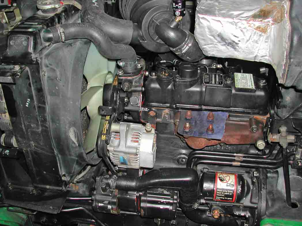

> the drain-back holes in the head are clogged with sludge
Let's hope your rings are OK.
I had no problem removing my exhaust manifold studs and bolts. I
needed to remove them from the head to have the head hot tanked. You
don't need to remove the manifold at all for what you plan, but if you do,
the steel gasket is reusable. Just take the muffler off the manifold.
This photo is before I put the tank back in, but you can get a clear
view. If you cover the muffler hole like in the photo, you can wash
everything before you remove the valve cover.
