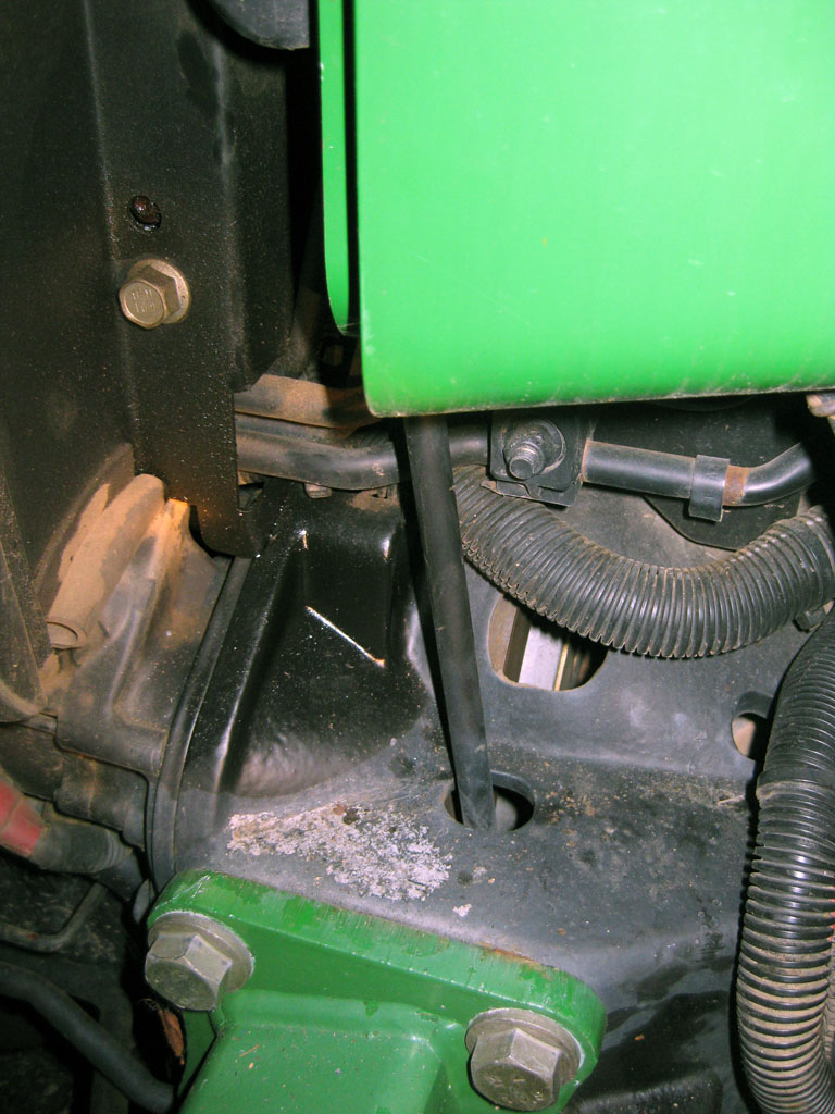

A) I went out and looked in the garage.... it came with the Front Hitch Kit BM19575. Its part J (Hose Guide) of the kit but doesn't have a Deere part number. I can't find it in JDParts either. Its supposed to be for routing the front implement hoses. But yeah, I use it to route the FEL hoses too.
B) The hose you're pointing to runs to the side of the air intake hose. The air hose is not pinched in the slightest.

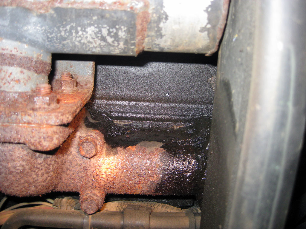

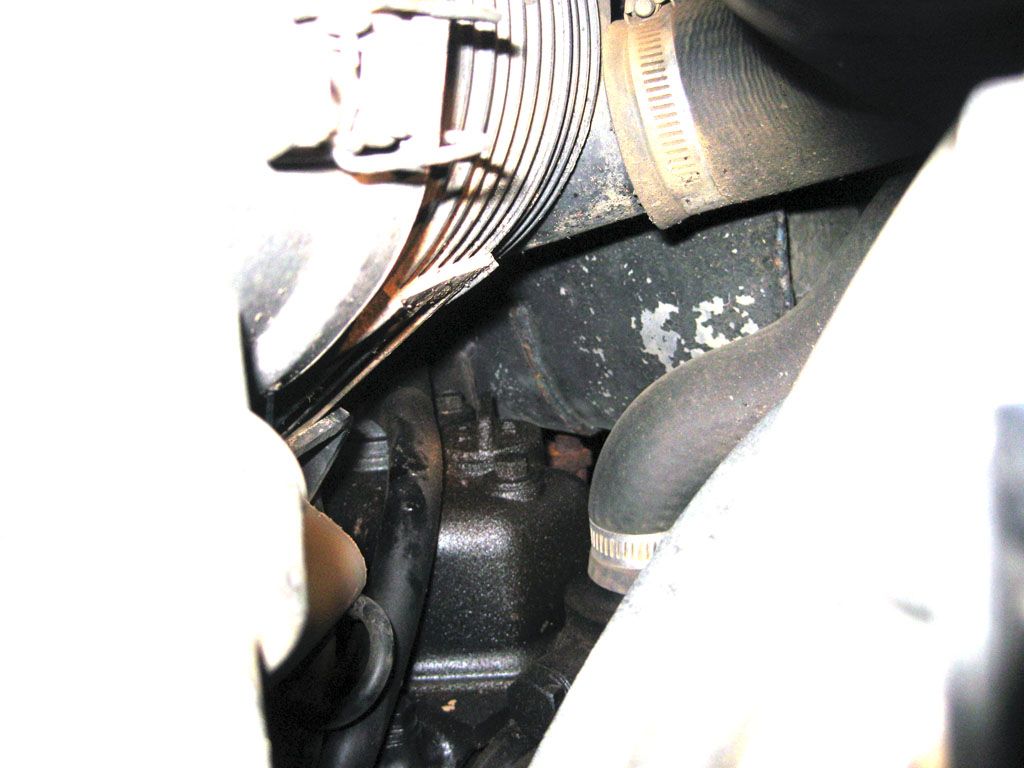

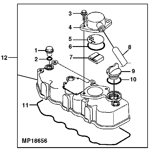

BUT, since you ask, the hose (#8) to the left of B goes to the top of the engine to some kind of breather cap (#4) or something. I attached a parts breakdown. That hose is also not pinched, but something there (or somewhere) is leaking like a sieve. I just noticed that today. I attached some pictures of the leak. Any ideas where thats coming from? Wish I could get a better picture but the entire valve cover, top to bottom, is covered in oil. And you can see where its leaking to.
Either the breather tube is leaking (#8 in your drawing), or your fuel overflow tube
is allowing diesel spillage to land on the valve cover. Your leak looks chronic, so
I lean toward the former.
Maybe you can remove the muffler to see in there, and do a valve
adjustment while you are in there. The muffler is easy to remove.

It isn't diesel spillage no matter how much I'd like that to be the answer. :)

BTW, if it was your valve cover leaking, you would not see oil on top
of the cover. That gasket is a rubber ring and works well.

if it was your valve cover leaking, you would not see oil on top of the cover.
Thats what I thought too. Still, why would oil be coming out of an air breather either? I guess there is a "baffle" in the breather that could deteriorate according the to tech manual. Maybe mine is deteriorated?
I'm gonna order the o-rings and gaskets tomorrow. Hopefully they come in on Tuesday then. Might as well do the valve cover o-ring too. And yeah, I'm happy to see thats an o-ring. I like how newer vehicles are going away from the gaskets. I've had to RTV the ones on my older Fords since they apparently don't make cork gaskets that don't leak.
