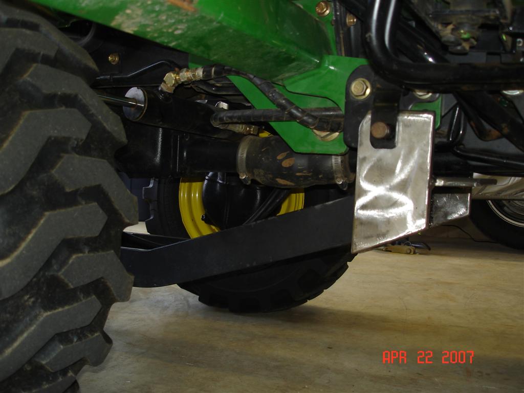

Jun 11, 2008 / Front Blade Experiences #21 Gizmo2 Veteran Member Joined Jul 7, 2006 Messages 1,902 Location New York Tractor JD 2320 3RRL, No, a belly piece that would go under the tractor with the back supported by the hangers for the backhoe, two pins. The backhoe hangers clamp onto the load supports.

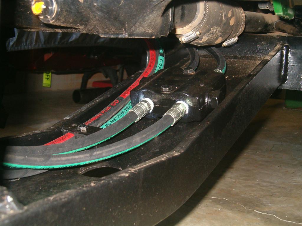

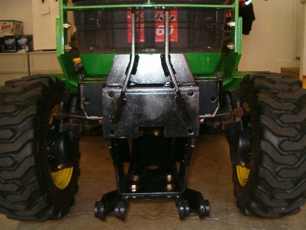

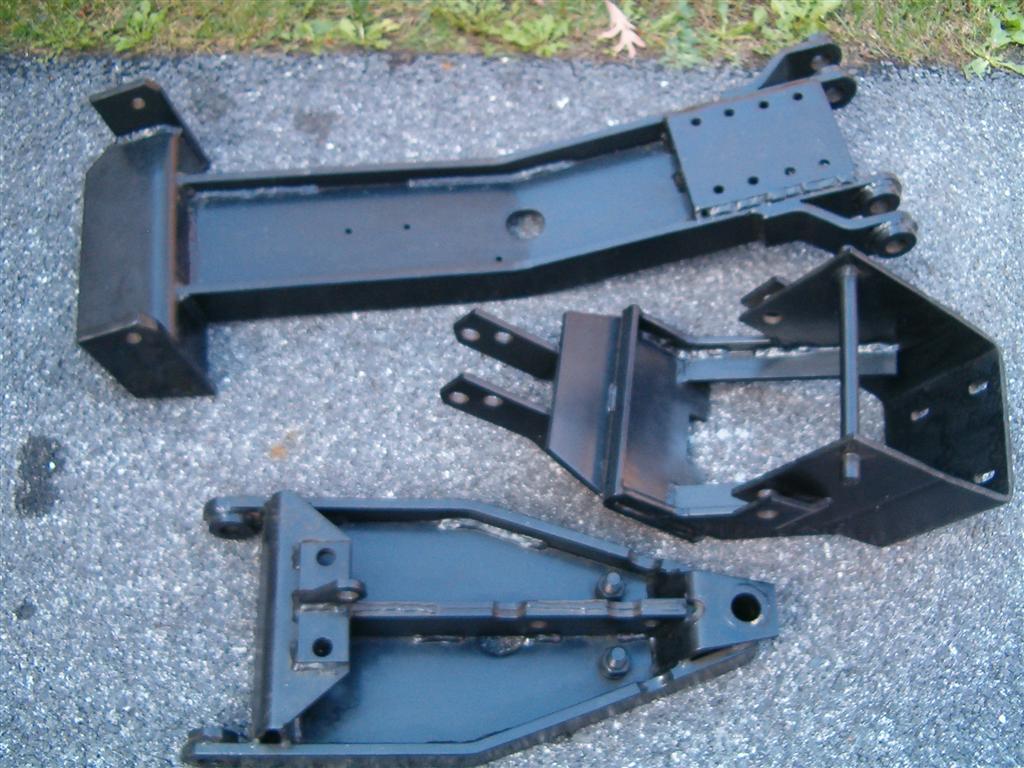

Jun 11, 2008 / Front Blade Experiences #22 kennyd Advertiser Joined Jul 6, 2003 Messages 13,837 Location Westminster, MD Tractor John Deere 3720 CAB/TLB, JD455 Giz, I found some pictures from my 380 blade install, hope this helps... Attachments HPIM7114 (Large).JPG 125.6 KB · Views: 181 HPIM7110 (Large).JPG 141.5 KB · Views: 149 HPIM7112 (Large).JPG 101.1 KB · Views: 167 HPIM7175 (Large).JPG 114.1 KB · Views: 177
Jun 11, 2008 / Front Blade Experiences #23 Gizmo2 Veteran Member Joined Jul 7, 2006 Messages 1,902 Location New York Tractor JD 2320 KennyD, Yes it does. Second picture, top piece, how and where does the back mount on the tractor. Mower brackets that hang down from the frame? Thanks

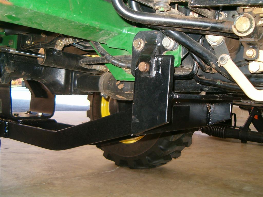

Jun 11, 2008 / Front Blade Experiences #24 kennyd Advertiser Joined Jul 6, 2003 Messages 13,837 Location Westminster, MD Tractor John Deere 3720 CAB/TLB, JD455 Gizmo2 said: KennyD, Yes it does. Second picture, top piece, how and where does the back mount on the tractor. Mower brackets that hang down from the frame? Thanks Click to expand... Yes, the MMM bracket can be seen in the first picture, here is another that may help... Attachments DSC03045 (Large).JPG 87 KB · Views: 36,372
Jun 12, 2008 / Front Blade Experiences #25 Gizmo2 Veteran Member Joined Jul 7, 2006 Messages 1,902 Location New York Tractor JD 2320 KennyD, DUH!, some reason I could not see it in the first picture. I see it now, thanks. I'm getting old I guess.
