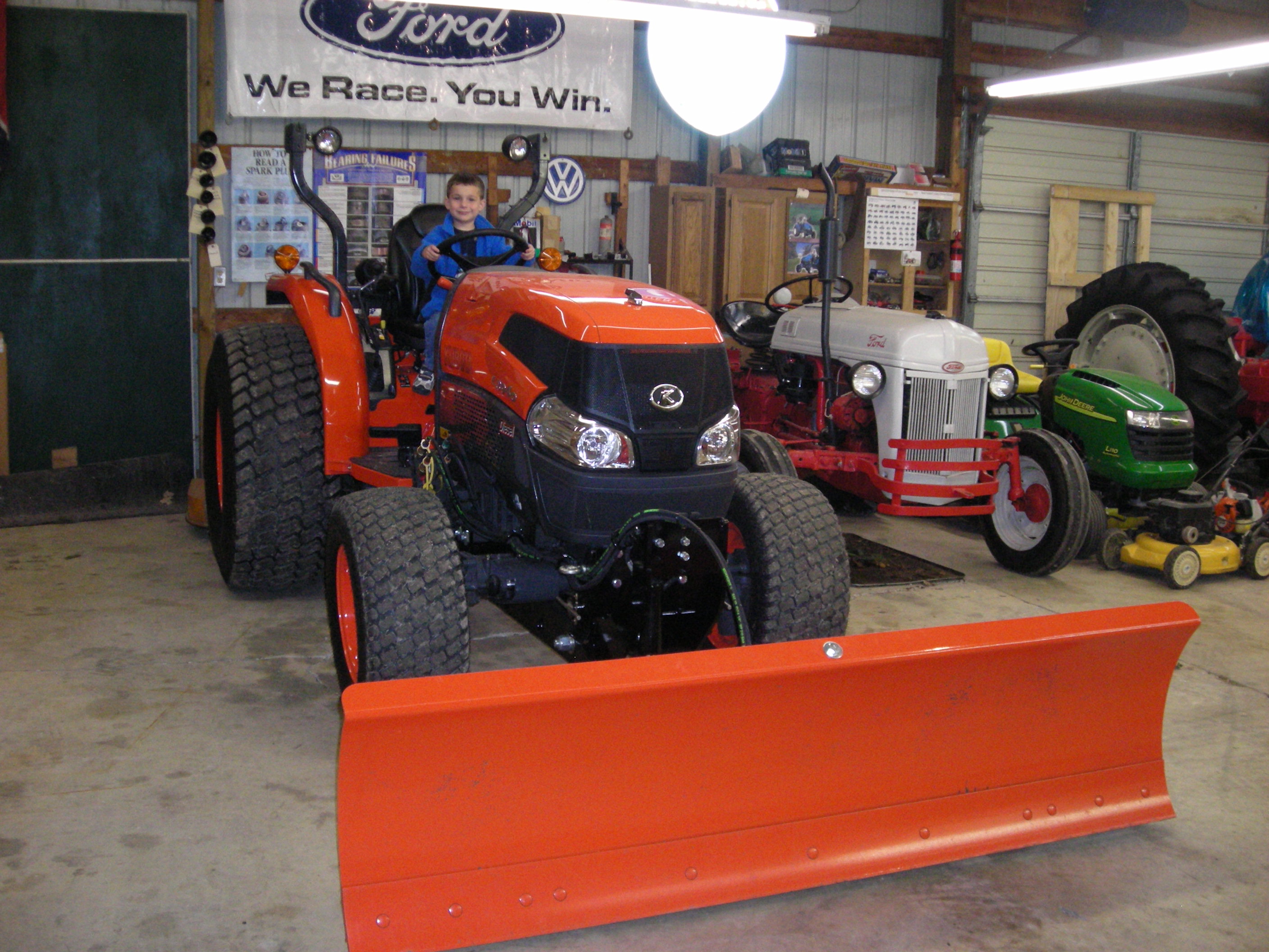

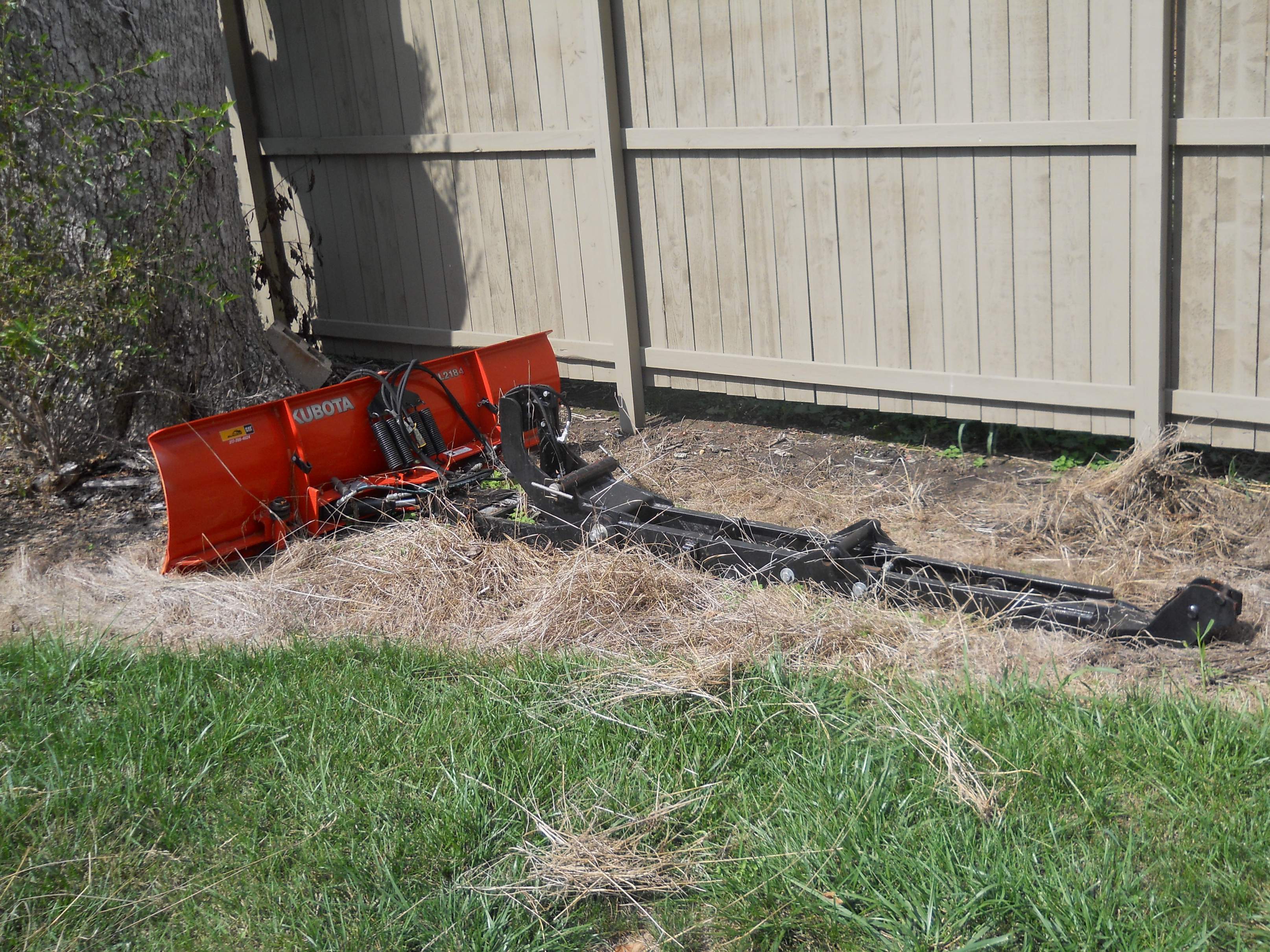

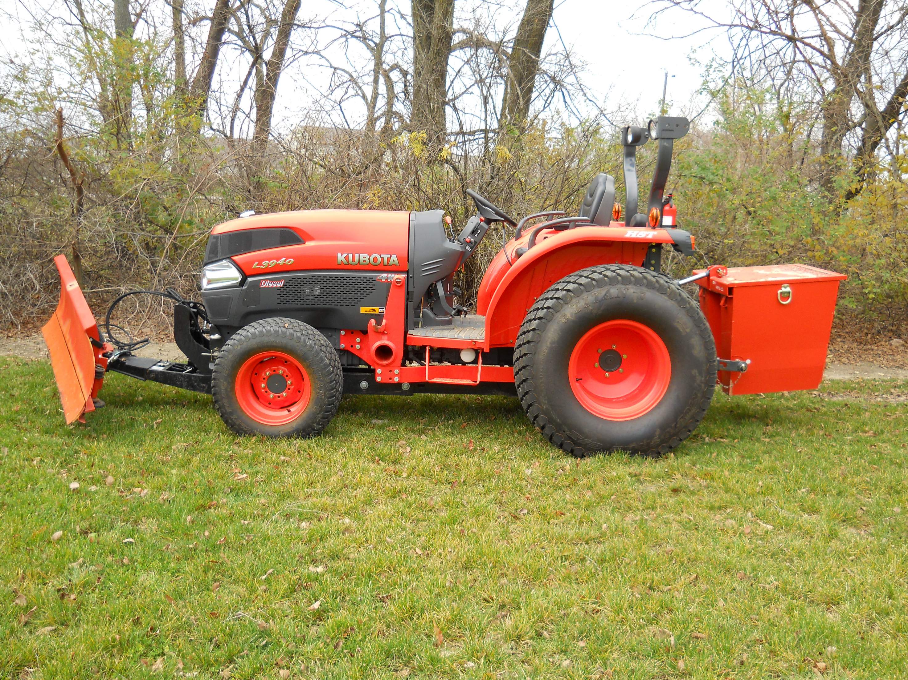

/ Front Blade #13
This is my set up, cannot imagine anything working better front blade wise. Probably more expensive, takes longer to mount/dismount, and takes up more room to store, but you will not be disappointed with performance or stength. Philip.

/ Front Blade #14
Just a little more info. I welded ears on the quick-tach plate to attach the blade so the blade floats independent of the loader just as it would on a truck mount. For the hydraulics I ran hoses from my rear remotes for the blade so I still have full use of the loader for adjusting angle of attack if needed for hard packed snow.
