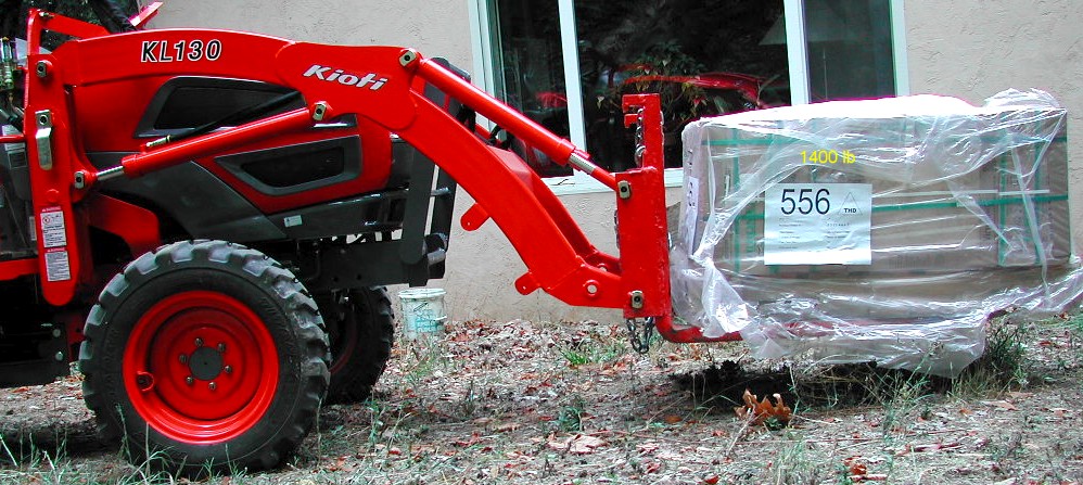

When I built this fork frame, I decided not to use the KL130's bucket links.
This limited the amount of curl angle I could get and the dump angle is less
than ideal at high boom positions. If I did it over again, I would use the
links.
Photo shows my max lift, 1400 lb of ceramic tile on a pallet, plus the 180
lb of the fork frame. I could only lift ablut 4' high.

Thats a very interesting pic dfkrug, if that k130 loader is only rated at 1155lbs to max height, and your lifting 1500-1600 lbs to 4 ft, perhaps that loader is more capable then previously thought. I hear alot of arguements from another brand dealer here and from what he states thats not possible. That load you have there must extend close to 4 feet out from your pivot point...
/ front bucket removal #7
I believe the 1155# number. At max height, the KL130 generates much
less leverage around the boom pivot point. I have maxed out the lift
of my loader numerous times....this time I could easily determine the weight
of my load. The load in the photo is only an inch or so higher than my
PU bed and I could not go higher.

So if you raise a pallet to dock height and then get out and load that pallet with weight such as tiles. Will the loader sink after you reach a certain weight? I understand and have experienced the max lift ability but what about the other way? Can you overload the loader that way?
/ front bucket removal #11
You certainly can overload it that way, but there is no relief valve in the
work ports of the FEL valve, so overloading manually will manifest itself
by bending something, tipping the tractor, blowing a seal in a cylinder, or
bursting a hose. You will get more fluid flow past the spool in the FEL
valve, too, but that is unlikely to suddenly increase. The added weight on
the loader will cause it to sink down a bit faster, but that is not a "failure".
In my photo, I will bet that I could manually add at least a thousand more
pounds to this load before any type of catastrophic failure, but I am not
going to try it. Honestly, I do not know what would give out first. My loader
on this Kioti is still very tight in terms of internal hyd leaks in the valve
or cyls, as evidenced by how many days it will stay up before sinking from its
own weight.
