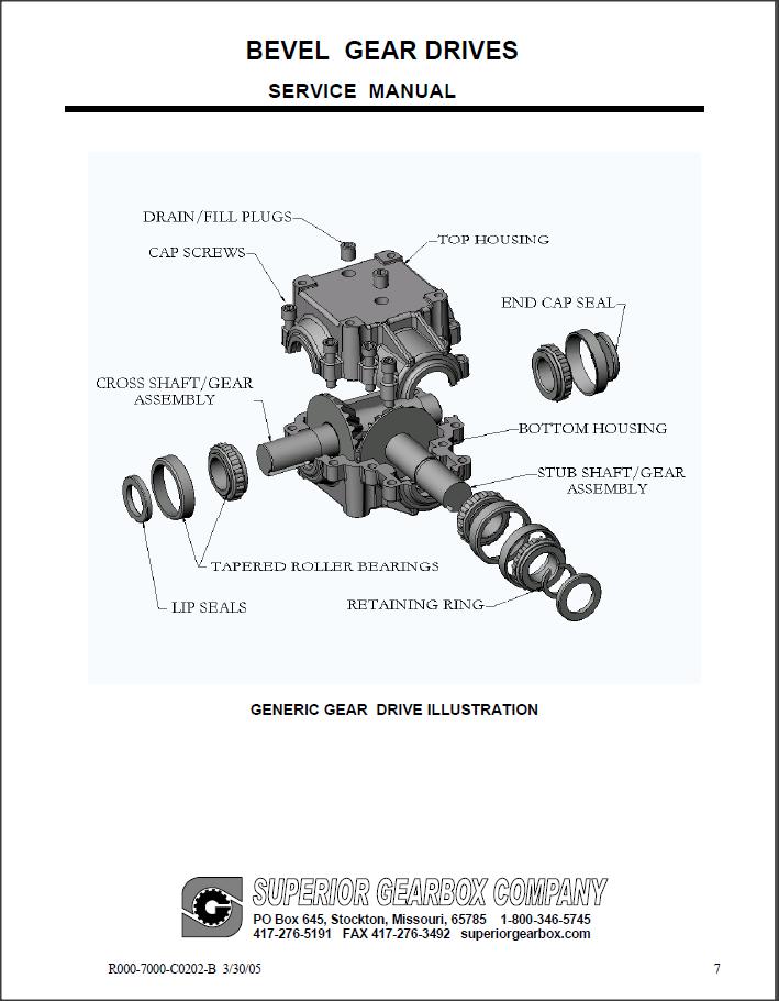

Your F3080 deck gearbox may be different but the gearbox in F3060 (deck RC72R-F30 ) is US made and easy to overhaul 90 degree design.
It has standard off the shelve bearings and shaft oil seals.
I am sure rebuild shop can spend two hours rebuilding it if doing it for the first time.
