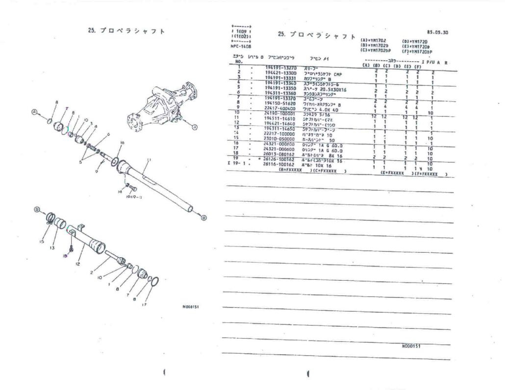

I appreciate the feedback. I'll give it a try if I can find a Yanmar dealer willing to order parts for a "gray market" model. I guess I'm not obligated to say that it is for a 1720D. The discussion on Yanmar's position statement and my own recent experience tells me I can expect a cold shoulder from the JD dealers in my area who supply Yanmar parts if they know it is a gray market tractor.
   / front driveshaft protection? #22
Pete, the numbers that you give are for a YM226D. The YM1720D has a different number and they are not listed in the Yanmar data base. The O-rings and the boot are the same. You might be able to modify the YM226D cover to make it fit the YM1720D. The cost of the parts are about $165.00 from Yanmar. I think that I would try to find a parts tractor YM1601D,1610D, 1702D, 1802D,2002D, and buy a used one. There are other models that fit also.
Danny
   / front driveshaft protection? #23
Alright, it seems that I was mistaken then on those PN, I was under the impression that the whole driveline was the same, sorry for the confusion
Pete
   / front driveshaft protection? #24
YM1720D front driveshaft parts
194311-14650 center boot
194511-14610 front cover
194421-14640 rear cover
24321-000600 front and rear o-rings
194191-13370 not sure what these are, looks like they fit inside the front and rear covers?
I have attached an image of the page from the parts manual. If it's too small, let me know and I'll e-mail you a copy.
   / front driveshaft protection? #25
194191-13370 is a rubber boot. 194511-14610 & 194421-14640 are not available from Yanmar USA.
Danny
