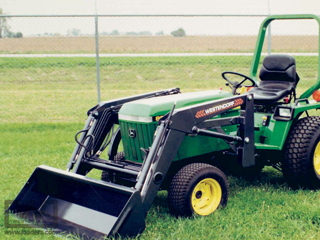

I'm pretty sure the 755 takes a Model 70 loader, same as what's on my 790 now. However, you cannot purchase a new Model 70 loader from JD because they don't offer them anymore. If you really want one, you have to get a used one (very hard to find), or you'll have to get an aftermarket brand such as Bush Hog, Koyker, or Westendorf. I know the Westendorf is Quick Attach, and I think the Bush Hog brand is as well. Not sure about the Koyker though.

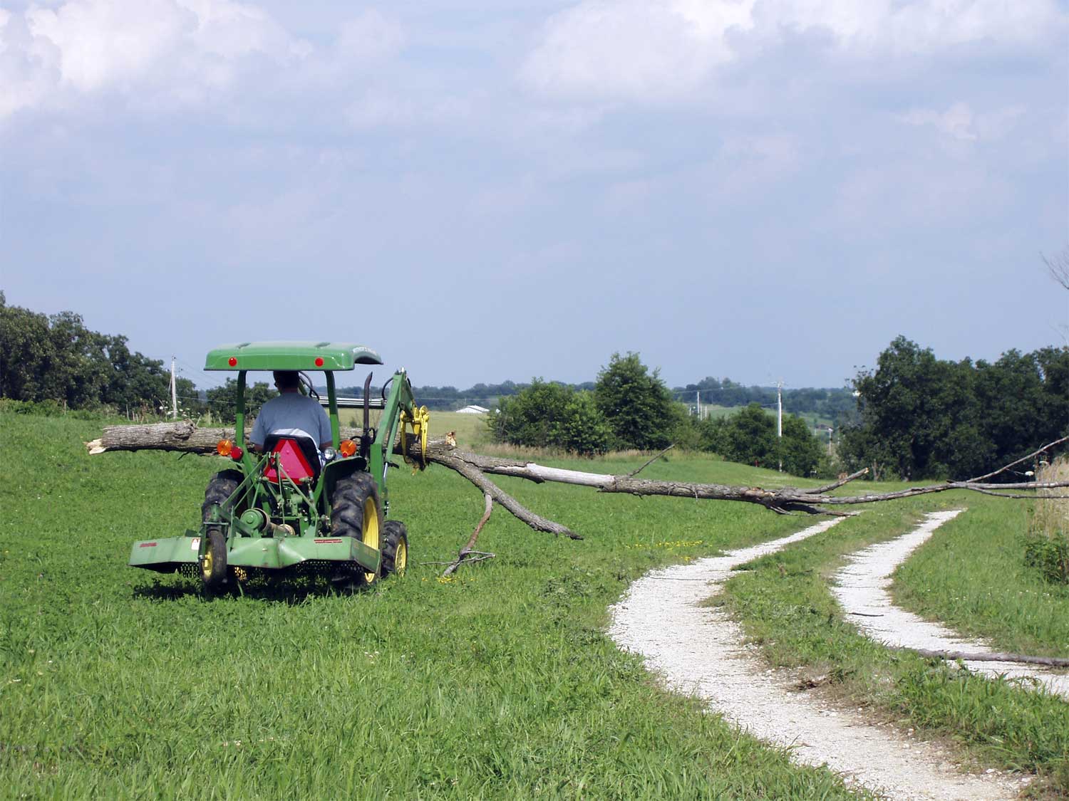

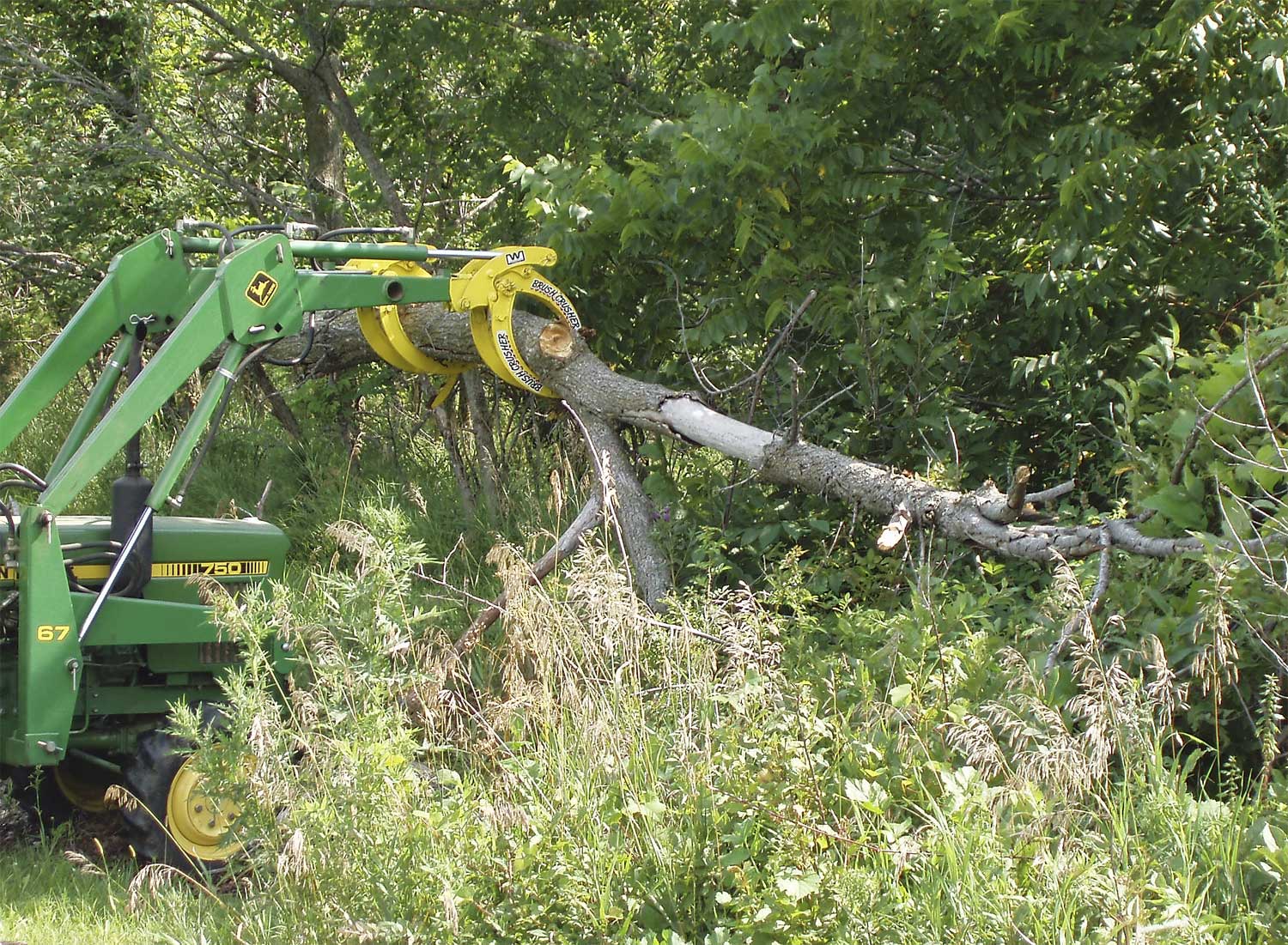

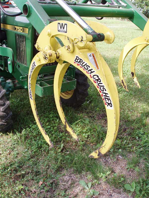

TA-55 is our fit for the JD 755. 700lb lift capacity at 7'2". Most smaller tractors like this do not have the hydraulics equipped to run the 4 in 1 and kebo makes a very good point that the bucket is typically much heavier and will affect lift capacity. I'd suggest getting the right tool for the job instead of doing all with one. If it's a grapple your looking for this little guy is a non-hyraulic solution that will save you from having to add 3rd function hyraulics. It attaches to the loader's bucket cylinder to open and close. Getting rid of the bucket increases lift capacity and moves the load closer to the pivot point for better stability.
