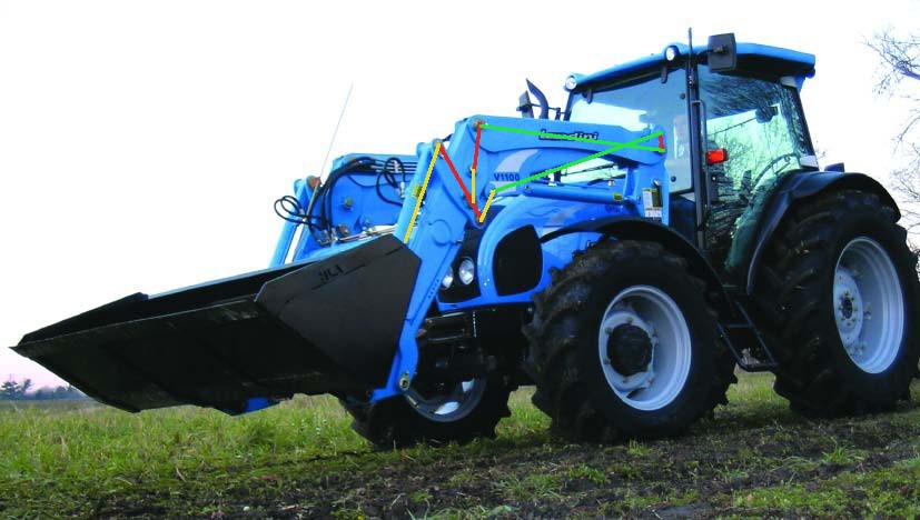

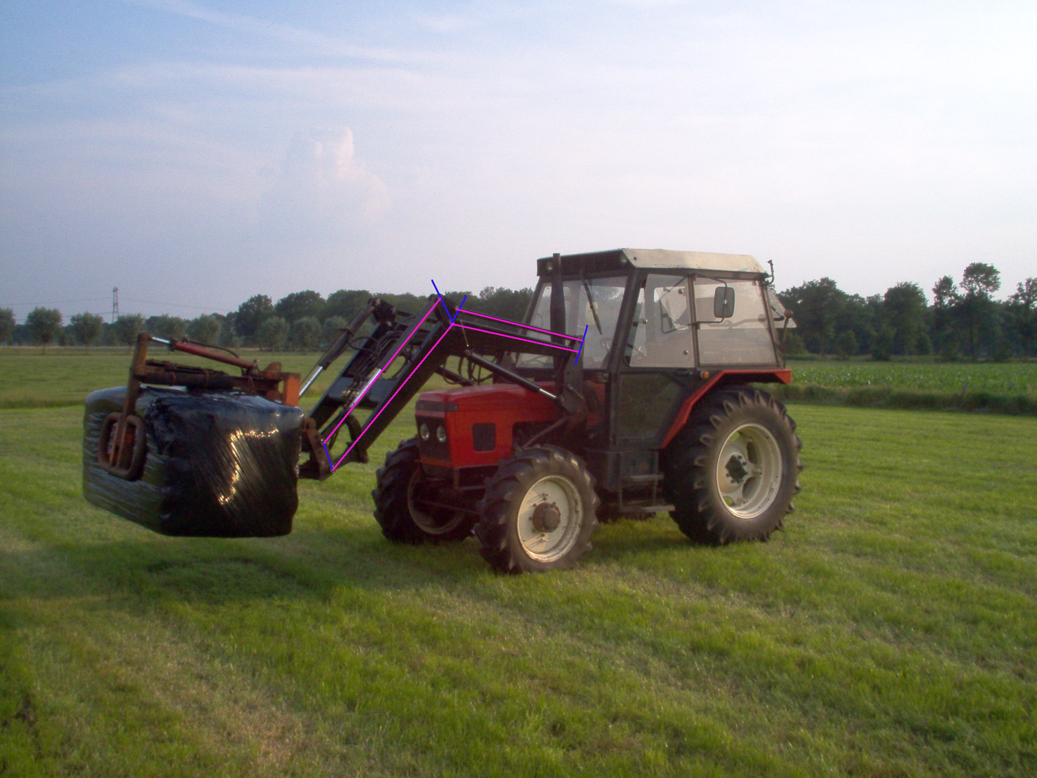

I found a picture of my loader, with the most basic (and most true) form of parallel linkage:
You can see the blue and purple lines i drew, connecting the linkage pins of the main boom and the parallel links.
i got lost in all the hydraulic mumble jumbo.
from the pic posted in that quoted post, (and from what ive seen in person) there is no way to bind a properly designed mechanical parallel arm system.
leave all the hydraulic bypass BS out of it. K.I.S.S.
