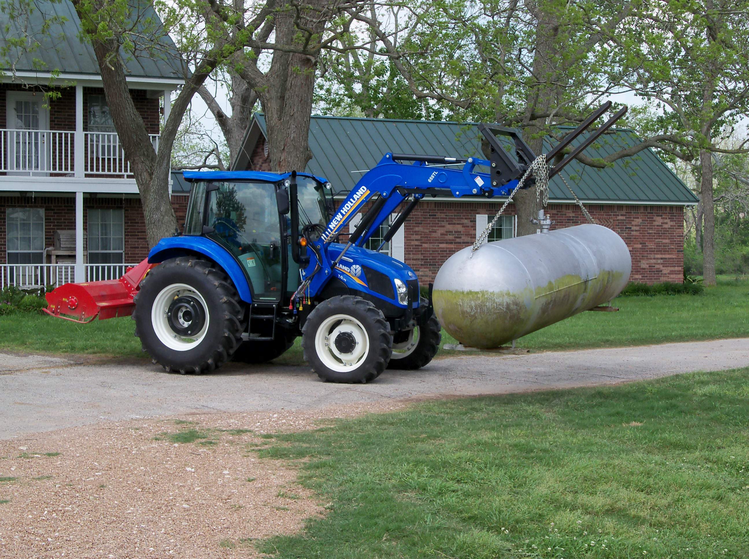

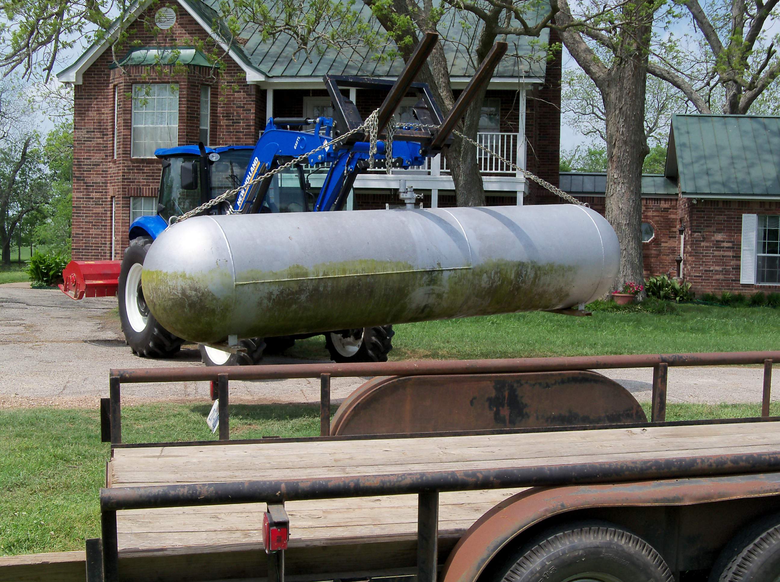

I had to move this 1,000 gallon tank this last year with my tractor as buildings and fences had been built around it over the years and there was no other way to get it over to and on the propane companies flat bed trailer. Decided to use the forks instead of the bucket and all went well though I did have to go up a small incline at a slight angle. Kept the tank close to the ground and had no problems and I went really slow.....

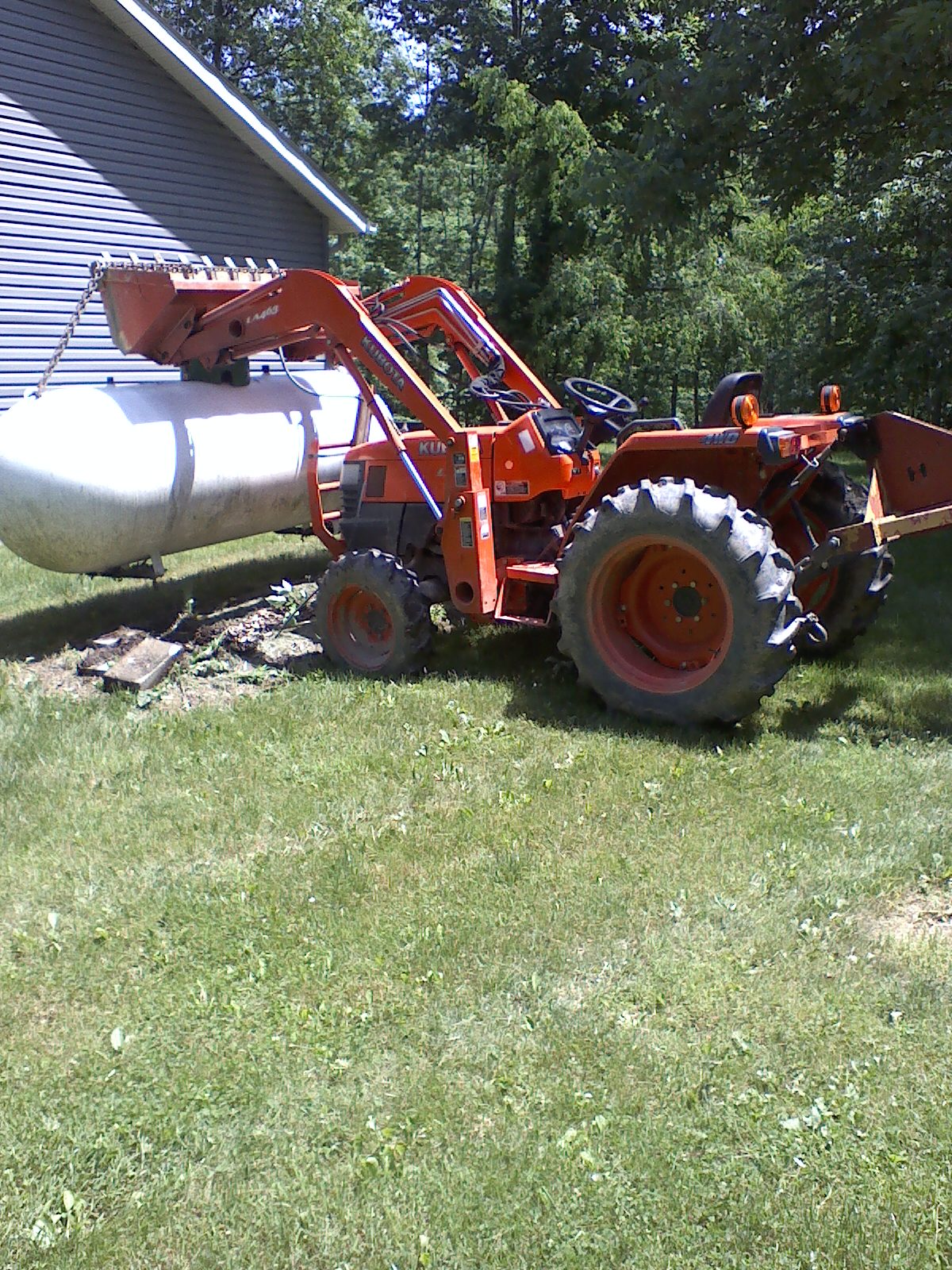

I had to move my 500 gallon tank just a few feet closer to the house so the copper line would reach. The standard 20' length of copper I bought was just a tad too short. The tank still had about 15% in it to. My best guess is 1400-1500# I wouldn't
The hooks are for empty only. With only 15% in the tank I wasnt worried. But wouldnt have dine it with any more in the tank.
