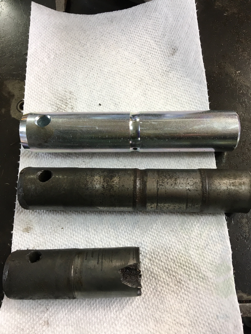

I had one pin break on my M59 loader. Considerable wear probably from lack of lubrication from previous owners.
Agree the pins are the designed economical weak link. Replaced 4 pins at the ssqa. Reduced some of the slop. The loader does have replaceable bushings. Haven’t tried replacing bushings yet. Have a few more pins to replace.

Think as the pins wears it flexes the pin more at the weakest point of the grease groove.

I believe the cost of the four pins was ~$44 total. A few dollars more for new zerks. That was all the inventory the dealer had at time for those pins. Easy to replace. Just few 0.01”s wear in several joints makes inches of play at the cutting edge of bucket or grapple.
Moly grease is recommended for loader pins.
