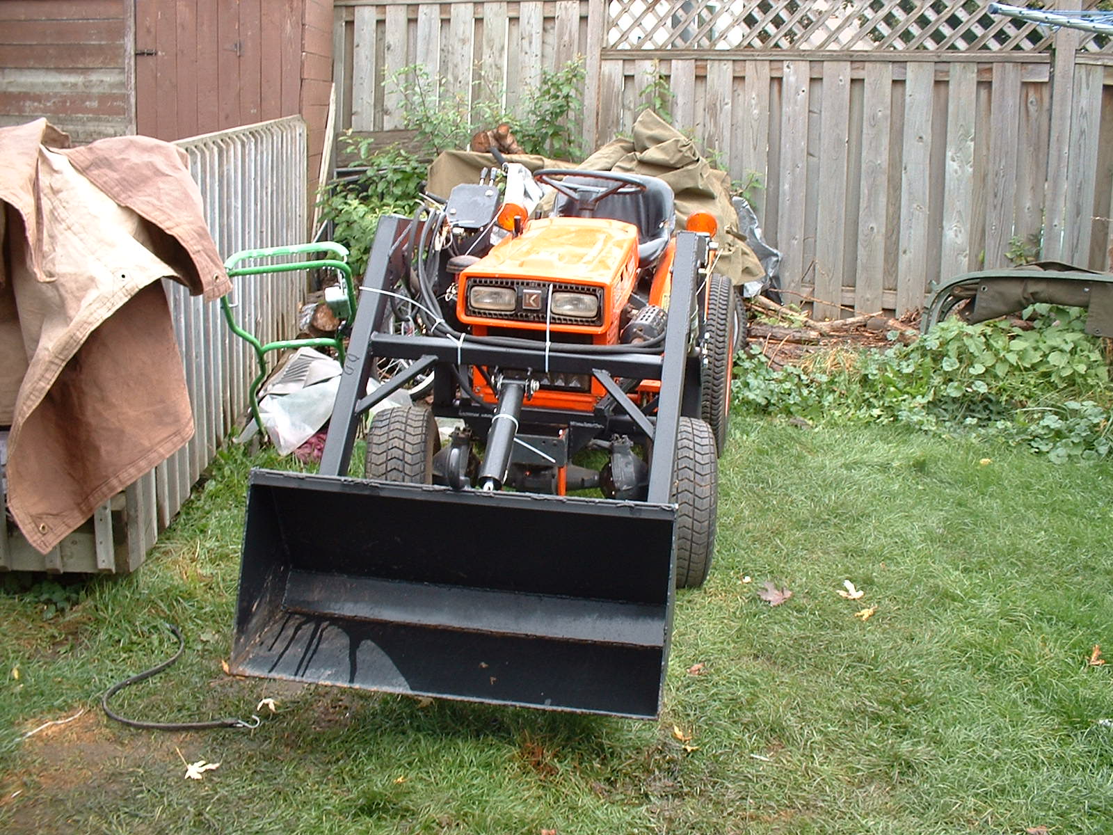

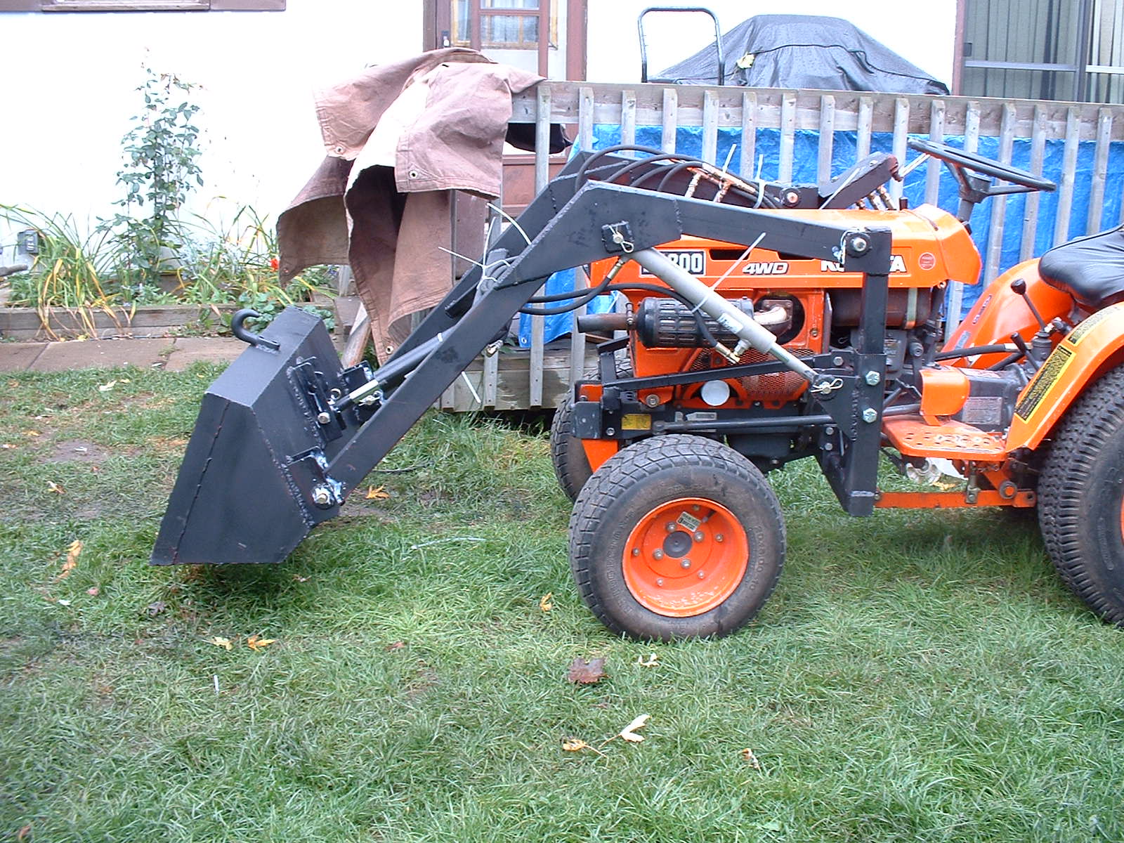

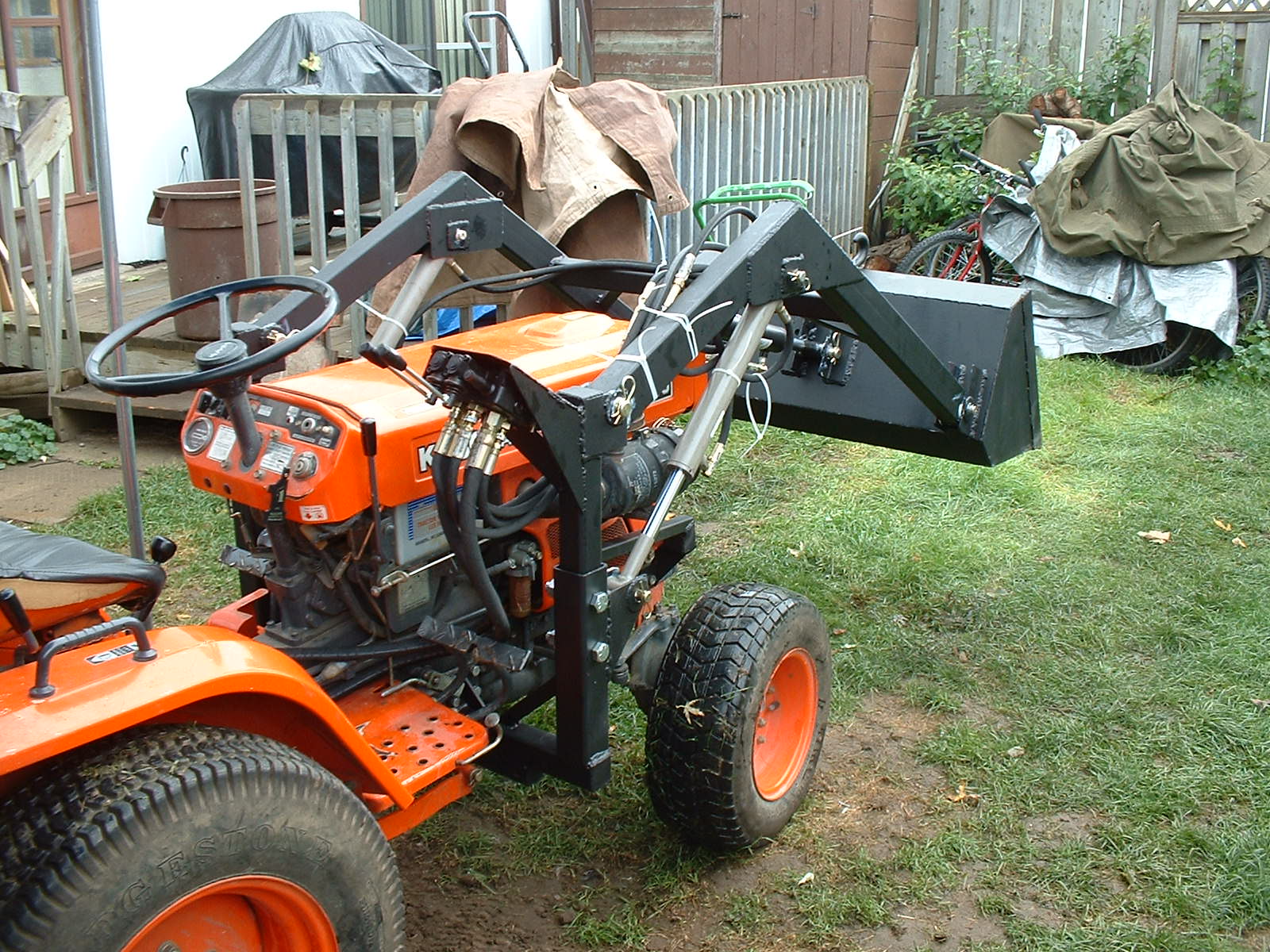

I scratch built one for my Kubota. Its a '3 cylinder' design and I loosely copied the loader off a BX22. Its served me well for 9 years now.

/ front end loader plans #4
David,
Do you have any other photo of the single front cylinder. I am still collecting parts for my loader build and I need to either purchase one or two more cylinders.
Also how has the single cylinder worked? If you did it again would you go with two?
Thanks
Bernie
/ front end loader plans #5
The only issue I have with the single bucket cylinder is that I did not make the cross brace beefy enough and have had to reinforce and reweld. A dual cylinder set up would not have created that.
