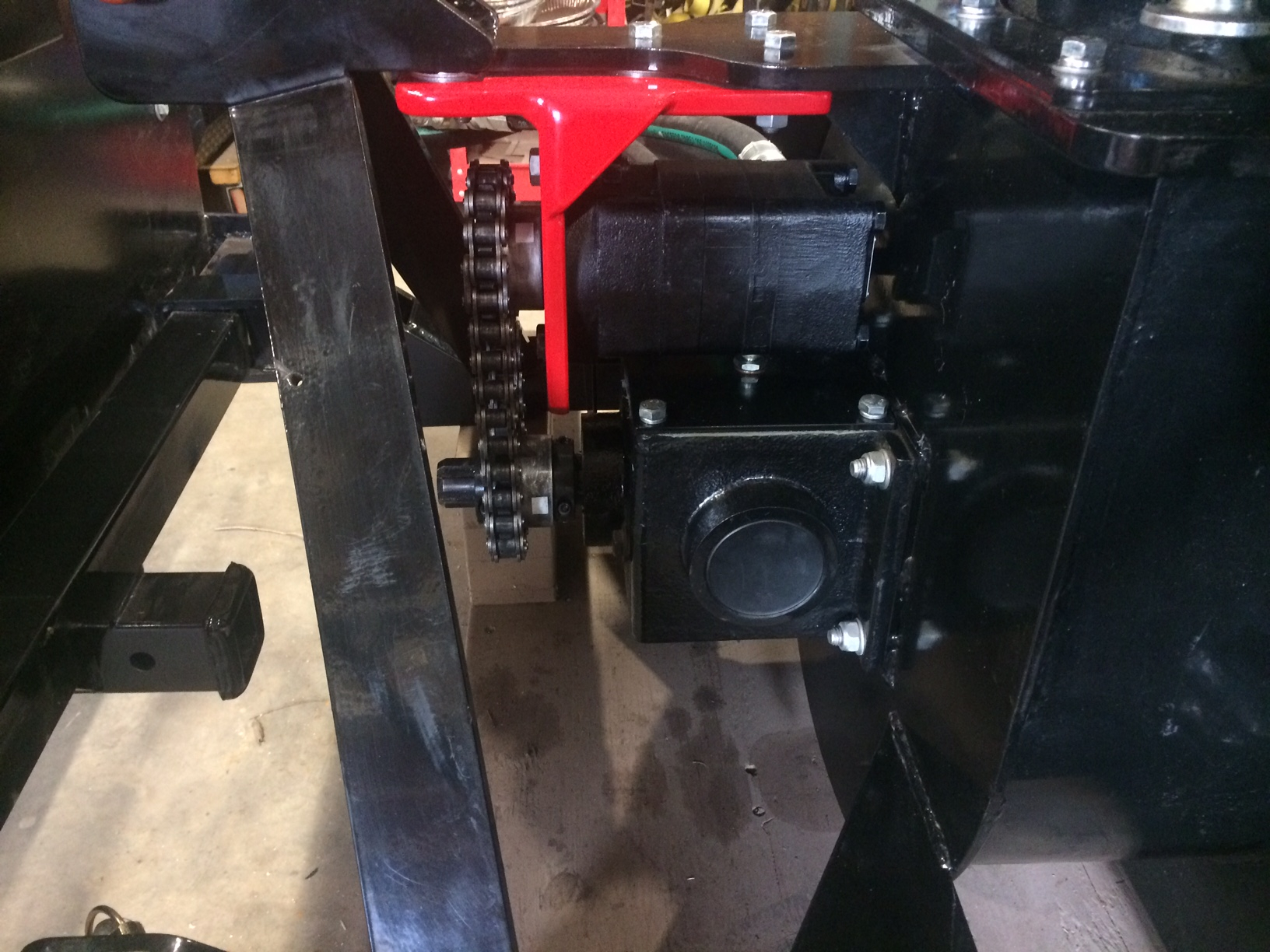

I could be my imagination or the camera angle but to me it looks like your sprockets aren't lined up. The bottom one is in more than the top one.
Lol...it must be the camera angle. I used a metal scale and made absolutely sure that the scale touched at all four points...perfectly.
Touching at top and bottom of upper sprocket and top and bottom of lower sprocket....that specific alignment area was VERY important to me.

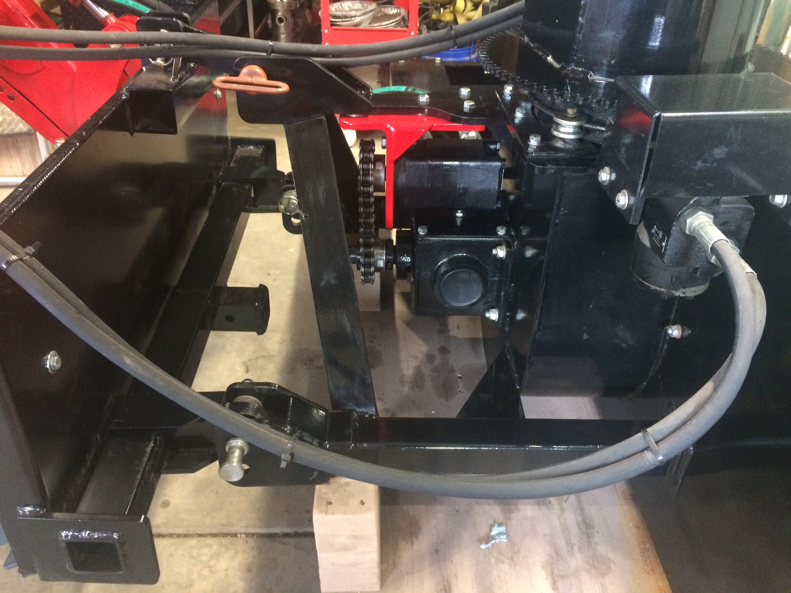

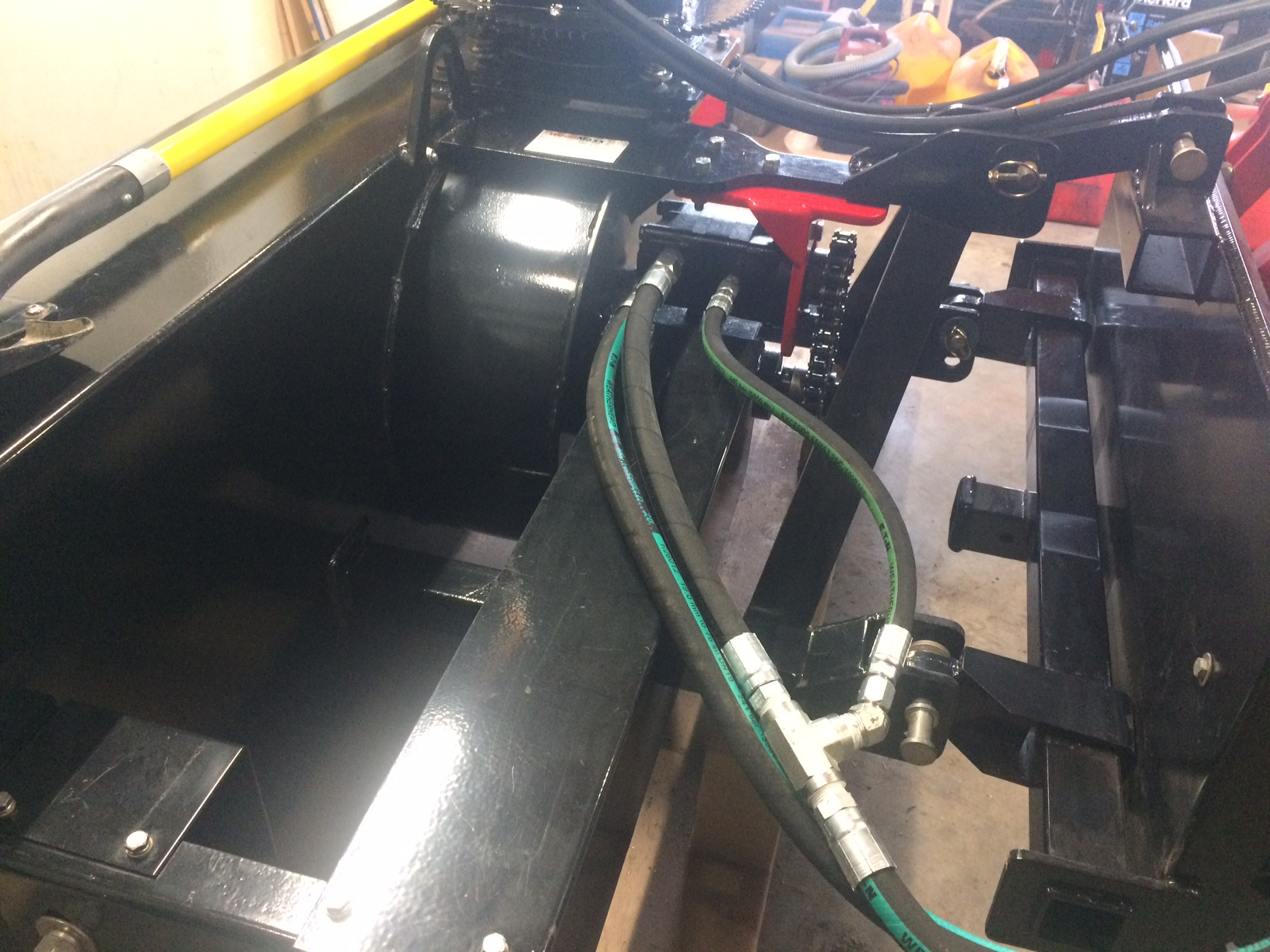

Thanks....
I cut a chunk out of the bottom...removed the bladder and the metal ring that holds it in place...then welded the piece back in place.
