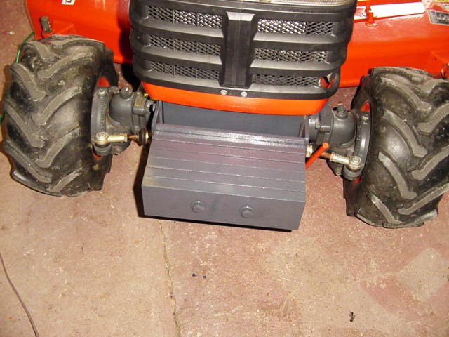

6-1" x 4" x 13" pieces of plate steel an 2-1/2" x 8" bolts, washers, an nuts equals 90 lbs. on the front of my BX1800 an I used 2 of the exisiting holes that are on the front of the frame from the factory.
I had this piece of steel laying around from a job a few years back
I plan on getting a woods 42" brush hog, an was just thinking ahead for when it is up an I am traveling.
did you use Kubota ROPS grey? or did you match the color? i just made weights for the front of my B2320. I still need to paint them and was curious.

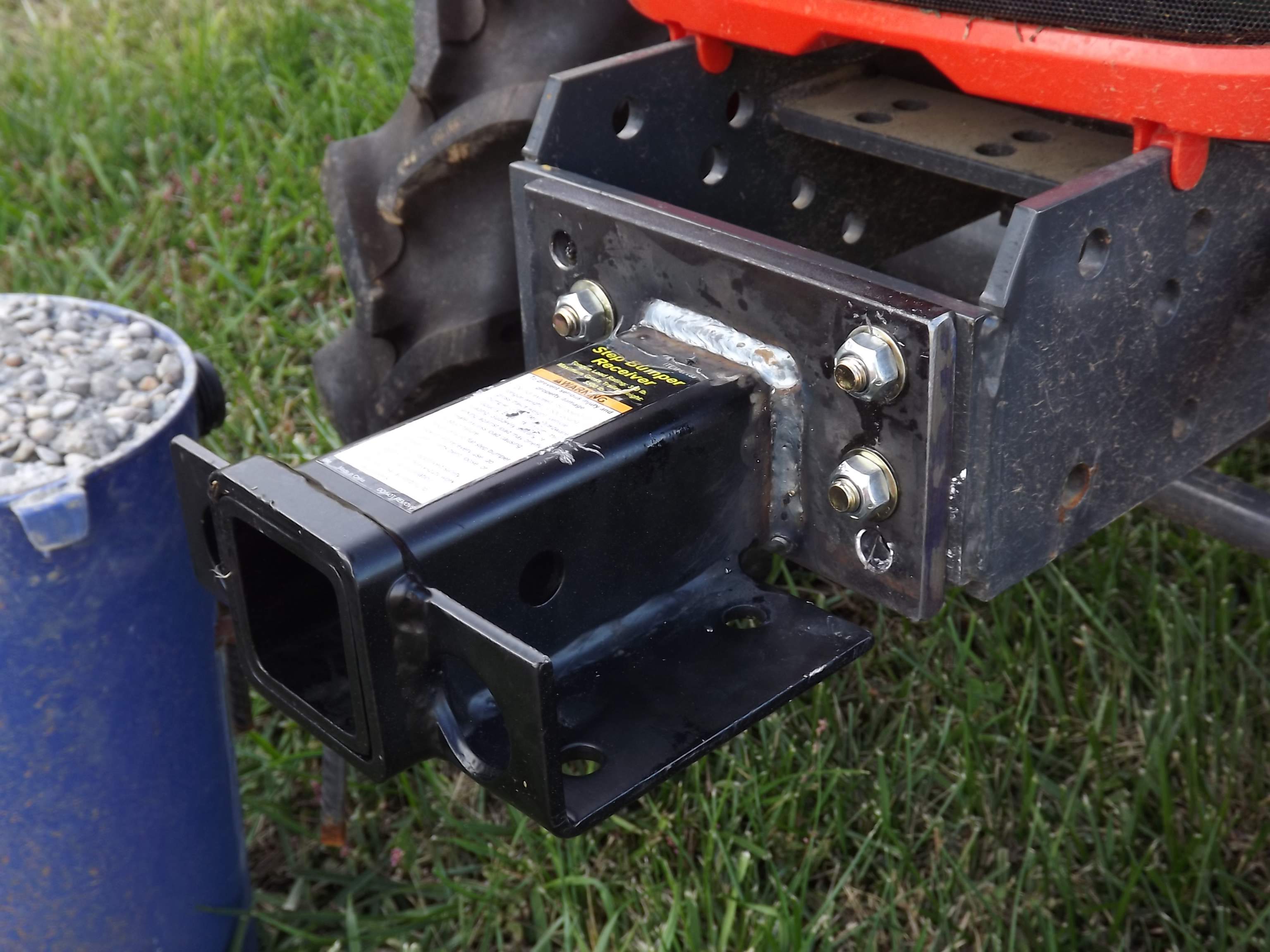

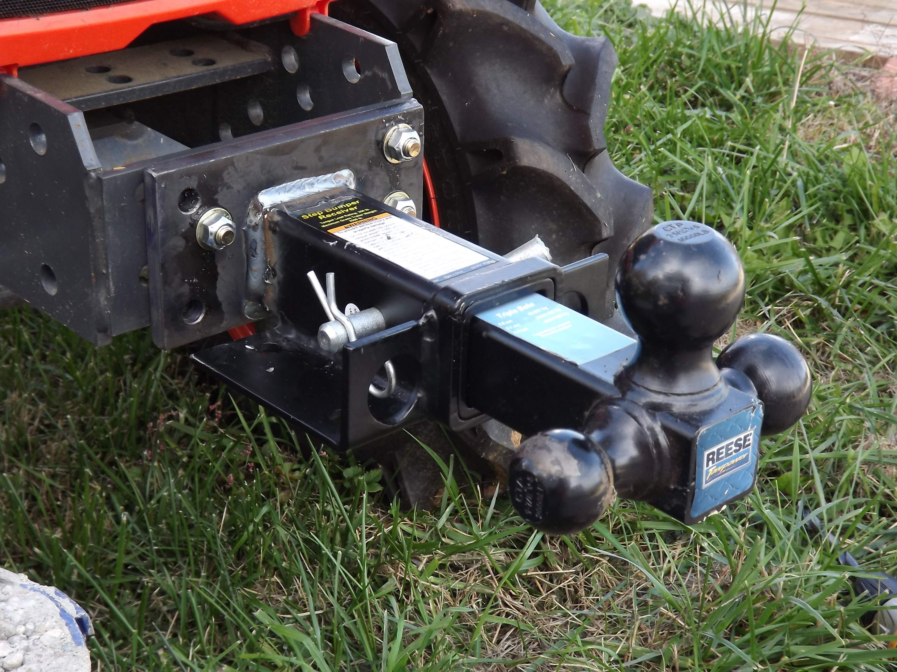

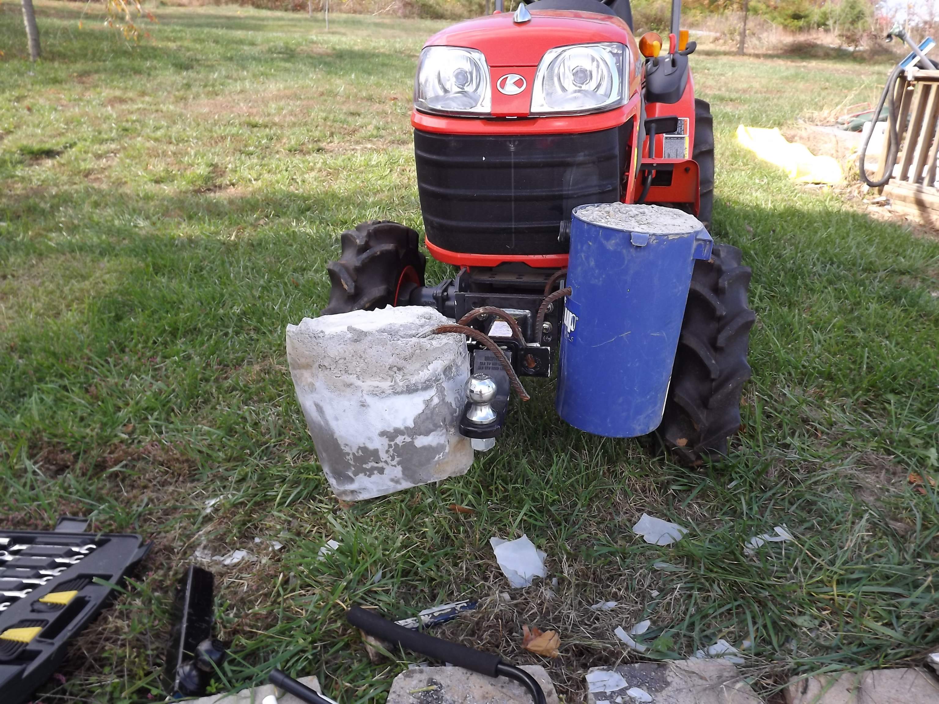

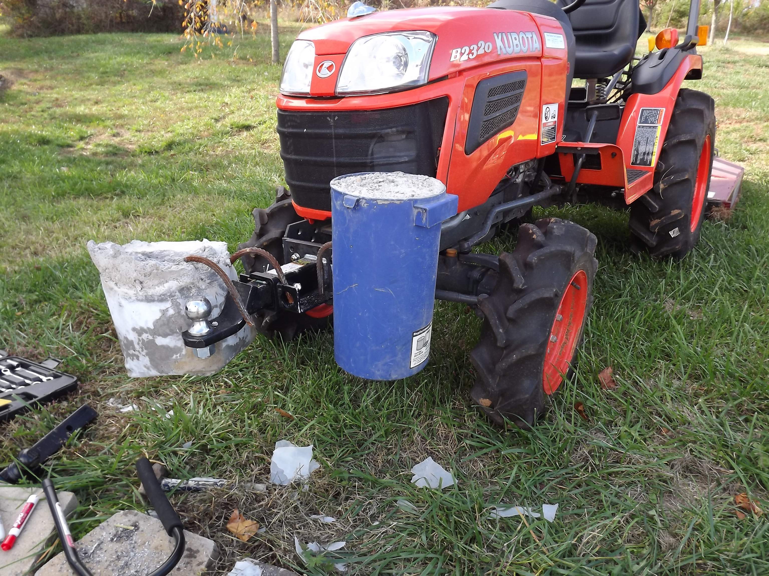

Never had a problem concerning front weights before getting my B2320. Most of my tractors had FELs so that took care of my front weight needs. This B2320 will jump almost straight up in the front with the plow or tiller on the tractor. I'm to cheap to pay $1 a lb for tractor weights so I made my own out of some loose plastic containers, Sakrete (on sale for $3 for 80 lbs) and 2 pieces of rebar per weight. Cheap and ugly but effective. Also bought a Reese hitch receiver and Bro in law welded it to a piece of flat steel.
Need some of that Kubota gray spray paint to fancy them up.:D
