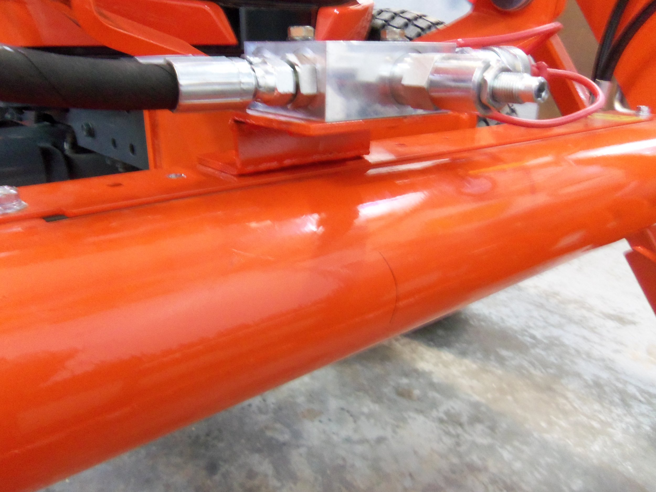

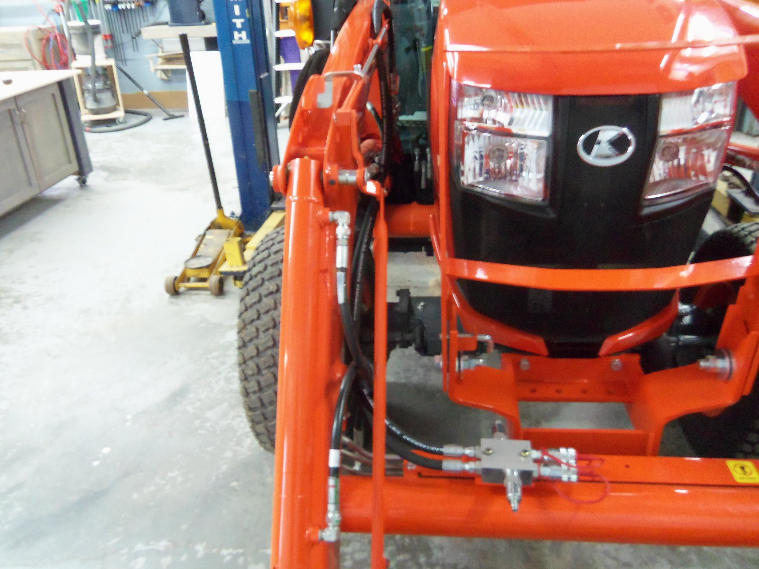

Here a few pic of my cross over valve . had to make a small bracket to move it over a bit but now it fit good .Now do i have to blead the hose and my tree puller or just plug it in and play whit the joy stick good to go .

   / Front function #17
Will self bleed with use
Dave M7040

Thanks Dave that was what i was thinking how it was done but better be sure .
