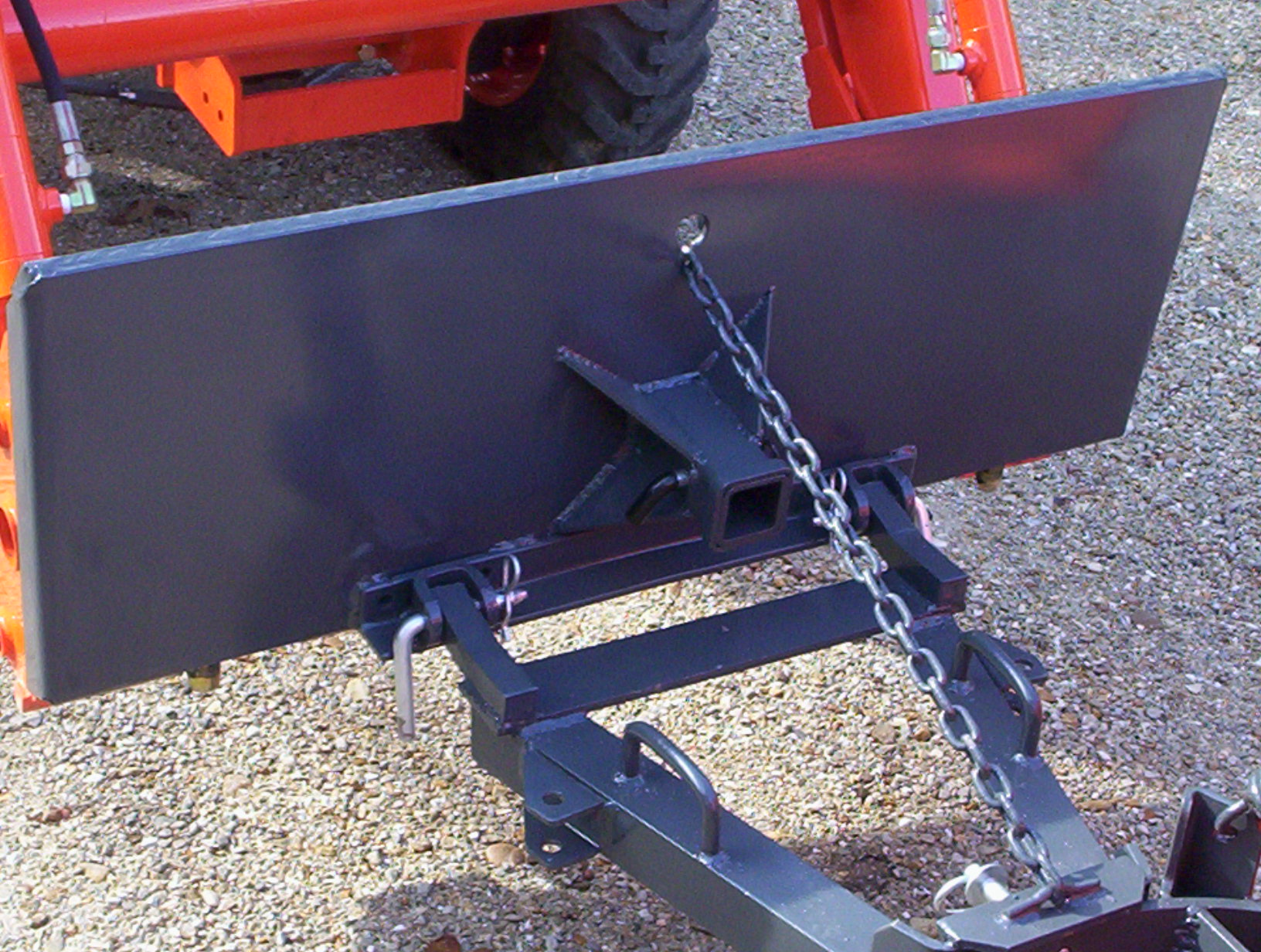

   / front hitch on cut #24

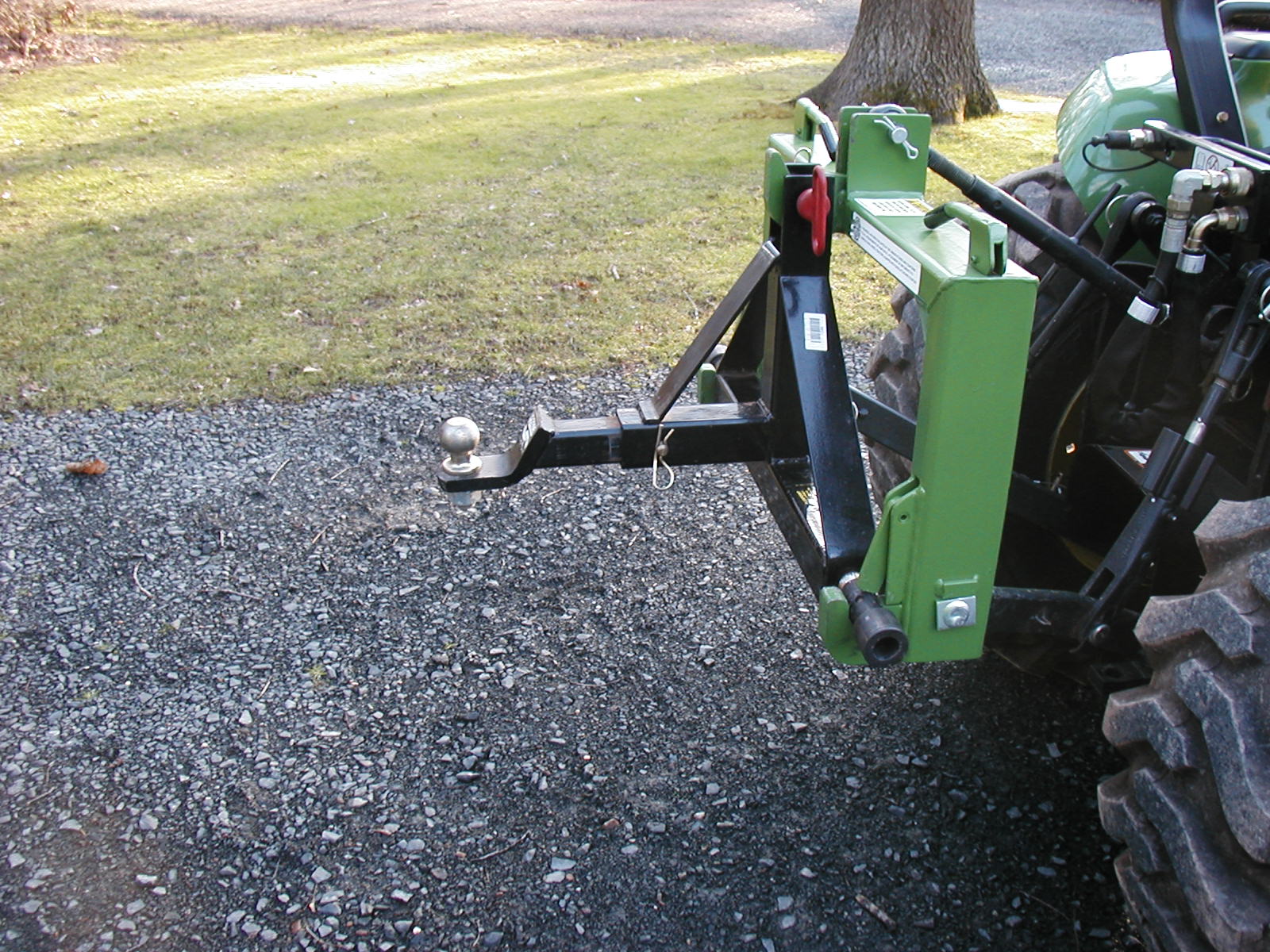

If you had a FEL I would recomend one of these. The only thing better is one of these on a bobcat/skidsteer ! I love mine for moving trailers and the boat around. ( Also made a handy mounting point for the snowplow )
   / front hitch on cut #25
Now THAT'S what I'm talkin about!!!
Nice setup linework!

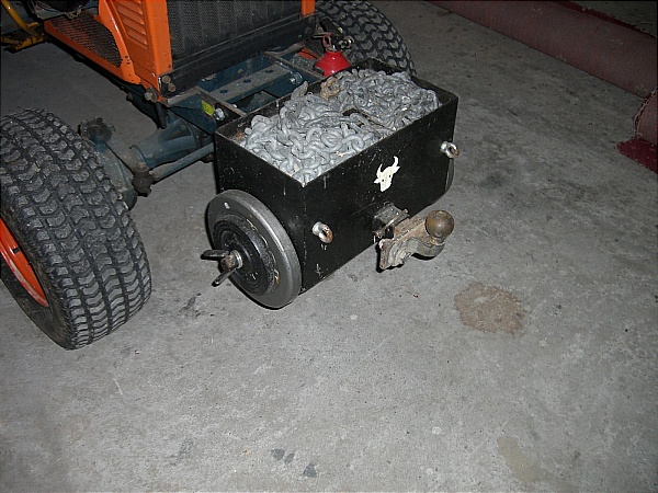

I built a front bumper for my tractor that had a 2" hitch built in the middle of it. I moved trailers around with it, worked quite well. Sorry about distance from bumper this was the only picture that I had. I gave the bumper to another TBN member when I bought a FEL. big dan

   / front hitch on cut #27

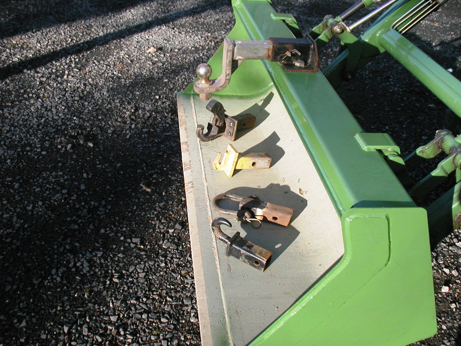

I built this one. I had to make it long enough so I could see it over the 5103 hood but it could be cut down.

   / front hitch on cut #28

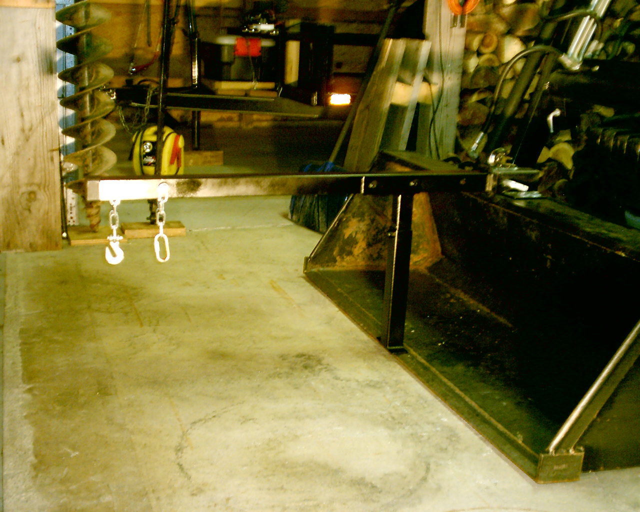

I deal in boats also and just put a Reese Hitch on the top of my FEL Bucket. The one change I would make is to run a heavy piece of plate or a piece of 1/4" wall 2.5"x2.5" tube to stiffen up the top of the bucket. It flexes a little with a big boat like the one in my avatar on it.
Having it on the FEL helps with the tandem or triple axle trailers. You can lift up the front axle or just lighten the load on it.
Here is a picture with my boom pole in it.
Chris

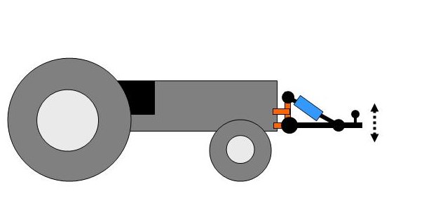

A local trailer manufacturer uses a ball on the end of a pallet fork to manuever trailers in close quarters. The sketch posted earlier with the hydraulic lift is nice but tilts the ball when raised and lowered. A little more complicated device (parallelogram type arrangement) will raise and lower without tilting the ball.
I find the front bumper mounted receivers on my one ton Dodge to be pretty handy, even though not adjustable but for a situation where you do this a lot the hydraulics would be a terrific improvement to a static ball on the front of the tractor and wouldn't have to "stick out" all that far in front.

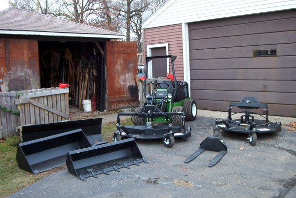

OK, I finally found a picture of the ideal set up for me. These forks was purchased for about $160, and adapted to my
Power-Trac 1445. I also use it to lift other things, engines, tires, welder generators, etc.
   / front hitch on cut #39
Thanks All, what ever I come up with I will take pics and post...
Dan
Dan,

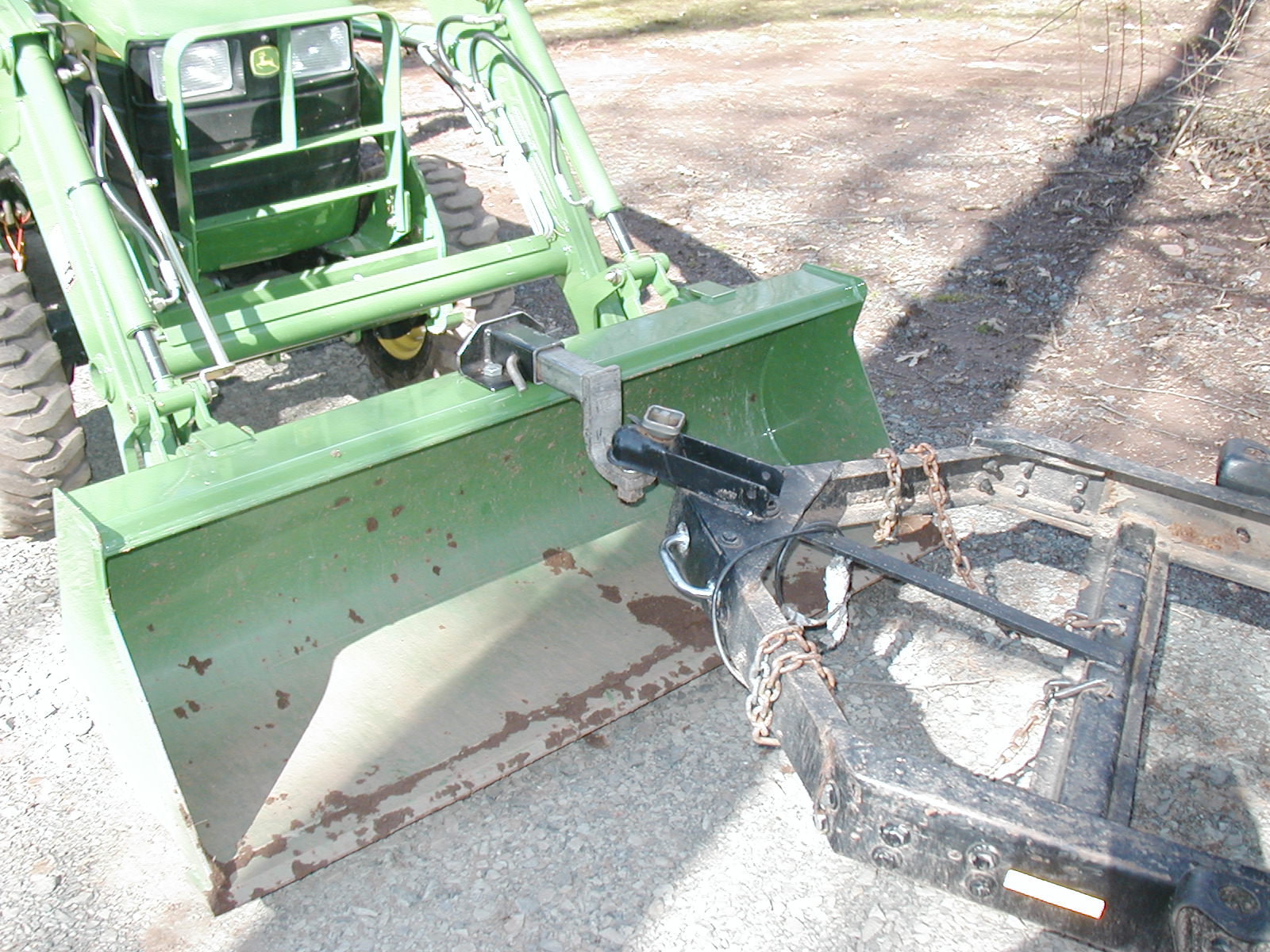

I did what JB did except he bolted his to the bucket. I reinforced the top of my bucket with a piece of 2x2 angle and welded a receiver in the middle.
