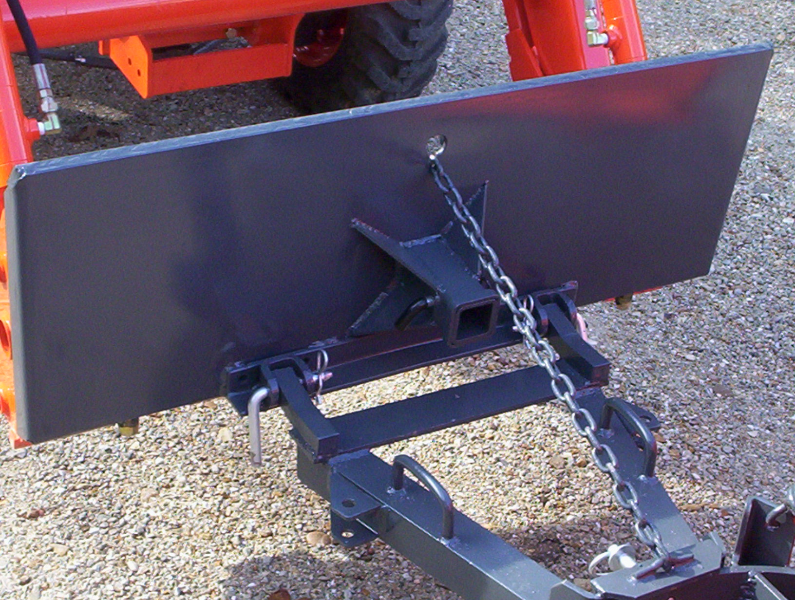

   / front hitch on cut #24
If you had a FEL I would recomend one of these. The only thing better is one of these on a bobcat/skidsteer ! I love mine for moving trailers and the boat around. ( Also made a handy mounting point for the snowplow )
   / front hitch on cut #25
Now THAT'S what I'm talkin about!!!
Nice setup linework!

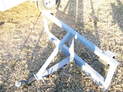

   / front hitch on cut #27
I built this one. I had to make it long enough so I could see it over the 5103 hood but it could be cut down.

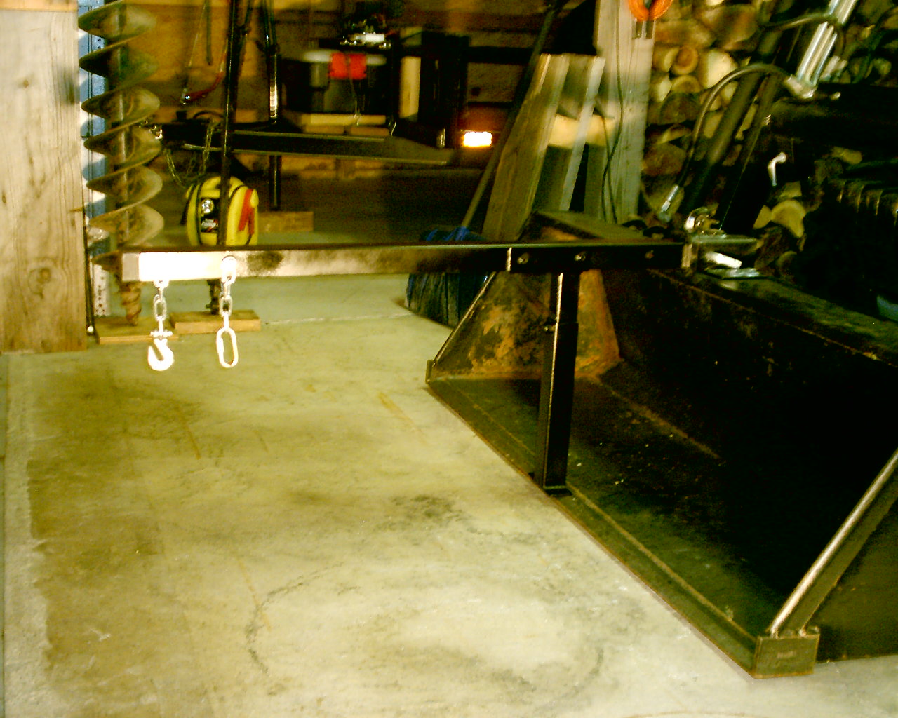

   / front hitch on cut #28
I deal in boats also and just put a Reese Hitch on the top of my FEL Bucket. The one change I would make is to run a heavy piece of plate or a piece of 1/4" wall 2.5"x2.5" tube to stiffen up the top of the bucket. It flexes a little with a big boat like the one in my avatar on it.
Having it on the FEL helps with the tandem or triple axle trailers. You can lift up the front axle or just lighten the load on it.
Here is a picture with my boom pole in it.
Chris
