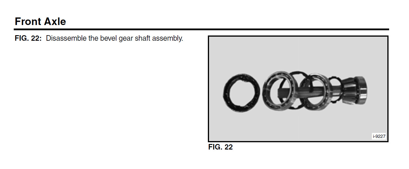

are talking about play on the wheel stud plate on the outer wheel housing?
this is from GC2400 service manual but should be pretty close to the same.
or is the play on top on final case where the bevel gear comes through?
the bevel gear does use bearings.

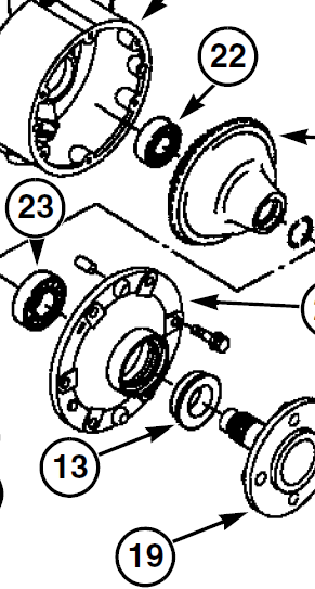

on the gc2400 there is a bearing right there and also at the bevel gear connected to the shaft.
23 is on shaft just inside "hub" and 22 is supporting shaft end at bevel gear interface. possible slight damage to one of these (if GC17x series the same) could have happened?
   / Front hub play #7
On Kubota's (least the bigger ones like I own, the stub shaft) is retained by a split 2 piece ring (13 in your picture).
   / Front hub play #8
#13 there is oil seal.

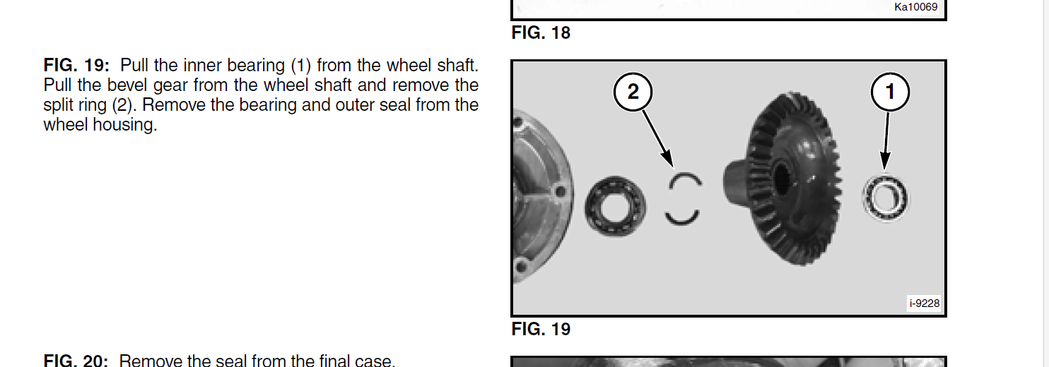

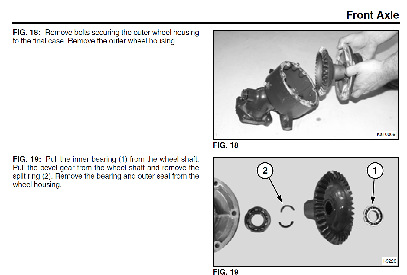

and looking at the 1715 parts book on website to see if there clip that could be issue
there is a split ring on the gc2400
but can't find anything in 17x series parts book about that

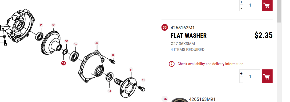

only thing I see on 1715 parts book is what they call washers (4 needed prob means 2 per side) that REALLY look like split rings. item 33.
if one of those damaged/missing after seal replace would sure explain it.
if those are split rigs and if the retention is done just before bevel gear and bearing behind bevel gear supports end of shaft could be it.
