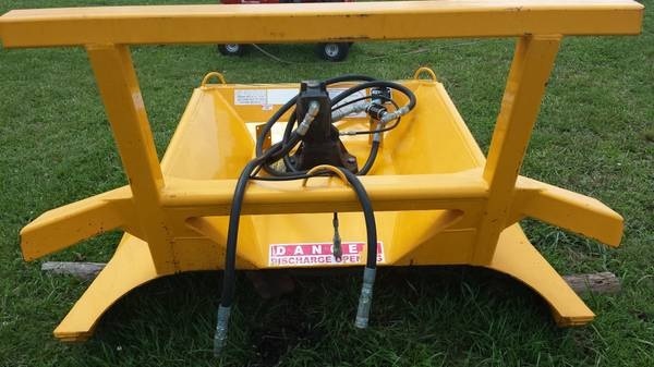

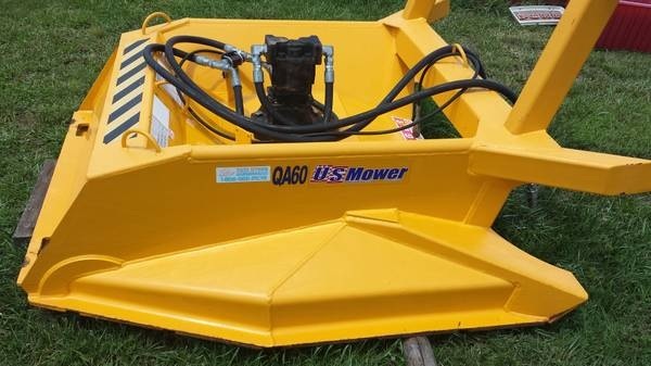

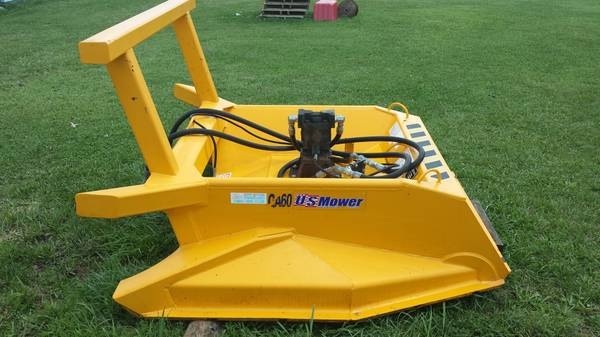

Just to let you all know, I will not be taking on an 8" tree with it, the reason for the knowledge is because the mower is brand new and the guy only wants $5900 for it. It hasn't been used very much. Here are some pics, you can tell its worth the buy. image.jpgimage.jpgimage.jpg

It will cut just about any tree it can fit in the front cut out, depending on the blade length sticking past the lip of the mower deck. I have seen some cutters that the deck will shift back exposing more blade.
The specs say it can cut 8 in tree/shrub.
At 16 GPM, you will just cut a lot slower that the 20 to 45 GPM advertised, because the GPM determines the blade tip speed.
The motor will have the same torque no matter the GPM's.
If you are going with this machine, just go slower and you should be able to cut 8 in trees.

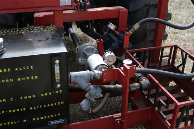

Does your tractor have a case drain ? If not you will need to add one or you risk damage to the motor on the cutter
/ Front loader brush cutter
#26
The mower has a valve to stop if it is overstuffed to let fluid circulate through it.
/ Front loader brush cutter #27
I'm not familiar with that concept how does it work? I am familiar with what happens when the case drain isn't hooked up, best case blow the gaskets out of the motor, worst case, breaks the case of the motor open

I may have been wrong on something, so let me try and clear the air.
One place in the specs says it can cut 8 in brush, and I believe that means not trees. It is one thing to roll over brush, but not 8 in trees.
Another place, they says 8 in trees.
It probably can cut 8 in brush all day, but if the front does not move out of the way for the blades to contact the tree, then it probably can not cut into or slice an 8 in tree.

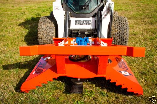

Here is what I thought the yellow machine could do. You can see the blades project out the front.
The Slasher Skid Steer Mower
The case drain would just connect back to the tank/reservoir. I am cautious of QD's on case drains.
This one will cut trees.

Yes, on this one the front is pulled back with a push guard to expose he blades so they will cut before bending completely under the machine so you have to gover each area twice.

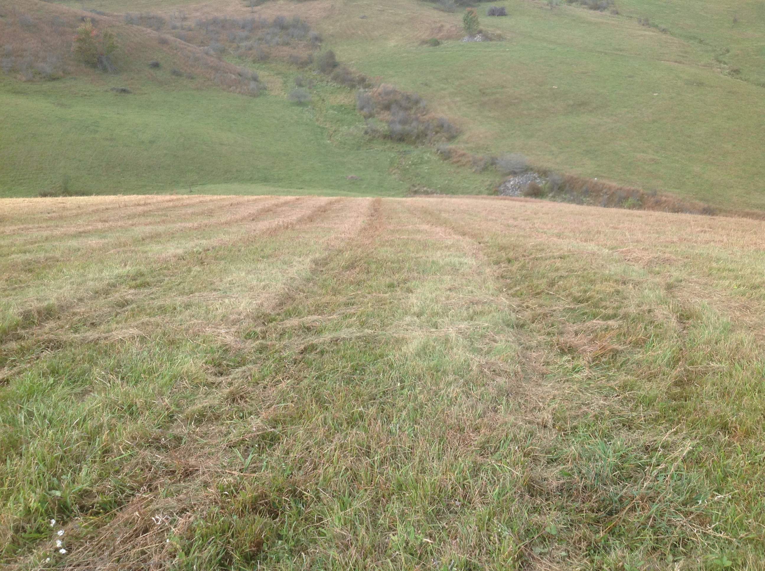

I am mowing dense undergrowth that is hard to get with the bush hog, I would rather have the mower infront so the trees don't damage the undercarriage of the tractor to much. Here's some pics of the growth.image.jpgimage.jpg
Do tractors typically have a case drain plumbed in ? I'm very familiar with construction equipment and we use QD's all the time with the only problems being when guys don't connect them
/ Front loader brush cutter #33
No, tractors don't normally see case drain hoses.
They could be teed in with return lines if there is no back pressure.
