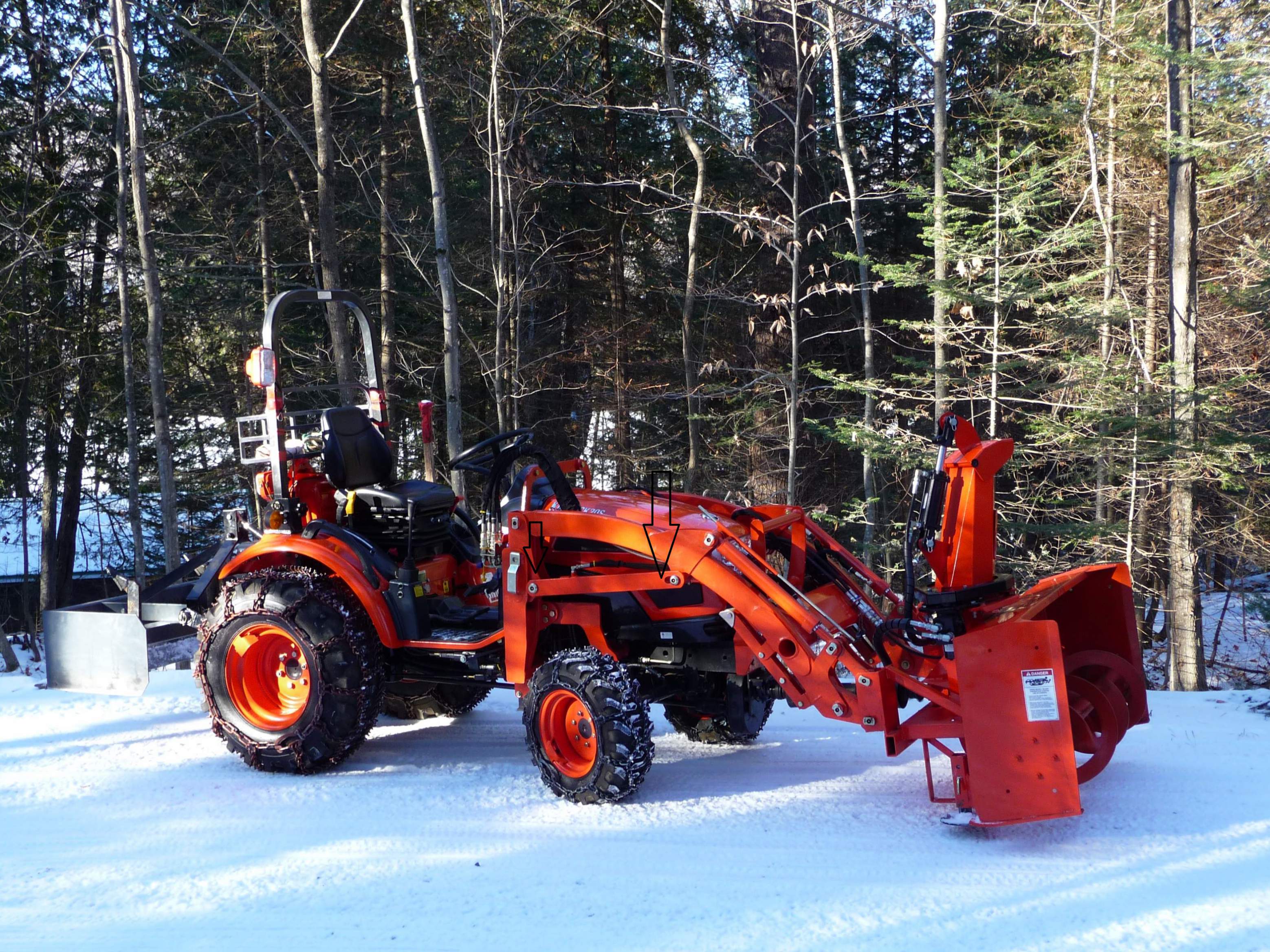

Don't feel like the Lone Ranger, the Kubota B-3000 has an undercarriage that the Front mount blower is attached to.... first couple of times it was a real hassle mounting it by myself. But it's well worth effort once it's mounted and up & running. Now it's a piece of cake to put on . :thumbsup:
Get my Drift ! :D

That picture says it all as far as cab / no cab . Nice pic , like the headset .

It's a heavy set up... But with weight comes reliability! It have never failed, but it's on the heavy side. I have a friend who combined in a late fall: oil change - maintenance - chain installation - front mounted snow blower on the same service call. Make sense to me.
