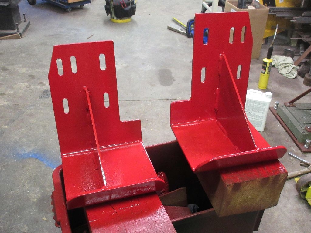

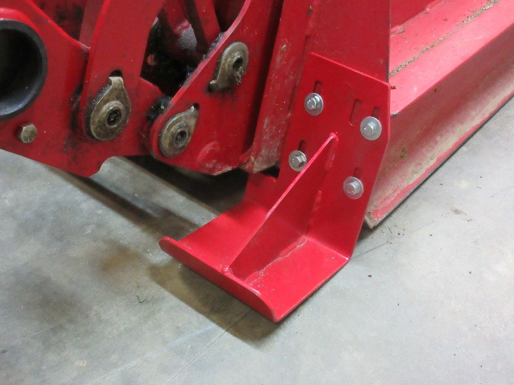

The other improvement is the fabrication of the bolt-on rear skids which make backing up a lot easier and smoother. Operating the cutter backwards has proven to be an efficient approach to finely mulch trees and vegetation after being knocked down. The capability to "climb" on top of brush or attack vegetation at varying angles is certainly a positive feature of a loader-mounted cutter.

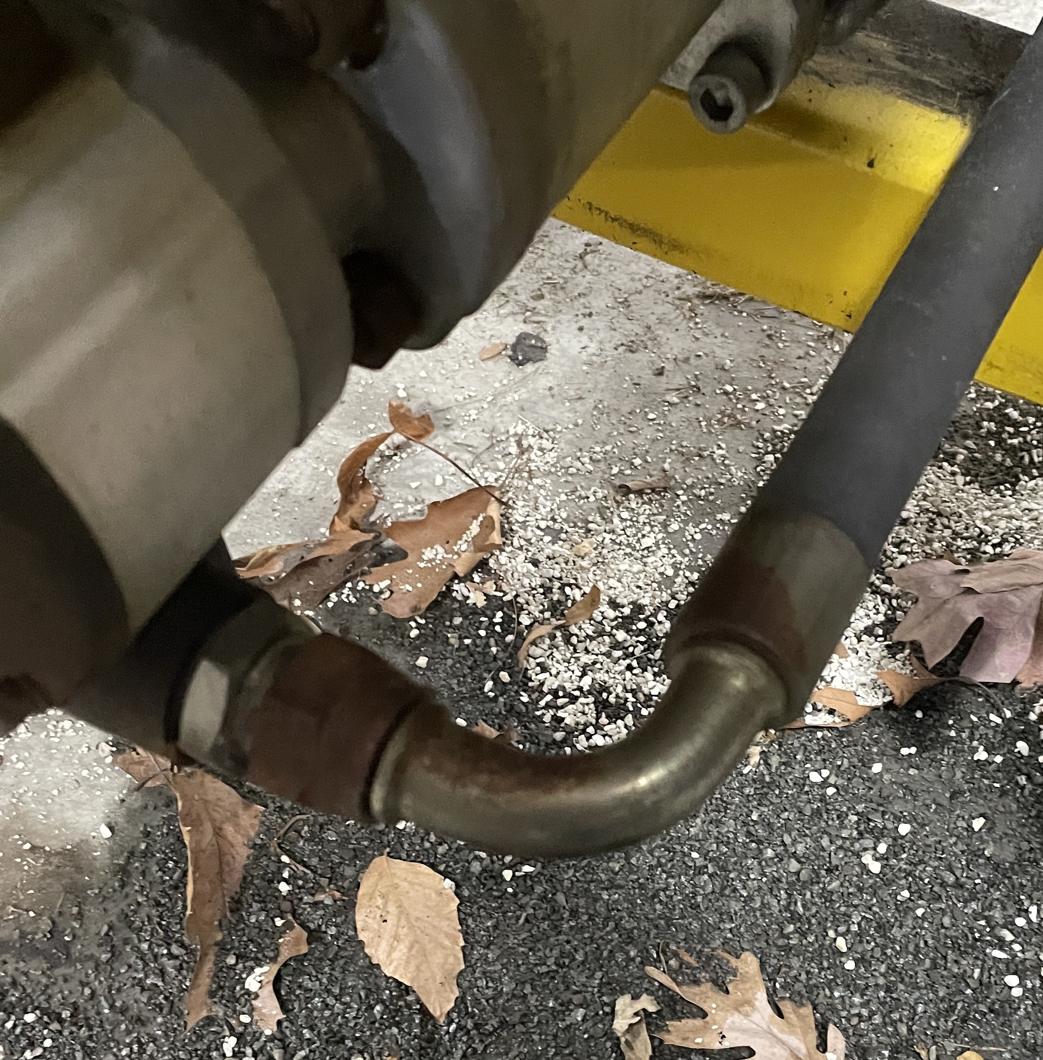

If overheating is a real problem you might try getting some hydraulic line bent up to replace as many fittings and elbows as you can.
I don’t think there’s an elbow on this Twose.

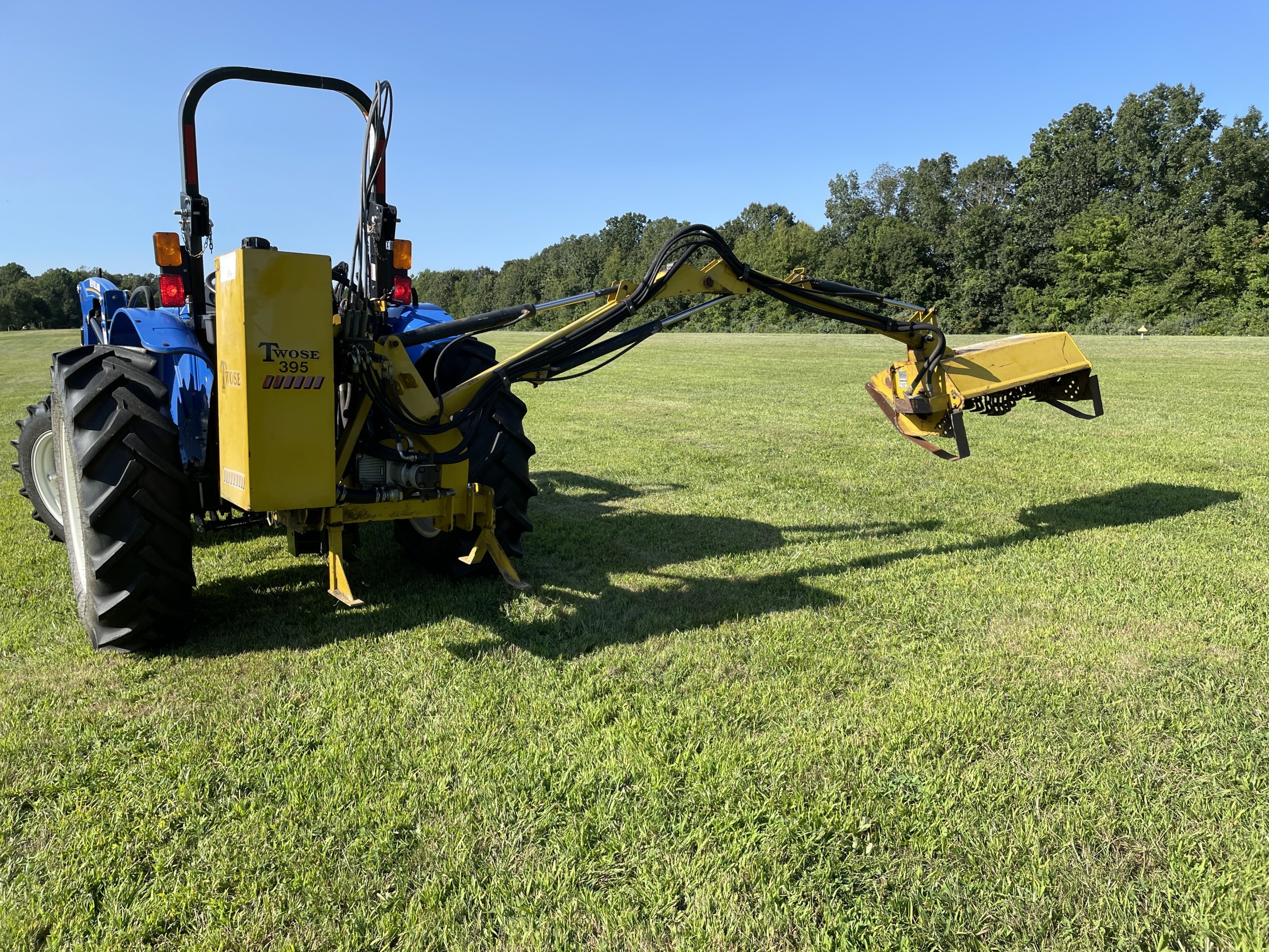

   / FRONT MOUNTED BRUSH CUTTER #17
This is how the Twose did it.
