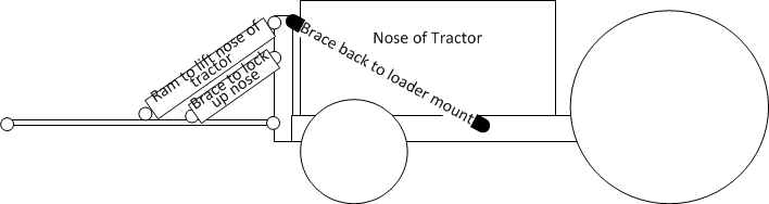

I dont see these very often in central texas but wanted to ask a few questions before embarking on this journey.
I want to build one of those hitches that can bolt to the front of my tractor to hook it onto the rear of my pickup, say with a 2" ball.
It would have to pivot up and out of the way when not in use. The idea is : I need a cheap and easy way to get my tractor about 4 miles down the road from time to time. my trailers always seem to have horse hay on them.
I have seen them before, and never really understood why the towed vehicle doesn't "turn and run off the road" since no stabilizers go to tie-rods or anything.
So, questions are:
what could I consider top speed would be for my old wore-out MF 65 in tow behind the truck? 25 mph? would be nice as it would make it a one man operation to move the tractor.
My tractor has very worn tierod joints and other steering "looseness". Am I an idiot for thinking this will work?
If you recommend me build it, any pre-warnings? what mistakes can you lure me away from?

Personally I wouldn't do it. With the weight of the tractor and if the front wheels aren't aligned properly it could be an accident waiting to happen. I would unload the hay from the trailer that can carry the weight of the tractor. If it's square bales then a hay storage shed is in your future. But if you do go ahead and tow your tractor I wouldn't go over 10mph.

If you aren't going far, how about a tow dolly that you just put the front wheels on and don't have to worry about worn tie rods.

You could always weld up a 2 wheel 'dolly' like the RV folks do when they haul their cars behind their RV's
Those dollies are basically a low flat unsprung trailer AKA a long 'T' with wheels and a flat area just adaquate to take the front wheels.
The 'pole' goes on your trailer hitch and you lash the tractor front wheels to the flat bed.
Off you go!
Naturally to be on the right side of the law, you need stop lights etc etc.
As the tractor is unsprung (unlike towed cars) your speed will be limited.
If U have a FEL, then your pole will need to be long enough that the bucket won't catch your tow vehicle in turns.
Doable?-yes Practical ? ?
I could probably rig one up in 4 hrs or so!

I would probably go with a hitch that raises the front wheels off of the ground, and then have a way to lock the front axle from pivoting and catching on the road. Then go slow with the tractor gear and range selectors in N.

A 2 ton MF65 at speed, will push the unloaded rear end of a truck off the road, unless you keep at tractor speed... Just a matter of time before you get into trouble.
I also think the towed dolly that carries the tractor front wheels, is the best idea. It solves the issue of tractor steering the truck, and of the sloppy tractor tie rods.
...OR just get another trailer: if your trailer is allways loaded with hay, it means that you have a hay stack on wheels, but no trailer. Wouldnt you at least need a trailer ?? ;)
