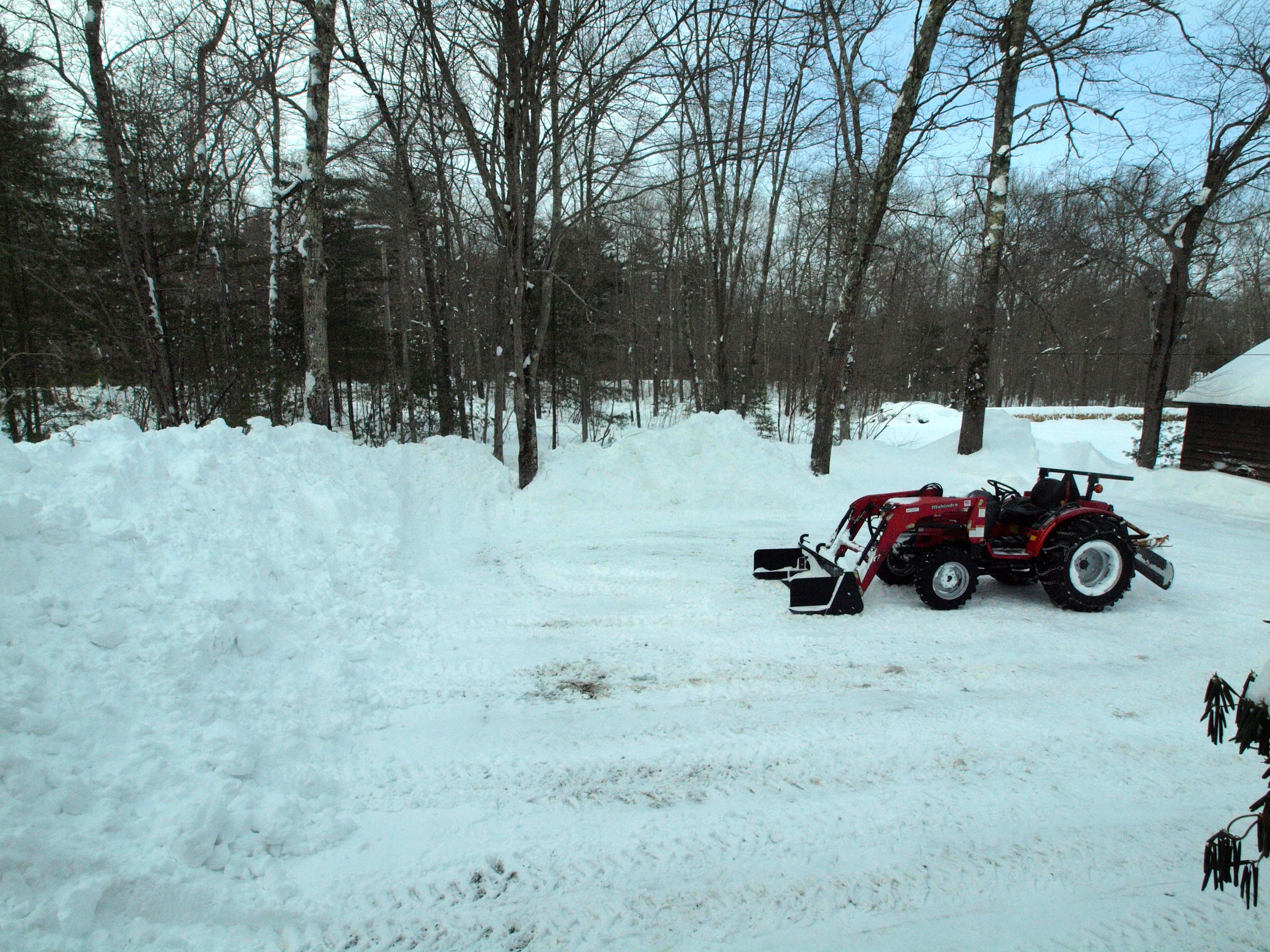

   / front plow and rear blade #16
So when the rear blade is down, you are scooting over (fishtailing) when you use it to push? Putting weights on the rear plow would only help when the rear blade is up as far as tractor control. You would need either wheel weights or chains. I have chains on my ags. They make it a different tractor traction wise. You think you don't need them but you end up kind of surprised what they do for the tractor. I'm pretty happy with this set up. The bigger the tractor, the bigger the implements but you can run into the same problem as loads increase that the bigger tractor can muster over the smaller one. Chains would cure your problem. I leave mine on all the time.
My understanding is that he's losing traction when the front blade is being used, and the rear is in the air. Well, that's the situation in which rear ballast might help. As you say, the ballast isn't going to do anything with the blade on the ground. I'm speculating here, but I would imagine that when you're using the front blade, the front tires are gonna get pushed out of line, not the rear. So, maybe i don't understand what the OP is trying to fix. I agree with everyone about the chains though. I run them just on the front tires of my snow removal tractor (TC29D with 7' rear blade), and it makes a huge difference in steerability.
