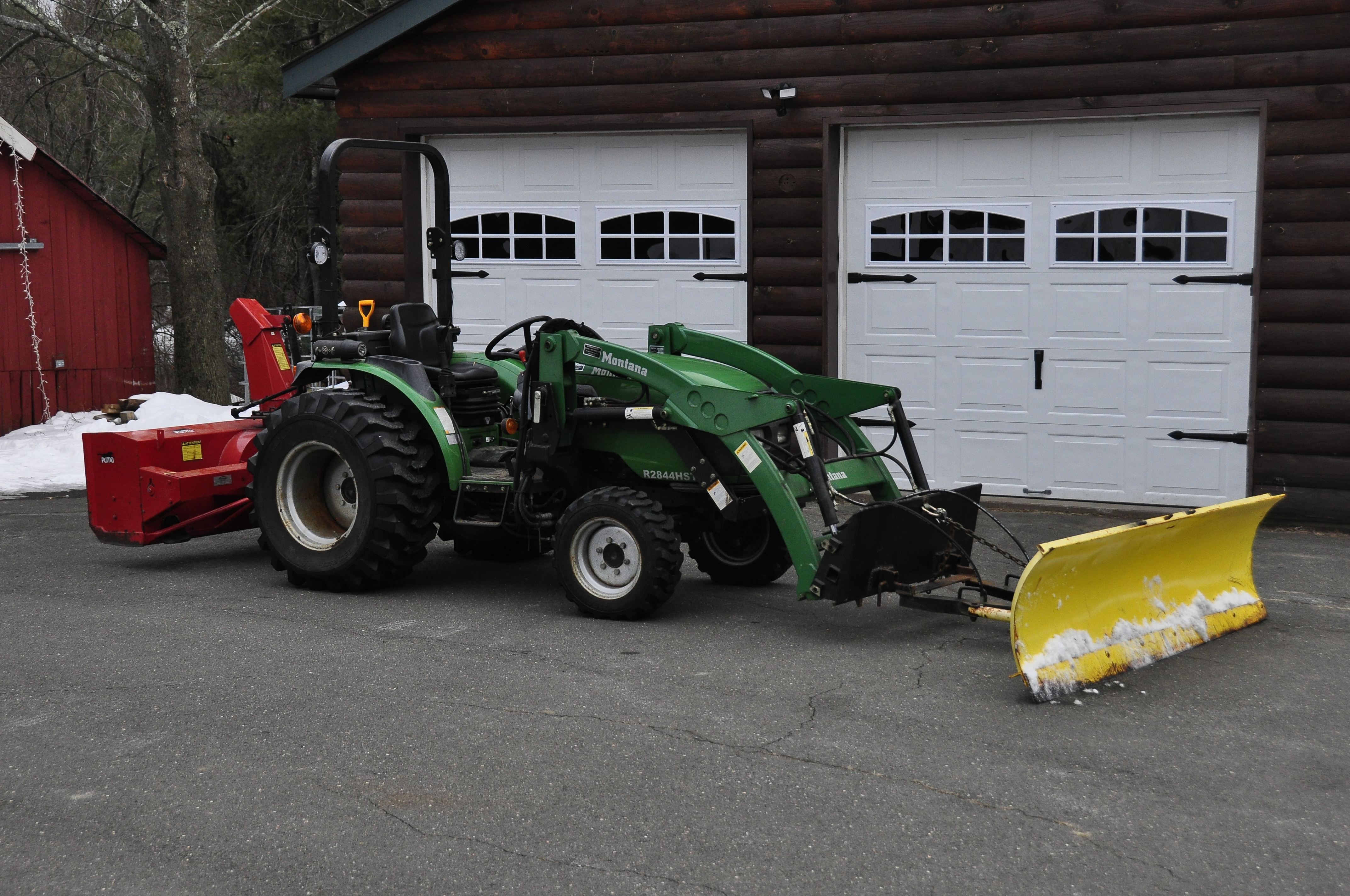

Yes I have a front blade and no you won’t damage your machine or loader frame.......if you buy a “real” blade.
Good snow plows have trip springs and come with or you can add a cross over relief valve.
Your tractor is low speed compared to most plow operations. Those guys don’t do damage and you won’t either.
^^ x2
I'll add that a floating blade, on chains, is very important too. This allows the blade to float while the weight of the FEL arms is raised slightly. A lighter footprint of the blade means it won't cut in too hard, is less likely to force the front of the tractor sideways, and so it takes the strain off the FEL arms. I use a Hiniker Big Ox blade that is made for skid steers or tractors. It articulates left and right as well as floating vertically on chains.

Okay so as long as i look for a plow with trip springs & and a crossover if possible sounds like the best best, what plows do you guys use, i suppose i could build one, but need to do some research and see what they cost new
Yes.
My plow has trip springs, but I never did add a crossover relief. Been running an angled front snow plow on this tractor/loader for the past for 15+ years, No issues.
I used a well used 9' Western truck plow, converted to SSQA to fit the tractor.
Also added a 12v selector valve to my loader controls and hoses for power angling the blade

I have been running a converted truck plow for ten years(FEL mounted);it has a chain float ,trip springs and a cross-over relief valve;no problems at all.8' plow on a L4240 Kubota.

I have a 7.5' Meyer truck plow that I attached to a SSQA plate. I angle it with my rear hydraulic remotes and use a chain lift so it floats on the driveway with the FEL set about 12 inches off the driveway. Works great.
