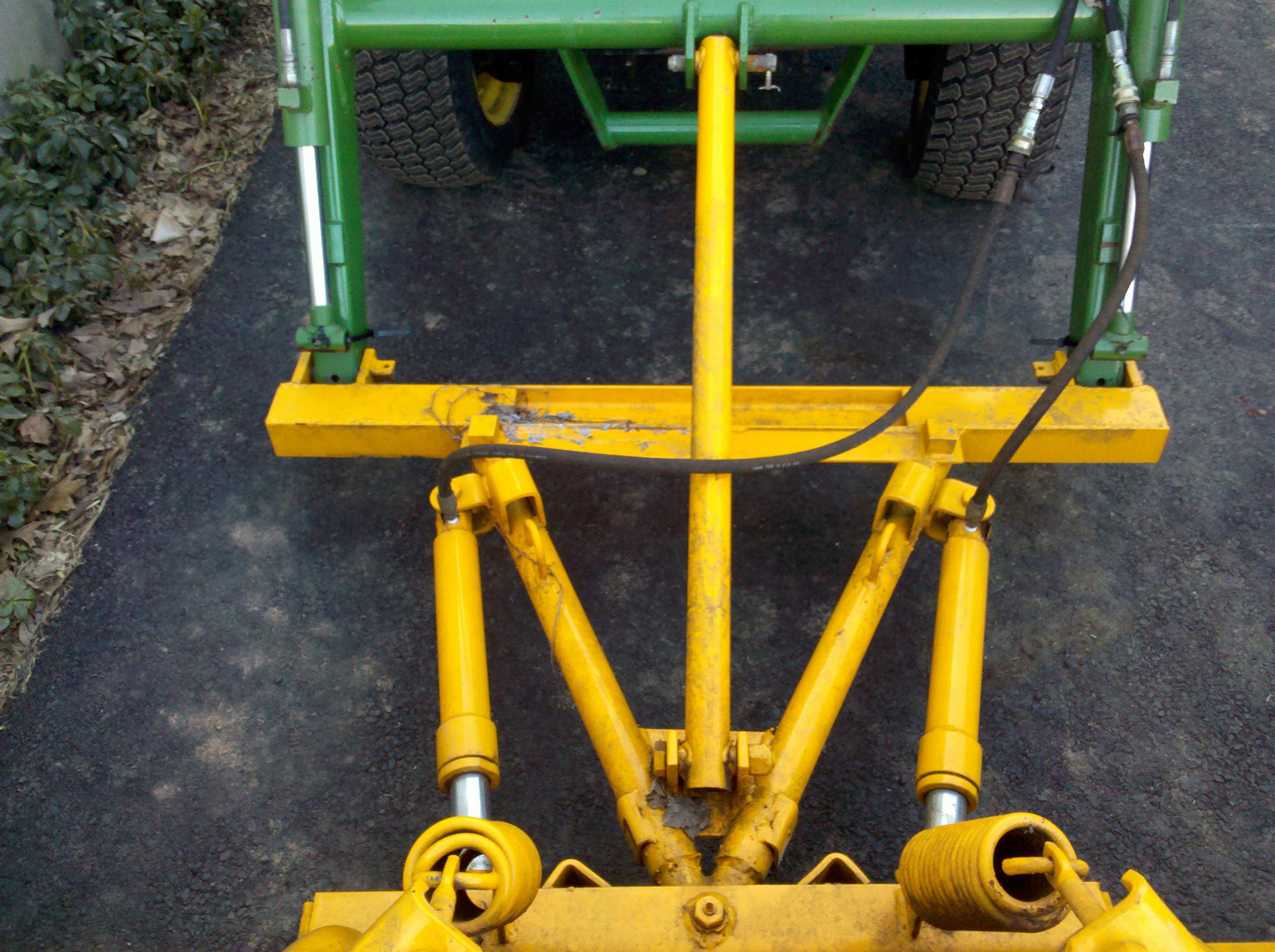

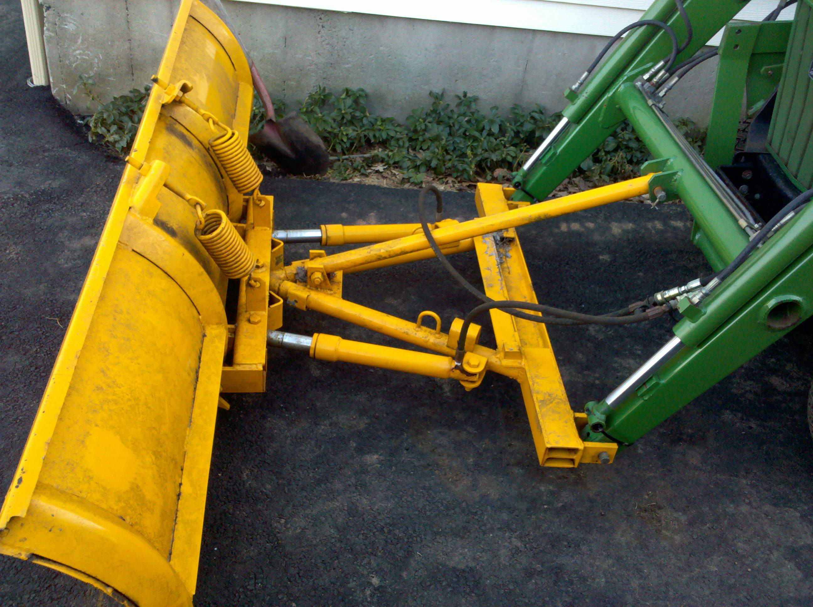

If you know a good welder / fabricator it can be done. When I picked up my JD 855 the last owner had a 6 ft. Myers plow fitted the FEL to raise and lower and the curl to angle. Works great. If you have a day I will send out some photos.

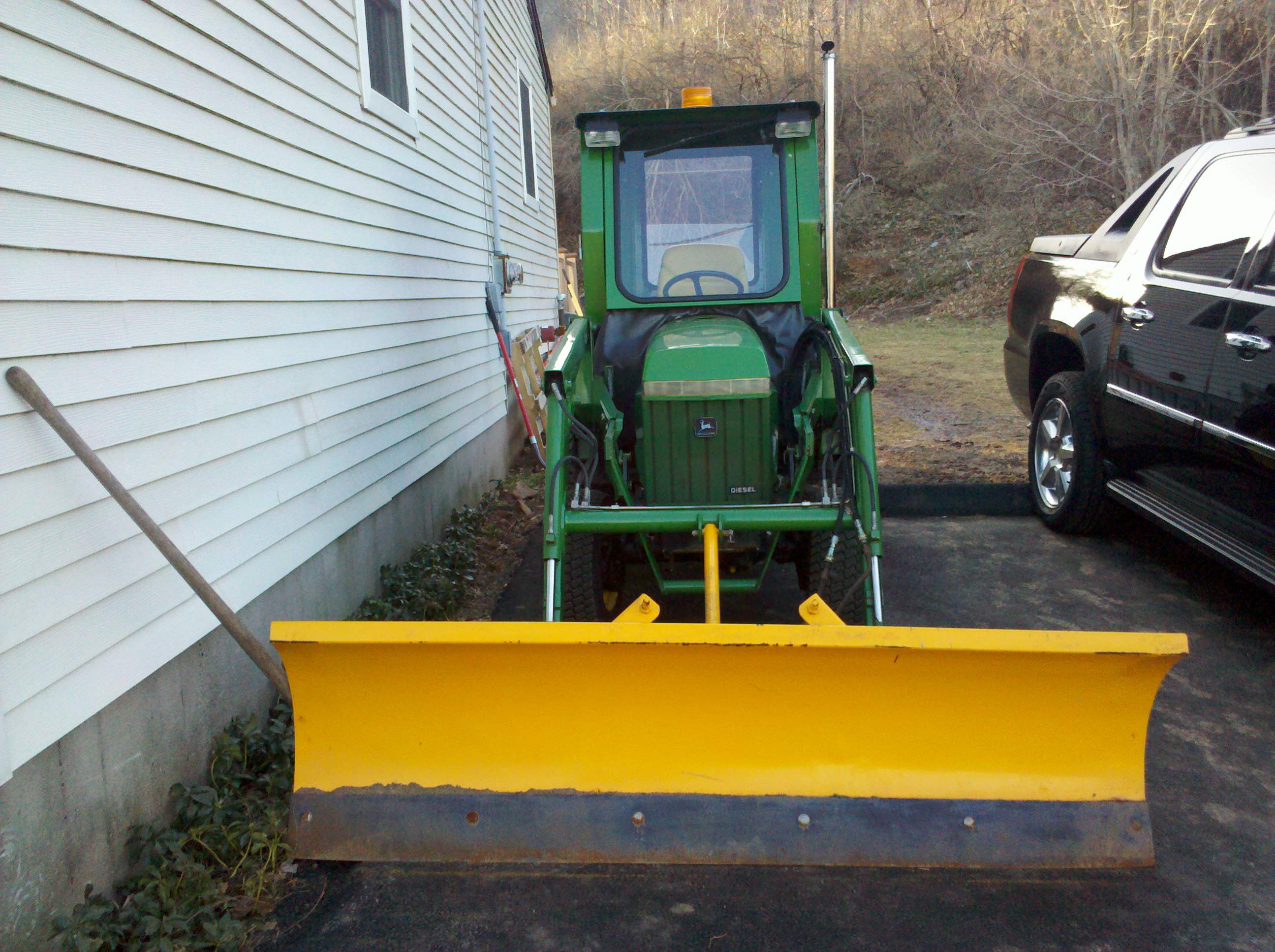

Don't know if this worked out but if there are photos this is my plow set up.
Has worked out OK so far.

Hey that looks like a Snoway plow, I have broken the moldboard out of at least 3 of em!! Thanks for the info, that is kind what I figured.
