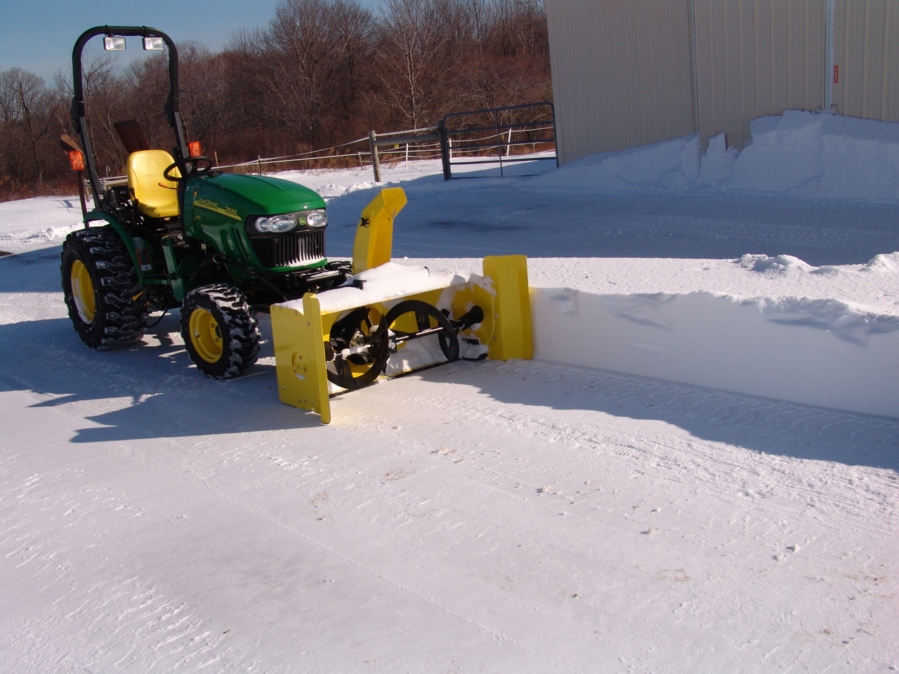

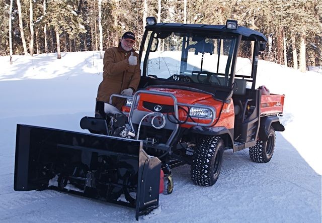

I wouldn't offset your blower, just make some wings to go on the sides...... maybe three inches each side. I just tried to find you a pic, but didn't find exactly what I was looking for. They would bolt on to either side of your blower and effectively make the housing wider. I'm sure you can buy them somewhere, but they wouldn't take much to make. Similar to the ones in this picture, but not neccessarily with the piece across the top.

Perhaps these wings are something like Ductape was talking about. The pictures are from another member here.
Kubota also makes "drift knives" for it's snowblowers that extend the width by a few inches on each side. I'll try to remember my camera next time I'm going past the the Kubota place that has some mounted to blower there. The knives are mounted by three bolts, and could easily be adapted to another blower.

Thanks Chuck, thats what I was trying to show NIdaho.
