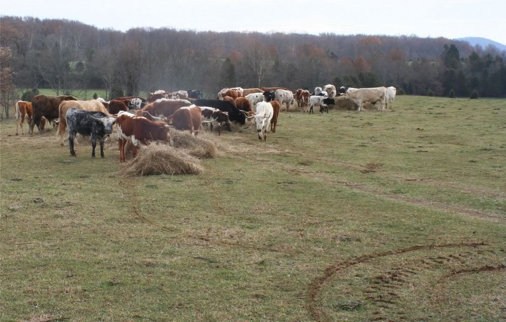

Through all of this discussion I've learned a ton about my tractor and these tires. This summer it wasn't much of a deal on the concrete soil. Now that the rains have come and my field are both over grazed and wet, it's a muddy mess many places. Those tri rib deals do tear up the ground even more, but I found out today how important that grab is in the front end. There were several times today moving round bales where a tire with less traction would have just pushed in a straight line. I could really see the benefit of that center rib digging in to turn my tractor.
I didn't really think to get a picture of the tracs, but noticed this shot when I was going through my pictures tonight. You can see what I'm talking about here. This is on the top of a ridge, so it's not too soft here.
Granted that's also a pretty tight turn, but I was trying to maneuver with the hay and such.
