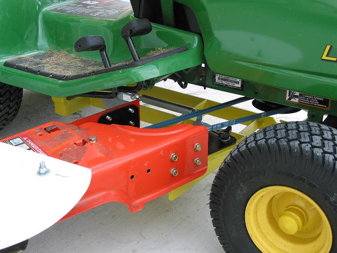

When I first saw your pictures I thought you had mounted the string trimmer head in place of the deflector chute on your mower deck - now I'm thinking, why not? Mow and trim at the same time.
/ Front Weed Wacker #22
Re: My 16HP riding weed wacker
I thought about that, but there were two problems: you'd probably want to use something smaller than this 22" trimmer; and this little tractor doesn't have enough power (on my lawn) for its 42" deck alone, but its got plenty for the trimmer. It's really quick to switch between the deck and trimmer.
I mow with a 72" RFM without trying to get too close to anything, then make a quick pass with the 42" deck to clean up the spots I missed, then pop the trimmer on and attack my fence and ditches. After that, it's Miller time!

Depending on what model tractors you guys have, I would be glad to look at wipping up a batch for you. If we could do enough, we should be able to hold the price down. Besides the JD LX series that I have, I would think the JD L120 they sell at Home Depot would be a natural (like the LX, they have an electric PTO clutch that simplifies the belt arrangement)

Thanks. The neat thing is, unlike some of my ideas, it works as well as I had hoped it would. It cuts foot tall weeds and grass like butter.

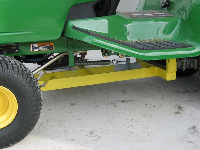

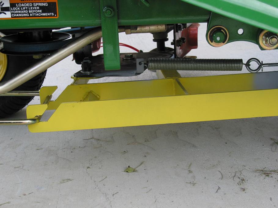

</font><font color="blueclass=small">( Here's a fence trimmer I build from a large wheel gas powered string trimmer. It clips on to the mower deck mounts with two pins in about a minute. The original had a 6HP engine, so I geared it up a little and usually cut at about half throttle. The mower height lever raises and lowers it, although it could use more range than the mowers 4 inches. Sure does cut great though. It's spring loaded and pivots around fence posts. )</font>
The only draw back is you have to remove the mower deck to use this?
