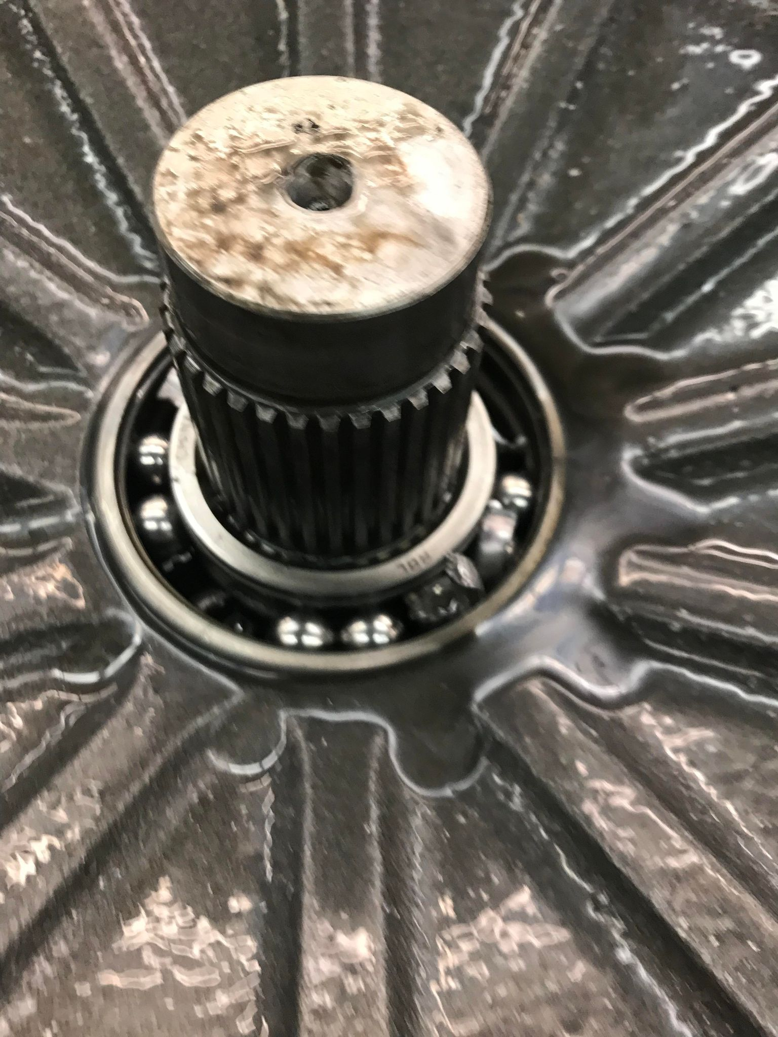

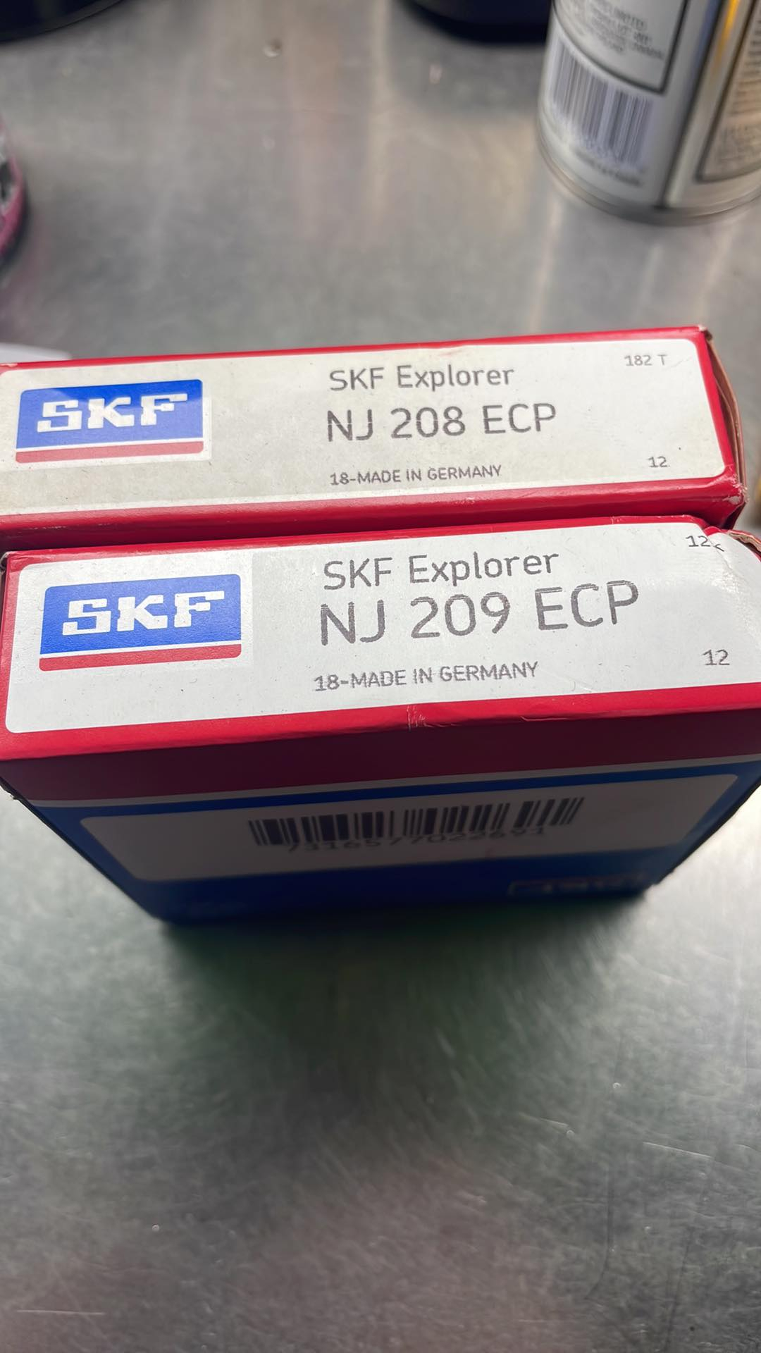

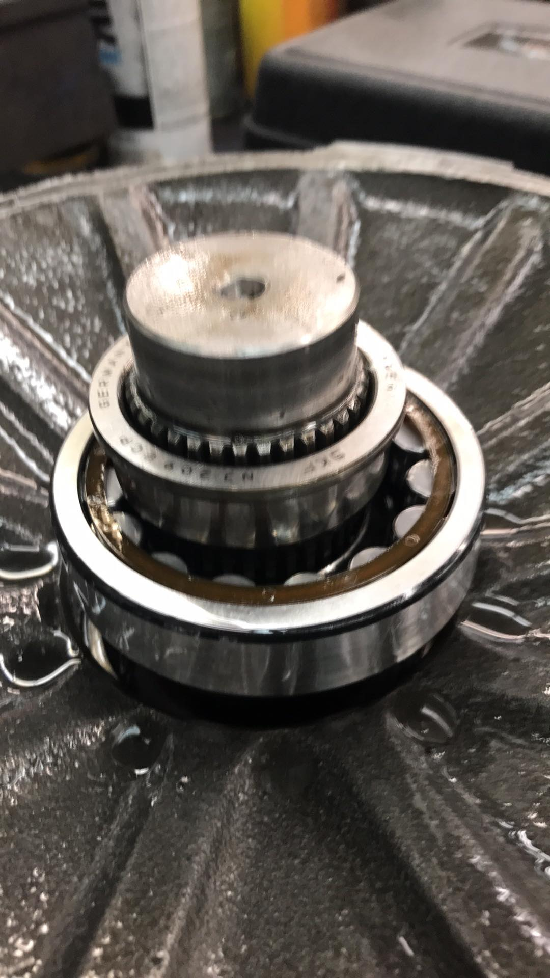

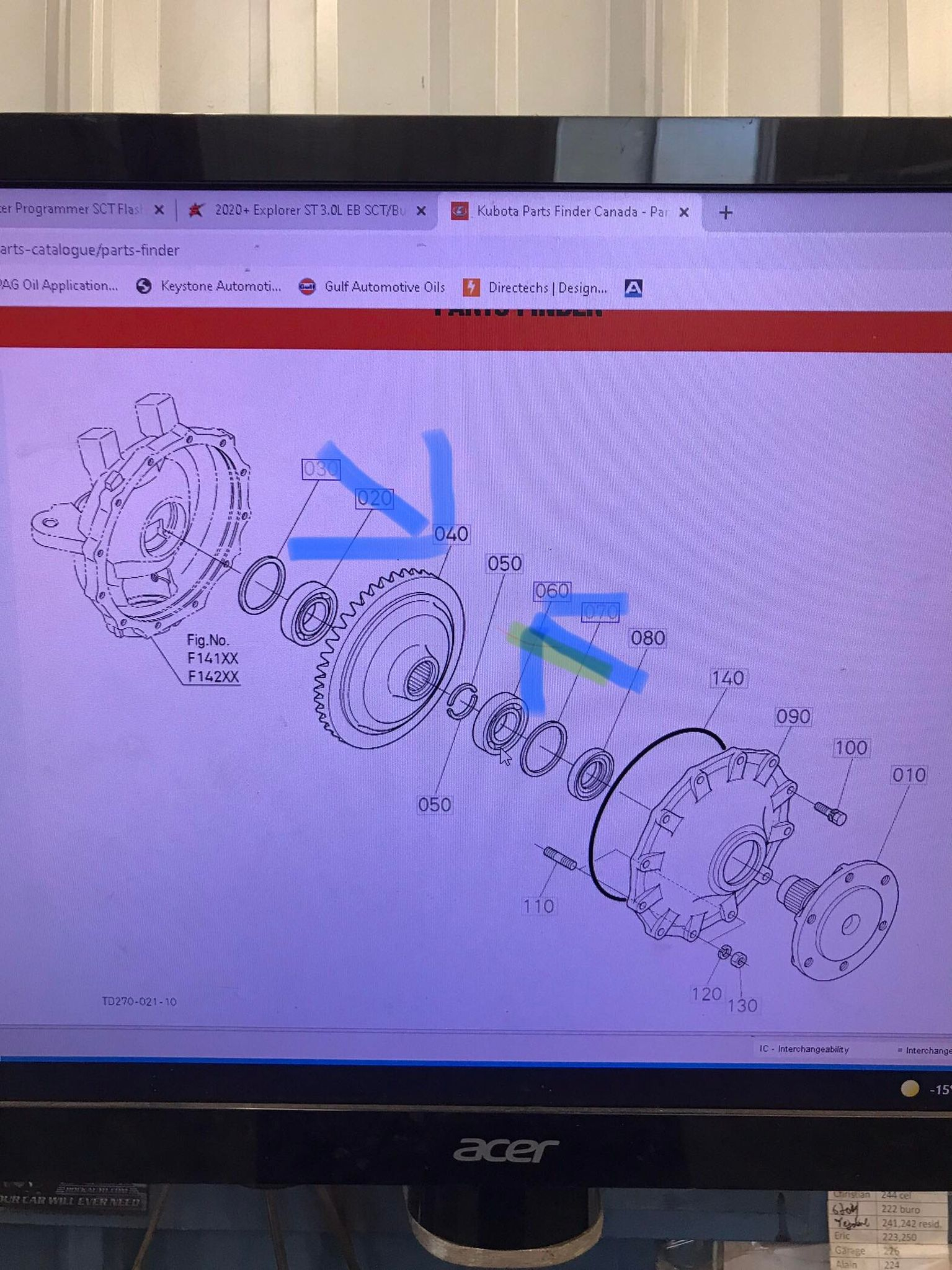

heres the part number from SKF, and the direction they must face, because they have a direction otherwise you will destroy them in 10 feet lol look how the normal bearing one fail ! been there, done that a couple time before i switched to roller

Let us know how those work and last. Those bearings are meant for really high radial loads but not so much axial loads even though it will still handle those axial loads a little bit. Time and use will tell if it's a good alternative though.

I am not familiar with the particular set up but usually tapered rollers are held in place by a nut and the nut is tightened or loosened to adjust the preload. if the stock ball bearings are held in by snap rings how are you adjusting preload and what keeps the load from trashing the snap ring and letting the two halves separate. maybe the orientation you mentions is what keeps them together by using the housings instead of the snap rings.
Any tips for shimming to the right backlash
I agree the design is crappy but I think I would rather replace a couple bearings than having to replace expensive housings if the bearings eat up the contact faces.
how many hours do you have on the new configuration?

tractor is a bit over 4100hours right now, been running them since a couple years, so more then 900hours, i do around 300h by winter of plowing and snowblowing, and around 100 during summer with hay transport. so far so good no play or leaking seal since i done it. i was doing other type or bearing every years so i dont break down during winter because they lasted around 300-400h max, i think its my plow setup that is a bit heavy that wear the original bearing like crazy. but trust me, if you dont follow the direction of the bearing, it will shatter down in a minutes.
those one also cost 2 to 3x original bearing
