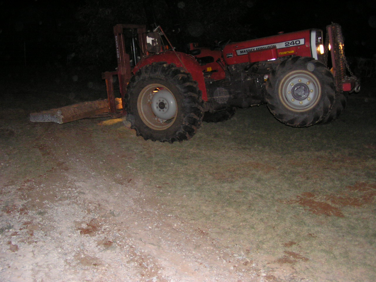

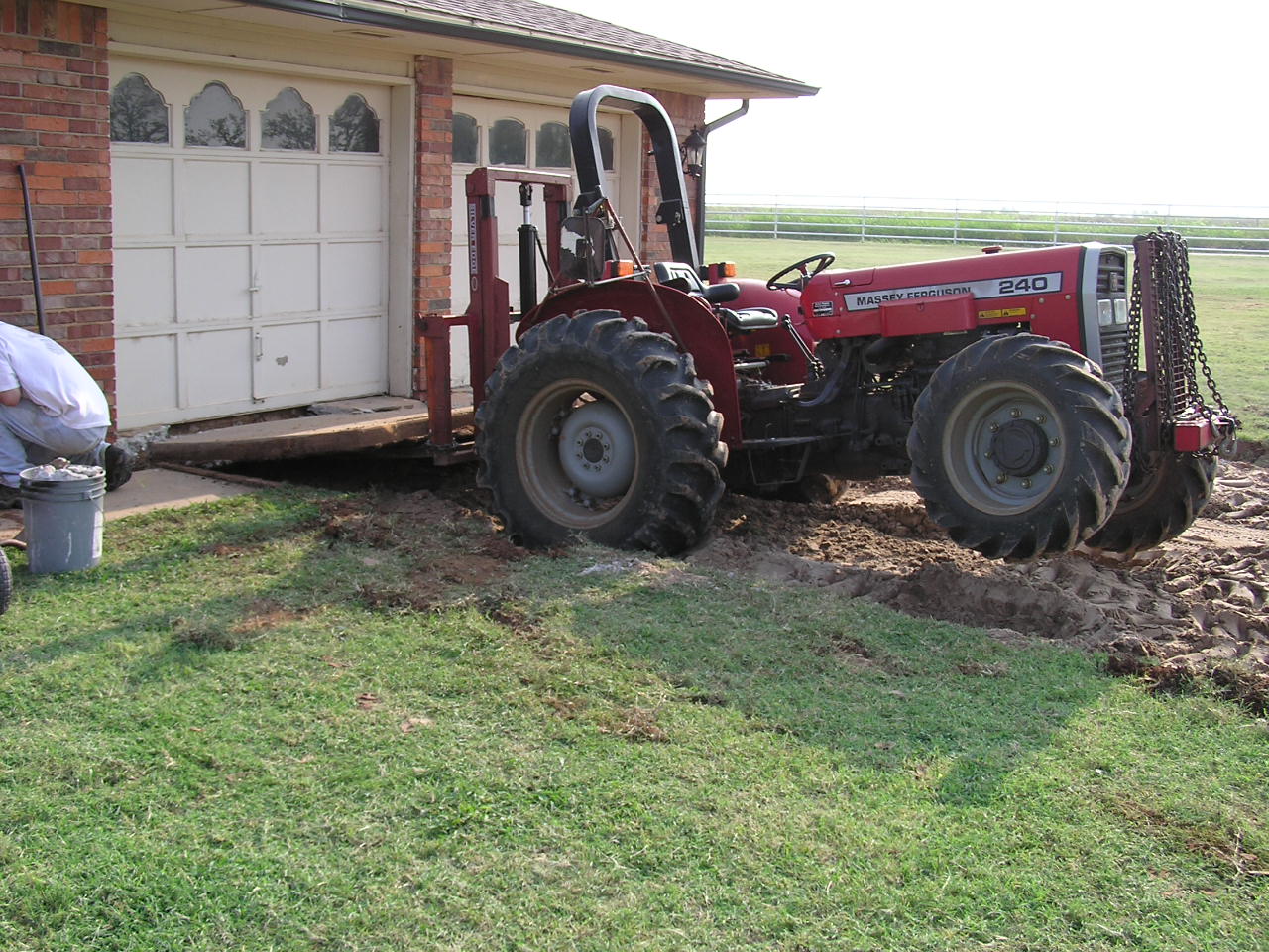

I have had to steer with the turning brakes, seems like the front tires didn't have traction. :D
Pictures from 2004:
   / Front Wheel Brakes? #27
Pictures from 2004:
Nice! Never had the front end off the ground on this one, drove 2wds on the rear tires plenty.
