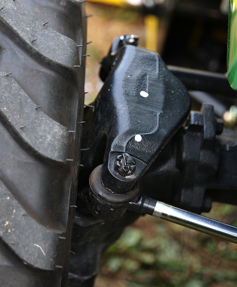

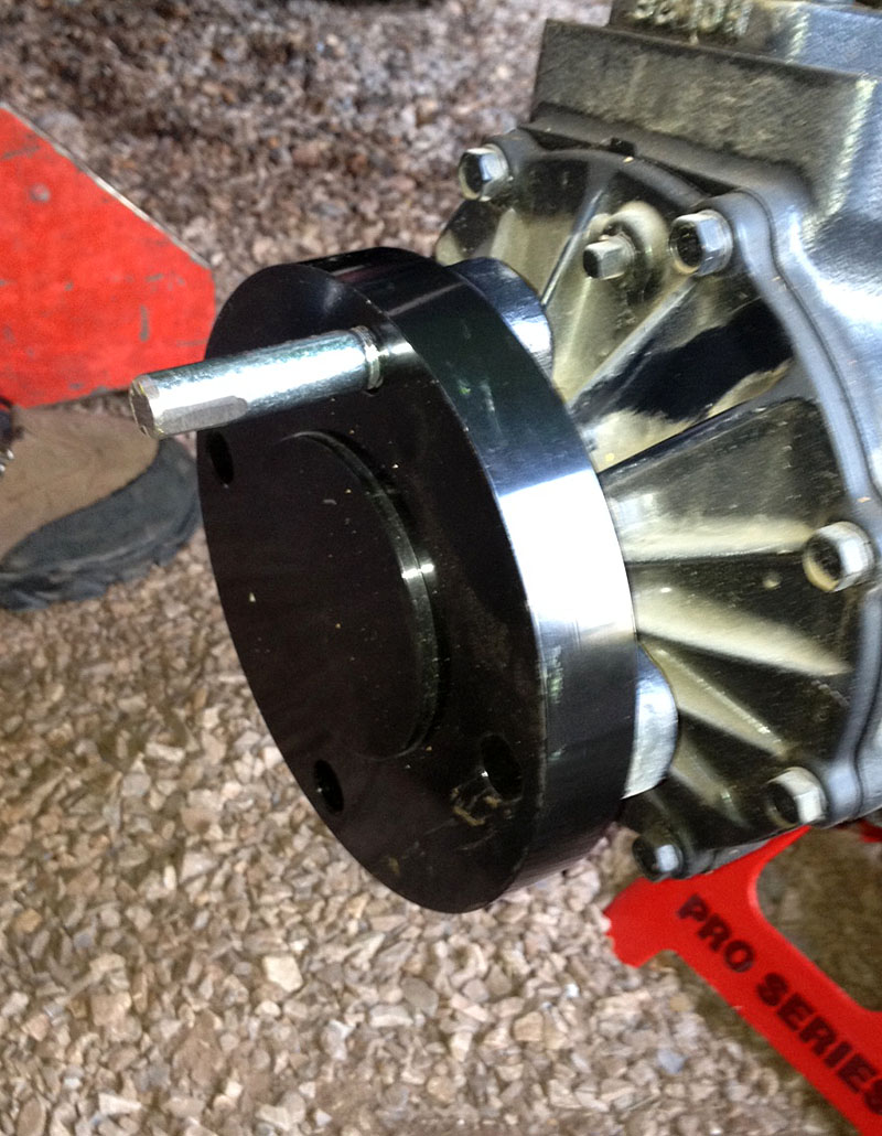

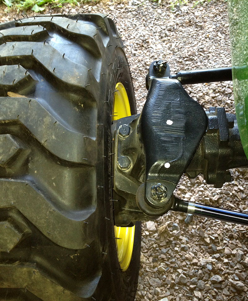

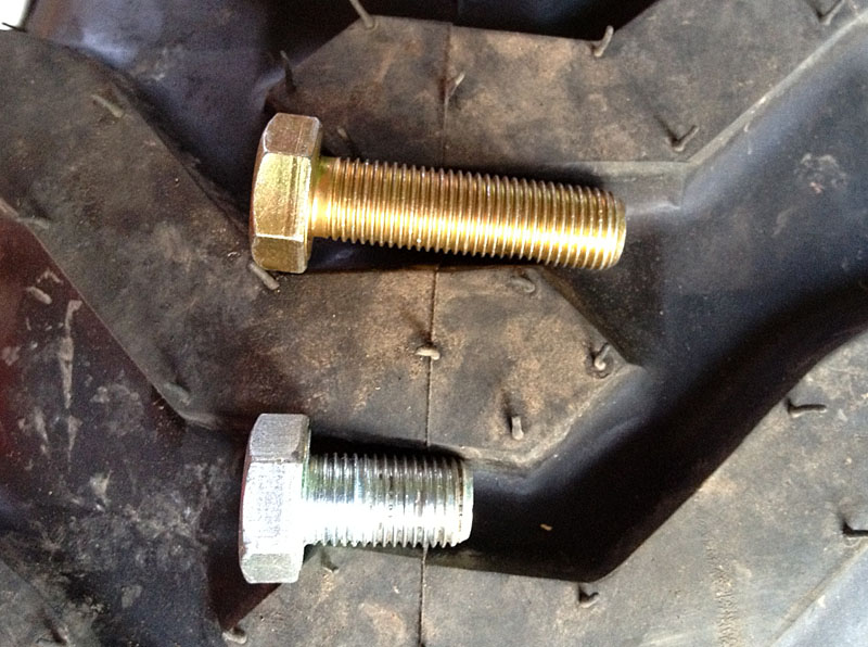

That might have been my post as I had once posted photos of my spacers when I installed them. Here they are again.
   / Front Wheel Spacers - 2520 - non-JD suppliers?
#13
Yep, big brother at work... but those are the photos I was referring to in the link. Thanks for posting. The after photo on the right is what I'm trying to achieve. How are the spacers working out for you jgayman? :)

My 4" solid aluminum spacers came from MotorSport. Search eBay for MotorSport tractor spacer. His include the second set of lug bolts too. Avoid the "bolt straight through" type, especially if you have a front loader or other potential stress on the front. Can't speculate on the price though. Alternatively consider a pair of offset rims

These were taken last September and the tractor only had like 3 hours on it.

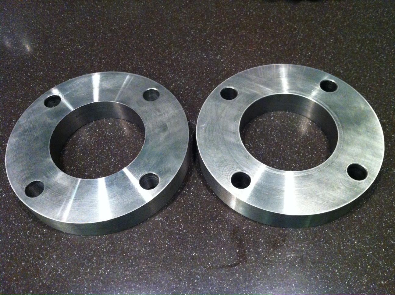

Fresh off the lathe... not sure these will work since the center was milled out unlike the OEM product which has a raised center for the wheel. I'll give em' a try though. Made in America by Americans... and can't beat the price -> FREE.
