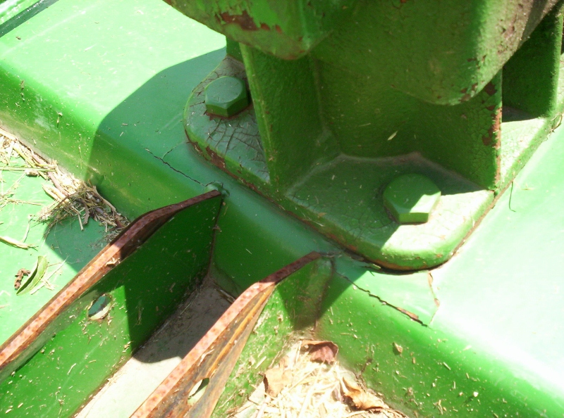

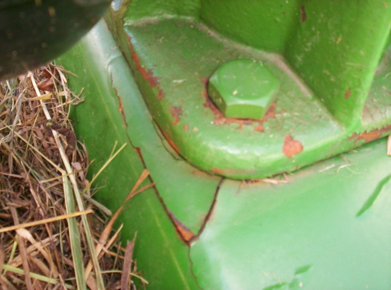

Lesson learned yesterday..
Don't beat on this unit/make sure gearbox bolts are tight! :(

Is it possible, that with all the rust showing underneath the paint, it might have already been cracked? Or maybe it had some stress fractures? If it really did crack when you beat on it, you must have really been pounding on it!
It does appear that the bolts are loose. I just wonder if it came that way, or if the bolts just loosened up? Are there lockwashers on the underside?
My fault for sure. This RC 1072 is only rated up to 1" stuff. This unit has seen it's share of 4" :ashamed:
I wondered the same thing. If not for the bolts being loose I don't think it would have cracked.
Good news is that it's all welded up. Had to take the stump jumper off (2 man job) to get to the bolts. This time I used lock-tight on all 4 bolts, then snugged them down as tight as possible.
Tested it out and everything seems fine, a close call for sure. $50 to get it welded and $15 for a socket to get the stump jumper off. Not bad, could have been worse.
Check those bolts! :thumbsup:
BTW - no lock washers
