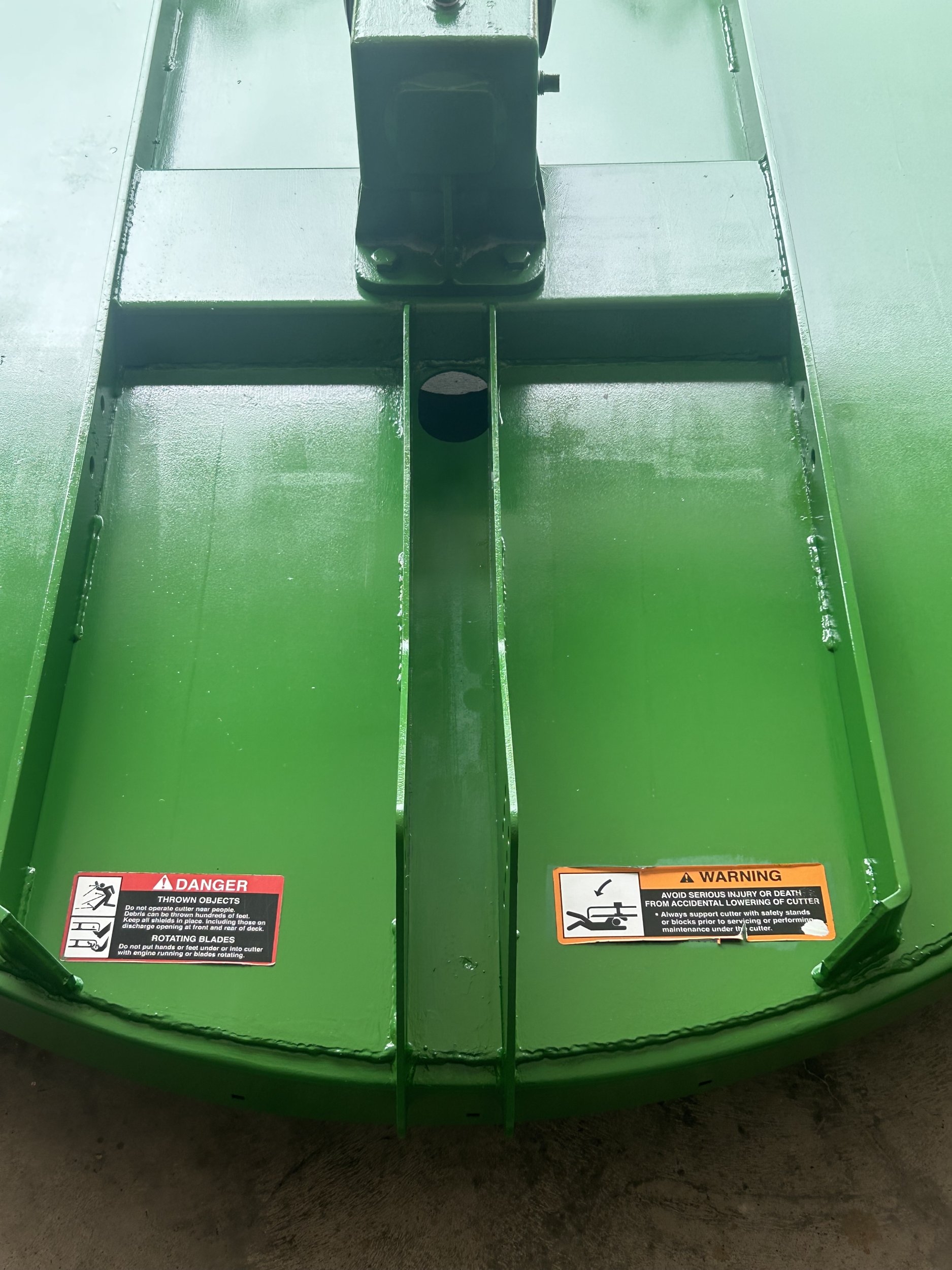

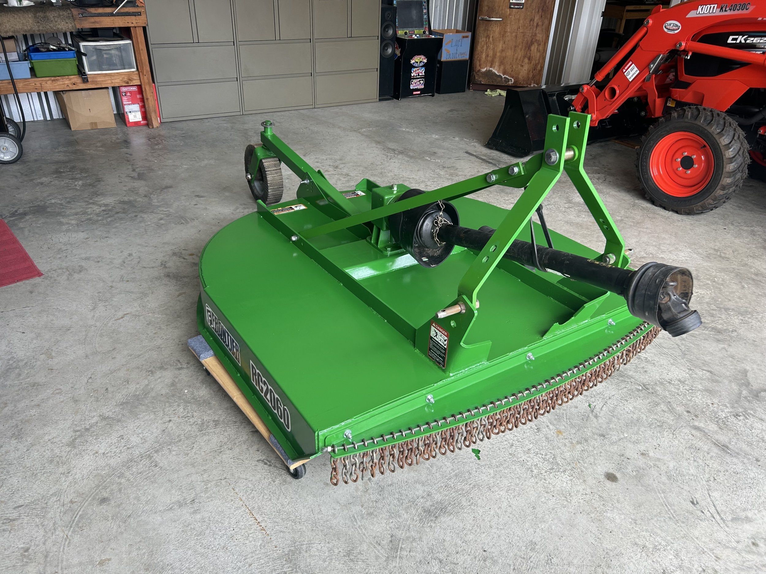

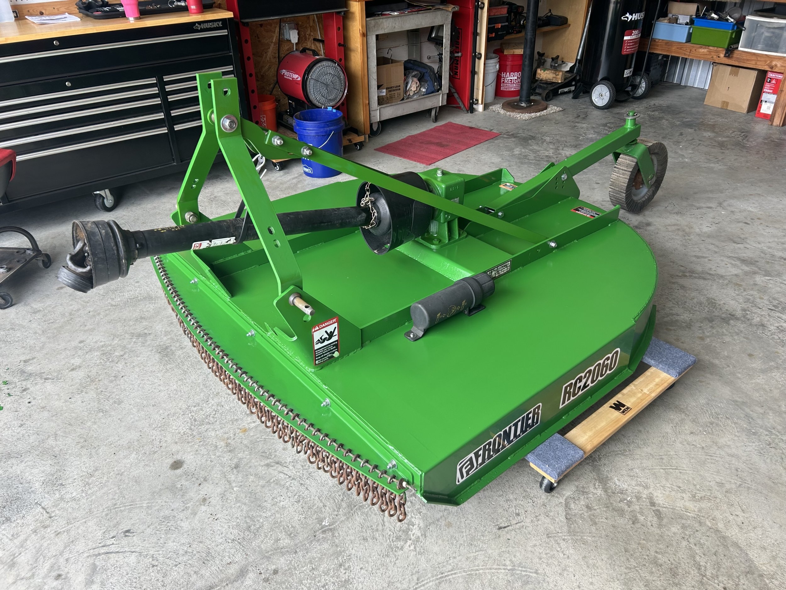

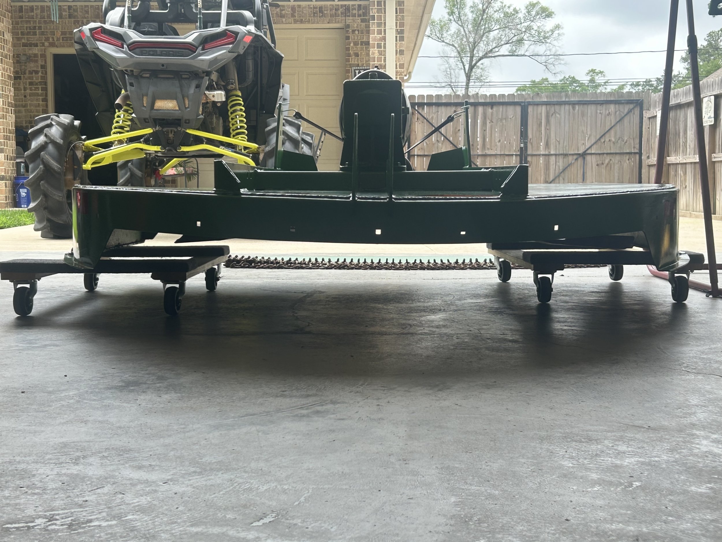

I like the mower, but when I had it apart to repaint it, I noticed the deck is warped. The back left corner is kicked up. No evidence of it being hit and restraightened. Also the angle iron that runs from front to back is crooked and wavy. It’s like whoever build it didn’t have a square or straight edge!!! I’m suprised

I was told about 10 years old but I’m not too sure. It had some rust in the corners where water sat I guess, I cleaned it all up, repainted, grease, oil, replaced all the bolts and nuts, even added washers between where the metal will rub kind of like bushings and reassembled. I know the deck being warped a little won’t affect the cut, long as I level the cutter off of the gearbox. just drives me crazy.
You can see the curve up in the picture from the rear.

That warpage is so strange. It doesn't look like it's been damaged or repaired. I have an RC1060 and have not noticed anything like that.
Not sure what the difference is between the 1060 and 2060, but it looks like your top deck is thicker and the seam between the top deck and side/rear skirt is a continuous weld as opposed to a stitch weld on the 1060. So I presume the 2060 is a heaver-duty unit.

I must have got lucky and got one made on a Friday. Or whoever this build was outsourced too, sucked!!! I need to put the rear chains on it, maybe I won’t notice it as much. But it definitely irritates me. I like things square and straight.
