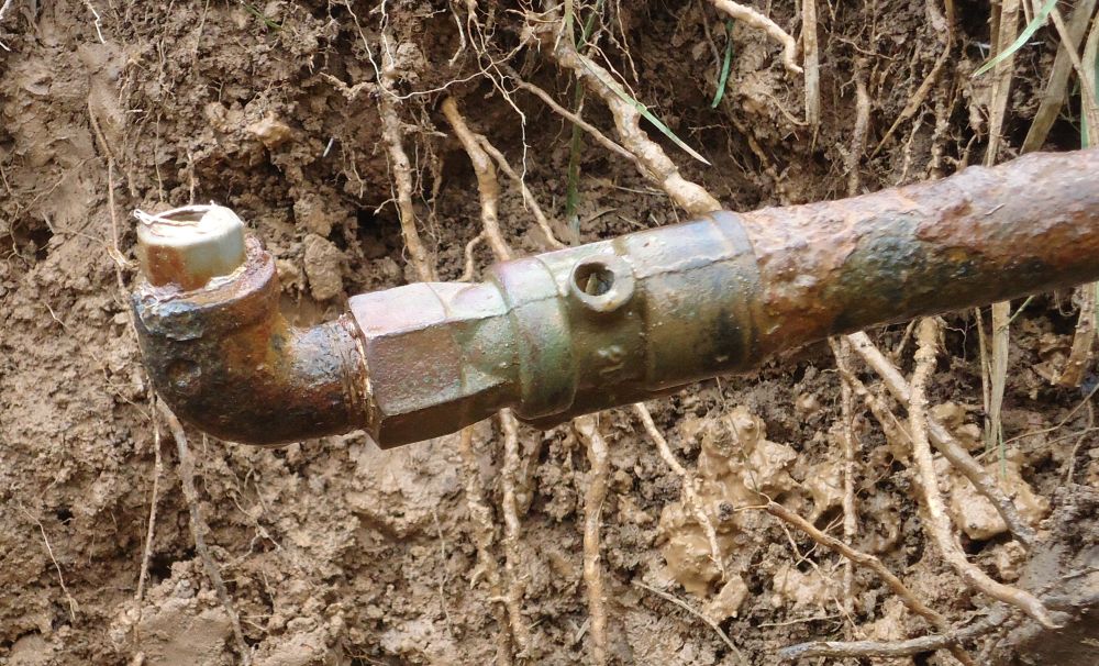

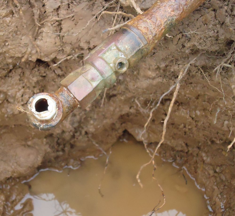

Hello again,
I dug to the base of the hydrant, and the hydrant was completely loose. I am now going to continue to dig to uncover the pipe. The hole is full of water, so I don't know if I will be able to make the fix today.
I have attempted to attach photos. Hope they show up.
/ Frost Free Yard Hydrant leaking down below #18
Looks like you need to replace the 90 degree ell as it has a deep pit in it that is about ready to pop. Any chance that you could get solid brass fitting to go from the hydrant to your water pipe. Do you have galvanized pipe for your water supply or PVC. I am surprised that the installer used a steel 90 and a plastic reducer unless you have pvc piping. I recently went thru an agonizing version of what you are doing when I added in a new line and faucet. The pipe (PVC) has only been in service 4 years but it became very brittle and hard to work with without breaking. I tied into the old line, ran my new line and found that I had broken the pipe further in toward the existing hydrant. DUG some more exposed the break, fixed that, more leaks further toward the hydrant. I started out about 6 feet from the hydrant and ended up digging all the way to the hydrant and replacing everything from my TEE-in point to the hydrant. The pipe was so brittle that any little tugging or bending when fitting in a new connection would break the pipe. It took me 2 days (allowing for overnight glue jobs to set in the 40F temps) to fix the little area of connections so it wouldn't leak.

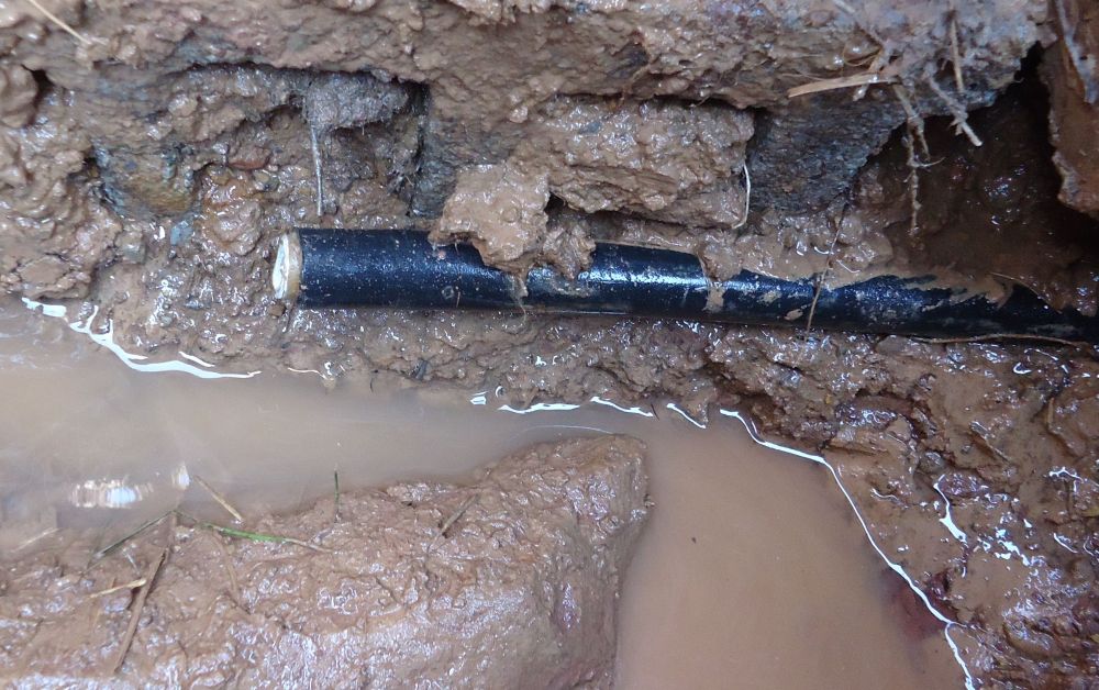

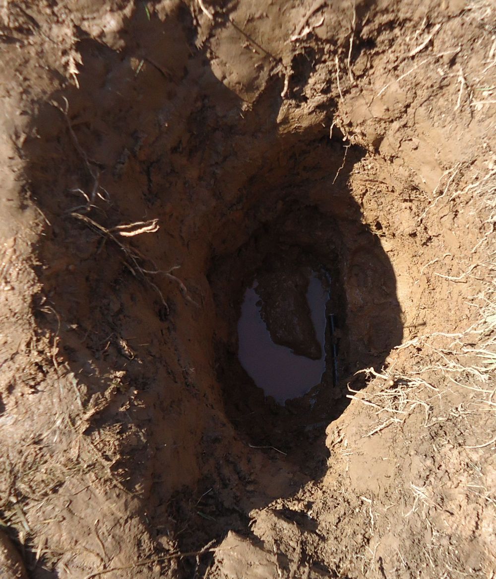

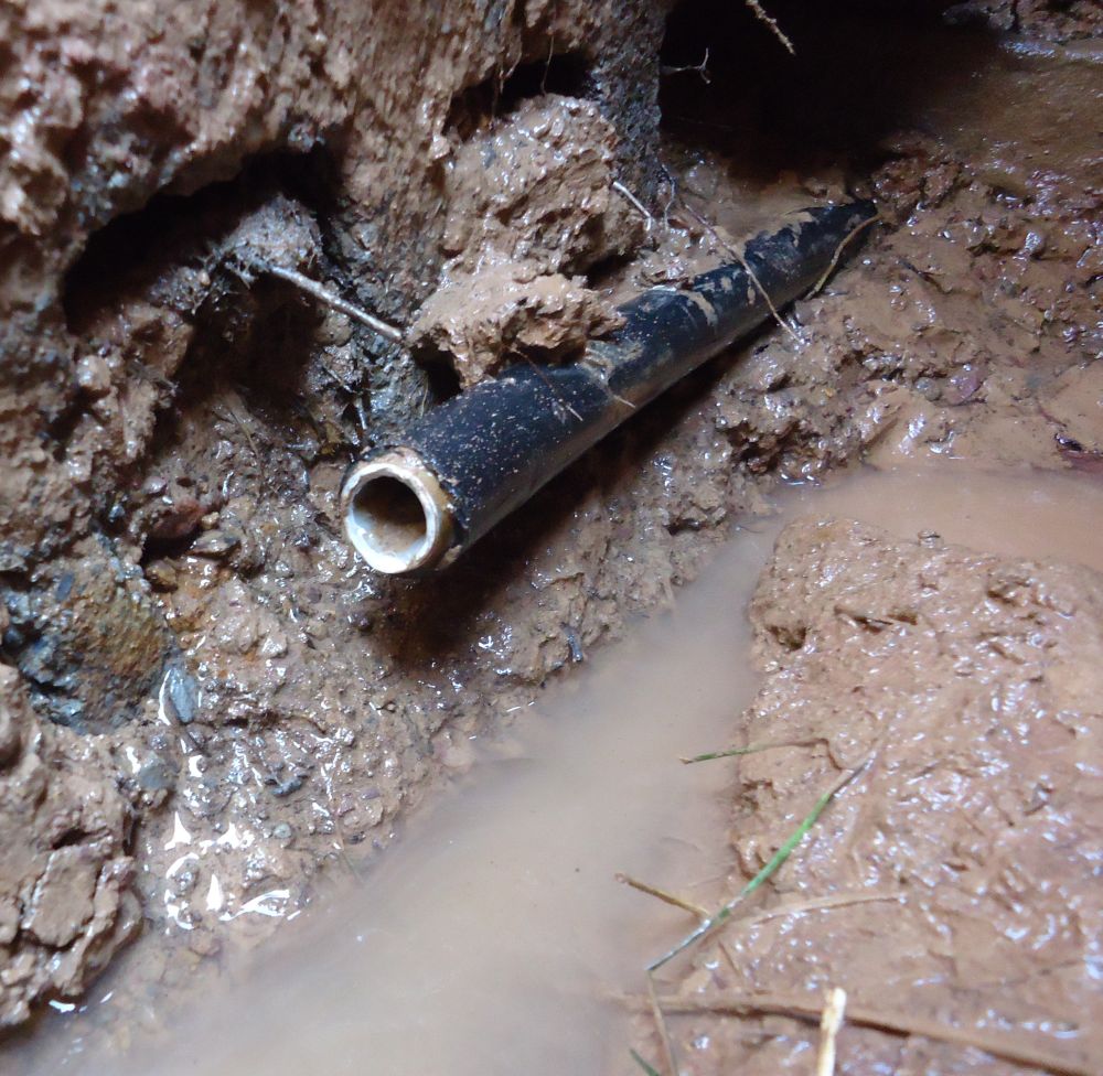

It is a black plastic pipe. Here are photos:
I am assuming that the white broken plastic piece is a barb that somehow attaches to the elbow. I am going to take the whole thing to a hardware store and try to get the parts I need. I hope the plastic is not brittle like the previous message mentions.
Do I need any kind of adhesive or can this thing just be plugged in and screwed on (assuming I can get the elbow to come off).
Here's a photo of the hole in case anyone is curious:
/ Frost Free Yard Hydrant leaking down below #20
That's black PE pipe- standard stuff. You shouldn't have problems with it being brittle. Thin-wall pvc stinks for underground use, but your PE looks like a reasonable psi-rated pipe. Not super thick but thick enough for what your doing. When you replace the unit, I would advise filling the base of the hole with a bunch of gravel- makes it a lot easier for the frost free to drain down.
Edit: with barbs you generally don't need any kind of adhesive. Just some heat, the worm clamp, and driver to tighten it all up. You'll need some teflon tape to put a new elbow on. Good luck with that rusted sucker!
