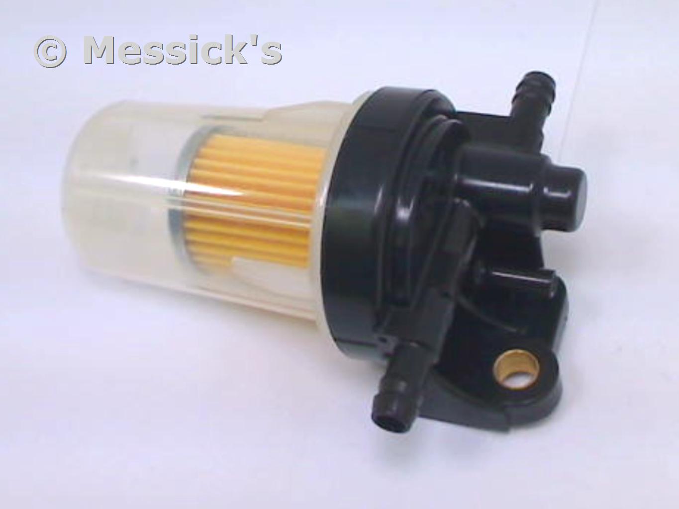

xerman. I cant find much on the factory filter you installed. Only a single tiny picture and no real description of the filter's specs. But it looks like it has no sediment bowl? If so, I can see why its still freezing if you have alot of water. The bowl is key to getting the water away from the face of the filter media. Do you have a better picture of the setup?
Is this what you have? I looked at that before buying my Racor. The Racor is a MUCH better filter.
   / Frozen, Gelled fuel #68
Scooby074, I am pretty sure the picture you show is exactly what I have. The bowl is about 3 or 4 inches deep and the filter takes up about 1/3 to 1/2 the size of the bowl. I just looked at the Racor web site. Is the part number on what you are suggesting 025-MBL-02B. Any idea how much they cost. I found a place that sells them about 25 miles from me. The picture of the Racor looks almost exactly like the one I have. But if the Racor can solve my problem I would go with it. My machine is useless at the moment. Just put $3,000.00 into a plow on the machine and there it sits unable to plow. You can imagine the grief I am getting from the Mrs.

It looks like Racor is the OEM for the Kubota part. Racor makes a TON of filters of various features and qualities however.
Im not going to say the Racor is a miracle worker... but it does work good! They have a great and well deserved reputation.
I completely understand your frustration after buying that plow! Hopefully we can get you going and keep the Mrs off your back!
Alot of guys on here have no problems in the cold, but alot of them keep their tractors inside too, whereas mine is an outdoor tractor, and lives 99% of its life there, so that does complicate things.
What I didnt like about the factory filter was the small filter element and no sediment drain. and its made of plastic. The racor is much more substantial.
The Racor is only about $85 IIRC with the aluminum housing. Then budget on $50 for various hoses, fittings and other misc. Its a much larger filter, about the size of a car oil filter. If your having really extreme issues, there is even the option of adding a fuel bowl heater too.
Model# is Racor 120a S. It does NOT look like the one you have. On the filter itself there is a letter, it signifies the filtration level, mine is an "S" which signifies its a 2 micron. It has to go before any lift pump (dont know if the RTV has one, but I assume it does) so that any water is not emulsified.
