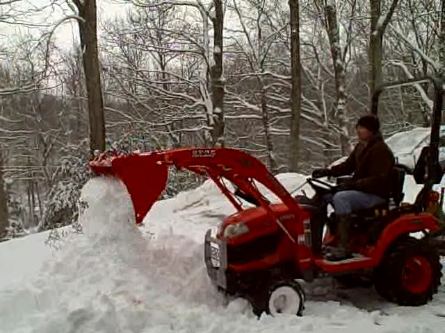

When I ran my BX-25 in the winter, I used Power Service to treat the diesel. And I never had an issue.
