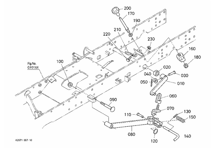

Take a look at the diagram.
It is a very simple cam and lever system.
1. Make sure that it's not rust frozen.
2. Make sure it's not bent.
3. Make sure there is no weight being put on the cam.
   / FROZEN GRASS HEIGHT KNOB
#12
Most excellent Diesel 185. That's what I needed to see to proceed. Now I'll start checking and lubing. Is that diagram from a shop manual, or did you find it on the web? Thanks again

When you lift the deck with your hydraulics to max height, the knob should turn freely.
Skipperbrown is correct but there is more to it than that. You MUST lift the deck to max height before you try to turn the adjusting knob. Early in the days I owned my BX2200 I didn't know that, turned the thing harder and of course broke the phenolic knob. The knob is ludicrously expensive.
Of course your enlightened lube job, etc. are the right moves but you might want to keep in mind the possibility that you got the parts in wrong, somehow.

That diagram is off Kubota's parts website...

I'm looking at the old broken one as we speak. Nothing holds it on except for slight spring tension ( a sort of thin piece of spring metal I think, missing on my old knob) and friction. The hole in the knob is round on one side and flat with a deeper flat channel on the other side of the hole. The hole very much resembles that of the old electrical knobs that used to pull on and off of car radios, only larger. Typical car radio volume controls and on/off knobs had a flat side on the shaft if you remember.
It should not come off the shaft too easy. If it seems almost loose and comes off very easy then someone has turned it by force and probably cracked the knob. That might even be why you cannot adjust deck height. If your parts are together right, then turning this knob & shaft should be moving a cam up and down along an inclined plane out of sight under the sheet metal. With the deck held up by hydraulics, the only weight being raised or lowered by the knob/shaft/cam is the weight of the linkage.

OK, i GUESS THAT i'M A DUMB ***!! AFTER ALL THAT, WD-40 OVER NIGHT FREED UP THE **** KNOB Now I just have to see that the unit adjusts properly up and down. This site has given me more insight to the inner workings of my last three tractors, than the manuals that came with them. Thanks again so much. Maybe some day I'll be able to give someone a hand in return.
