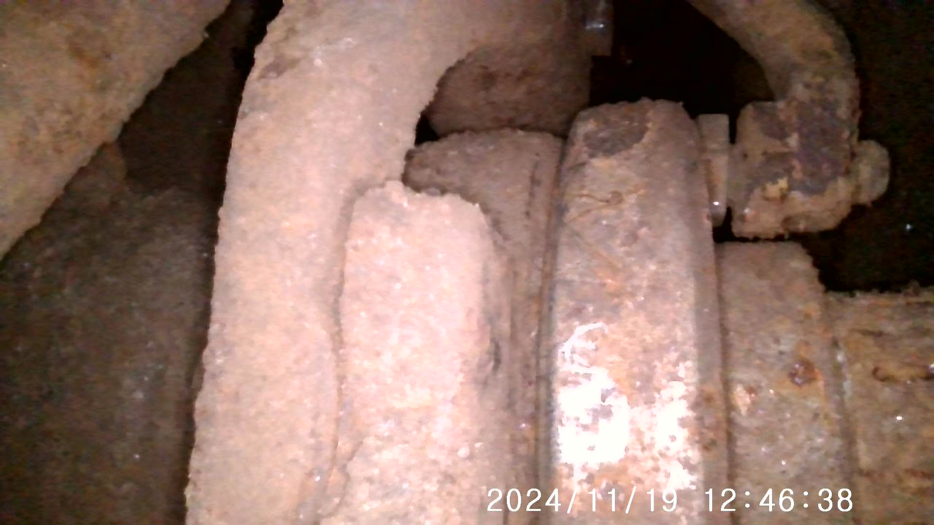

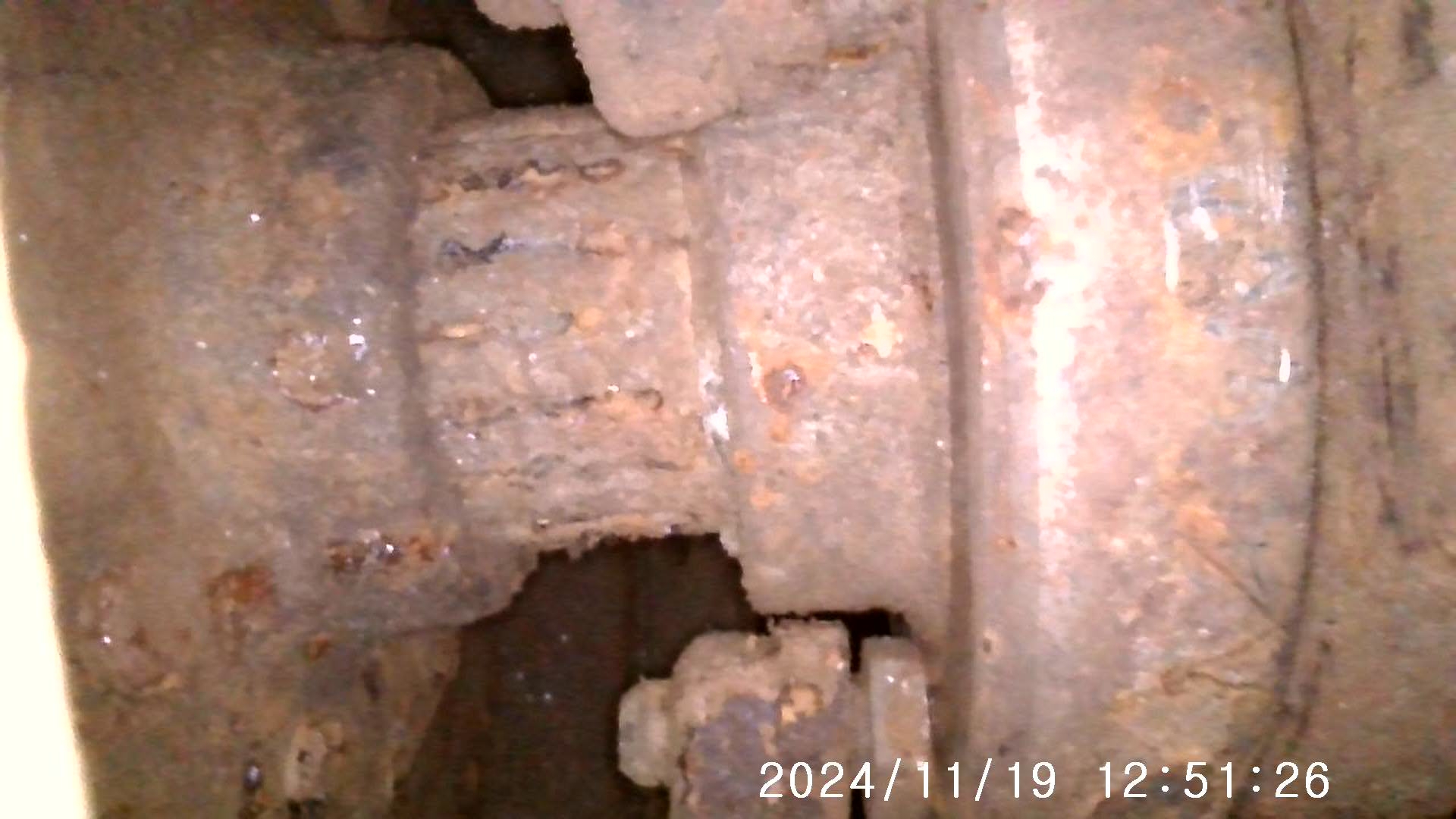

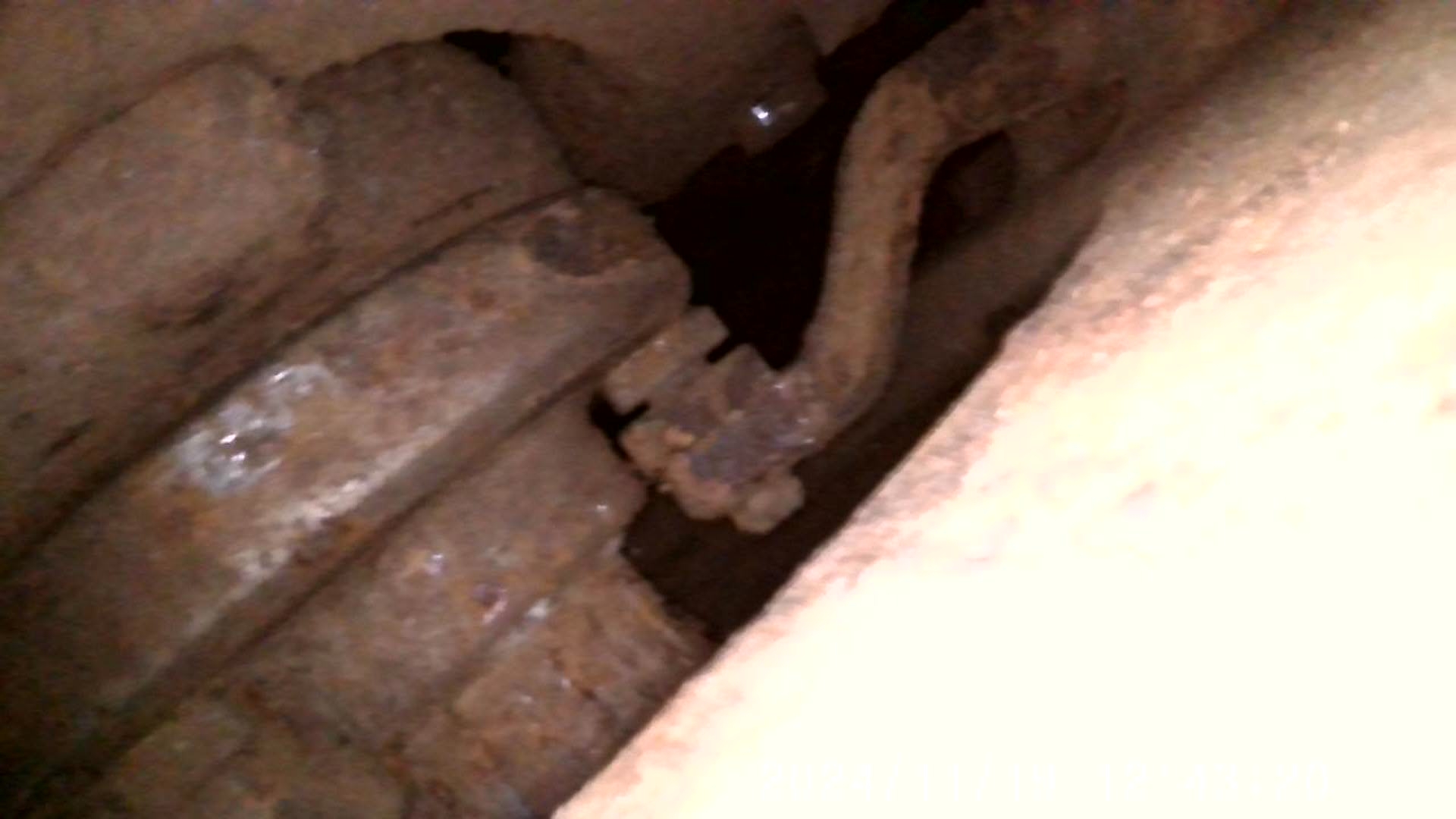

All good, but full descriptive info, several posts back, indicates that the bearing wont slide as needed to operate the pressure plate. The clutch pedal cannot be depressed. The lever in pic 6560 will not move.
The clutch plate may be stuck to the flywheel some too, but our actuation inputs are blocked prior to the point we could determine that.
   / Frozen Throughout bearing on Kubota L2250DT
#30
Hey All,
Well I did get a look inside, It doesn't look good:eek:, Apparently last summer when we had a big rain in Aug at that property, it must have gotten water into the clutch housing , because it is just rusted terribly,So I guess it needs to be split,I'll put a few pictures up,
I'm Sorry to have wasted y'all's time, with this issue, I might need some insight into the splitting job, but it seems straight forward, That is not happening till after the summer ,All the suggestions were Great, Thanks,
