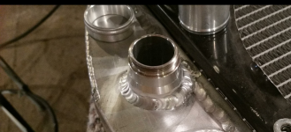

That first pic is an embarrassment...
Here is a barely acceptable aluminum weld that I did for my brother - moved his radiator inlet.
Yes, I know it looks bad - but I'm willing to post it for what I consider the bottom of acceptable...
Aluminum welds by a shop that does this all the time should look much better than my pic.

Welding aluminum on a bench is one thing but welding an aluminum hull that has been in the water is another, especially if it was in salt water. I've welded on many types of aluminum hulls and the most important thing is the prep and cleaning prior to welding. If theres a crack or a hole it's going to have corrosion in it and as soon as they put heat to it they'll blow a hole in it, and if they keep trying to weld over it their just going to make a big mess. You need to find someone who has experence with this type of work, or possibly someone who repairs aluminum tank trailers if your away from the coast.

My modification to the brothers used radiator was harder than welding new aluminum - lots of trash would randomly float into the puddle from inside.
Old Triumph motorcycle engines cases were difficult too. Same for aluminum transmission bellhousings.
Have to weld clean aluminum sometimes just to prove to myself that I actually know how to weld :laughing:
