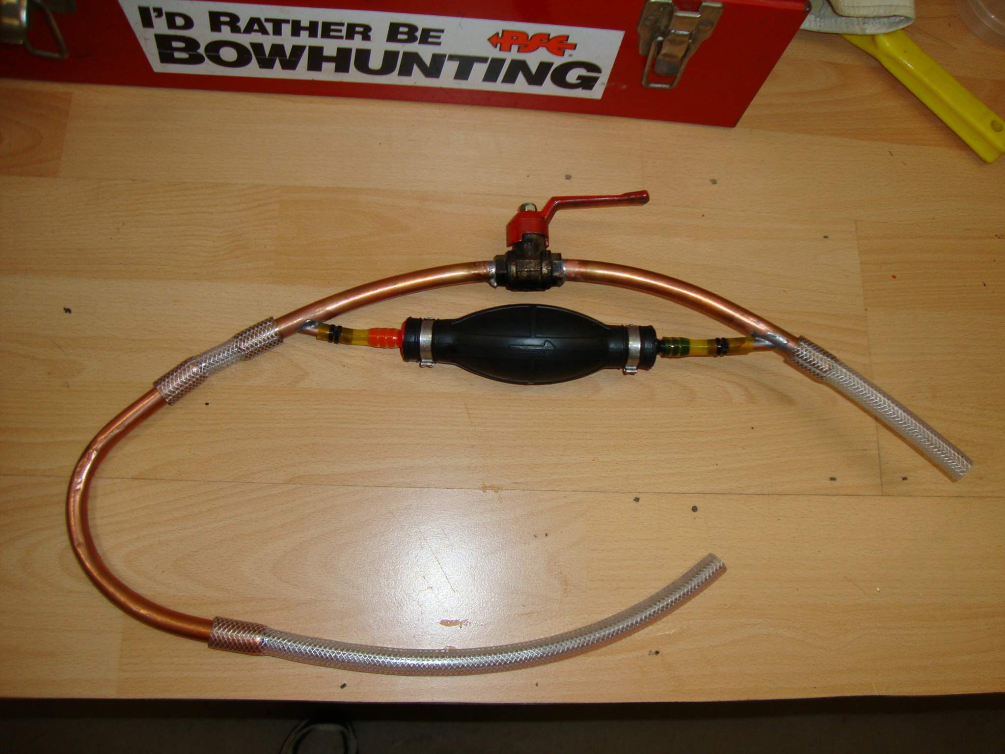

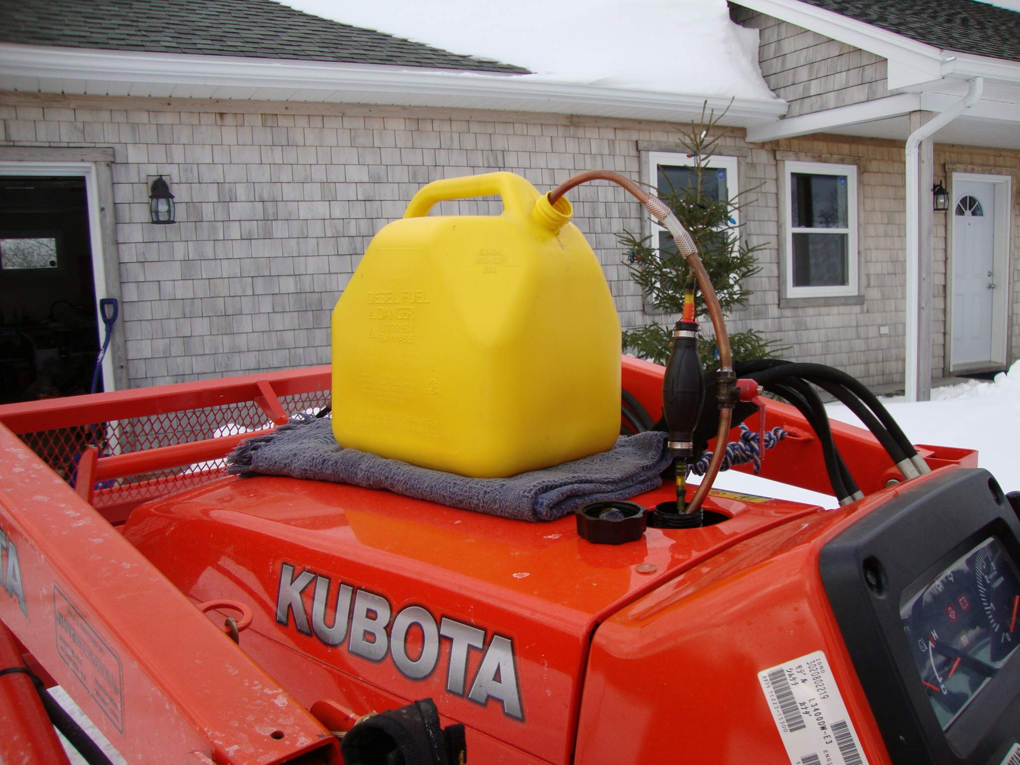

I built this with some copper tube, an outboard priming bulb, and a ball valve. Close the valve, squeeze the bulb until fuel flows into the tank then open the valve and wait three minutes til the can is empty. Works like a charm.
