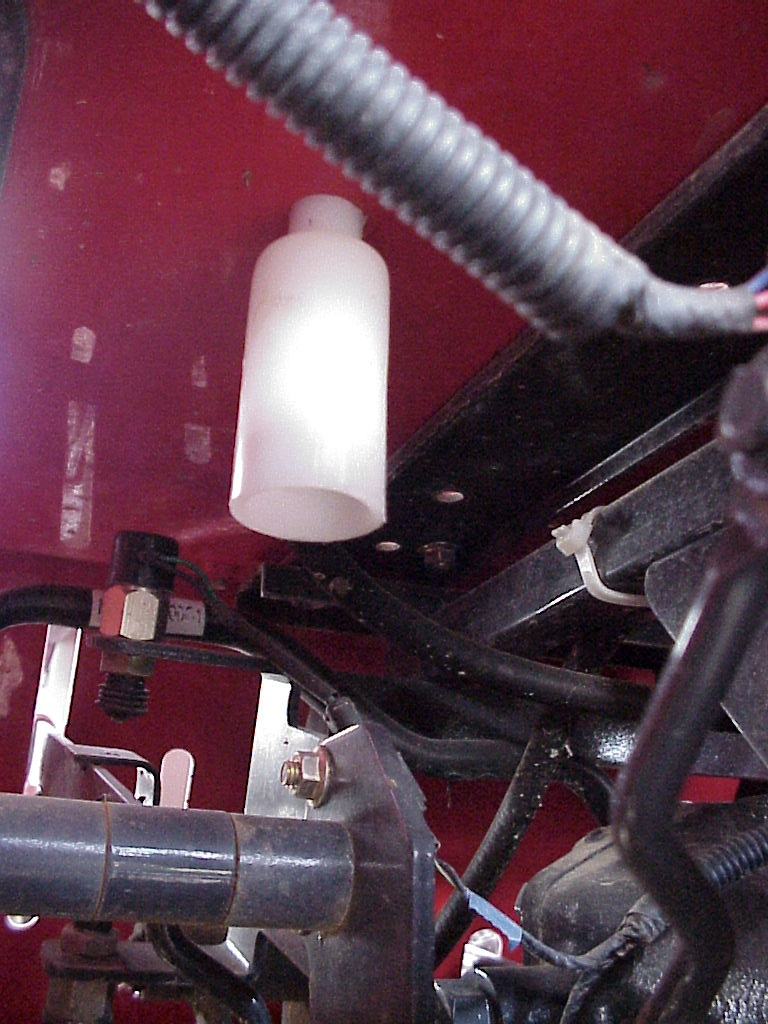

You are correct about pressure building up. There are 2 tank vents(I think they are vents-white cylinder shaped) located under the seat area. Pic attached.
Shortly after I first bought the tractor on a warm day with the sun shining on it, fuel would leak out of one of these vents. This was with the tractor cold not running. I had to loosen the fuel cap to relieve the pressure and then it would stop leaking. I haven't used the tractor much this past summer dealing with a family member dying from lung cancer. Now in the fall using it a little more and no more leaks from the vent but it leaks from the cap if I'm on the slightest downgrade. Most of my property is sloped so lost a considerable amount of fuel. I should pull off the lines leading to the white plastic vents and test it then to see if it leaks. Maybe they are plugged.

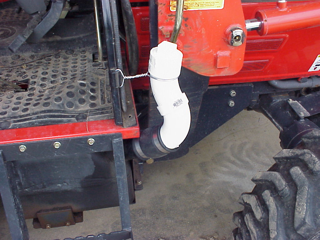

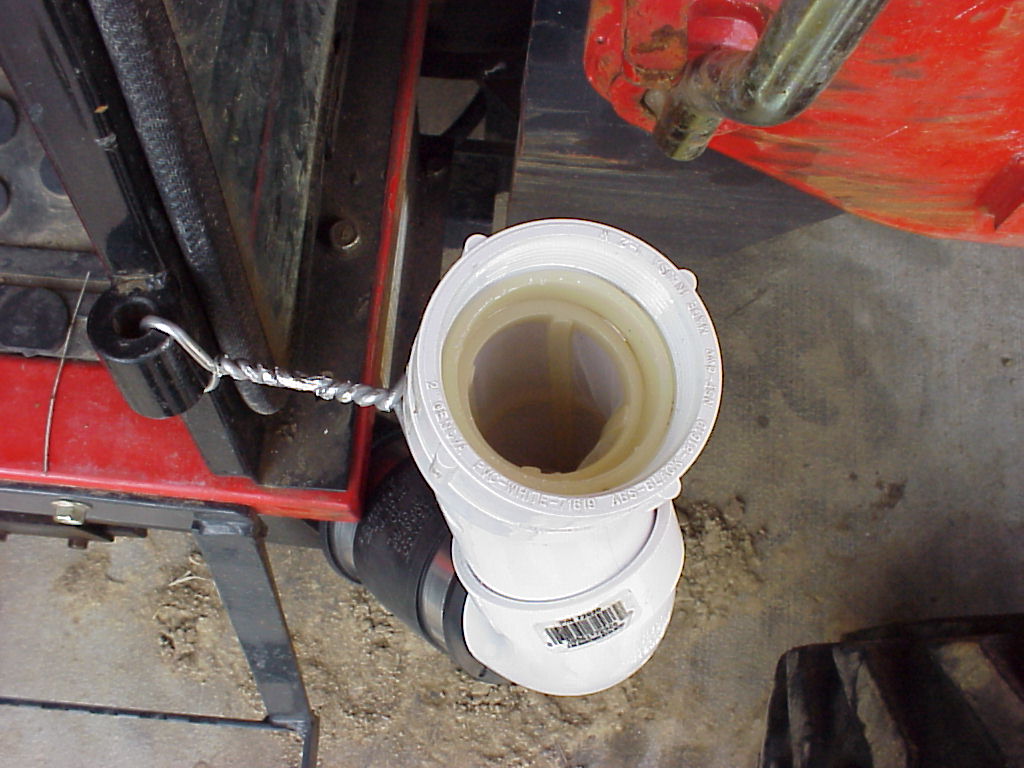

I need to use my tractor and fill the tank. Since Branson would not give me the time of day on a fix for it, I came up with this temporary fix until I figure out something better. No leaks...so far it works.
The fuel screen also fits in it. Don't know if the fuel will eat it up or not, so how long it will last remains to be seen.

I don't think my first attempt for input worked. I like your setup but some info for your setup. If the rubber coupler in your photo is from a building supply store for water/sewer, the hose is not compatible with fuel. The fuel will attack the hose softning and eventually turning the hose to a jelly like substance. I don't think you would want this in your fuel system. If you go to a auto parts/tractor supply store and ask for fuel tank filler hose of the correct diameter they will should be able to supply you the correct hose. It is sold by the inch is a little pricey but worth the cost. Be careful some of the lesser experienced parts people will try and sell you straight hose for a radiator/engine connection and it is not compatible with fuel. I cannot speak about the PVC part of your setup but maybe someone else can add some input. Oh yes, the filler cap on my 2810 also leaks! Good luck.

jgreen thanks for your input. The rubber coupler came from a Tractor supply store but not sure if it is compatible. I am going to check into it deeper before I put it to much use.
This problem seems to be more wide spread than previously thought and Branson really should address this issue, not sweep it under the rug.
