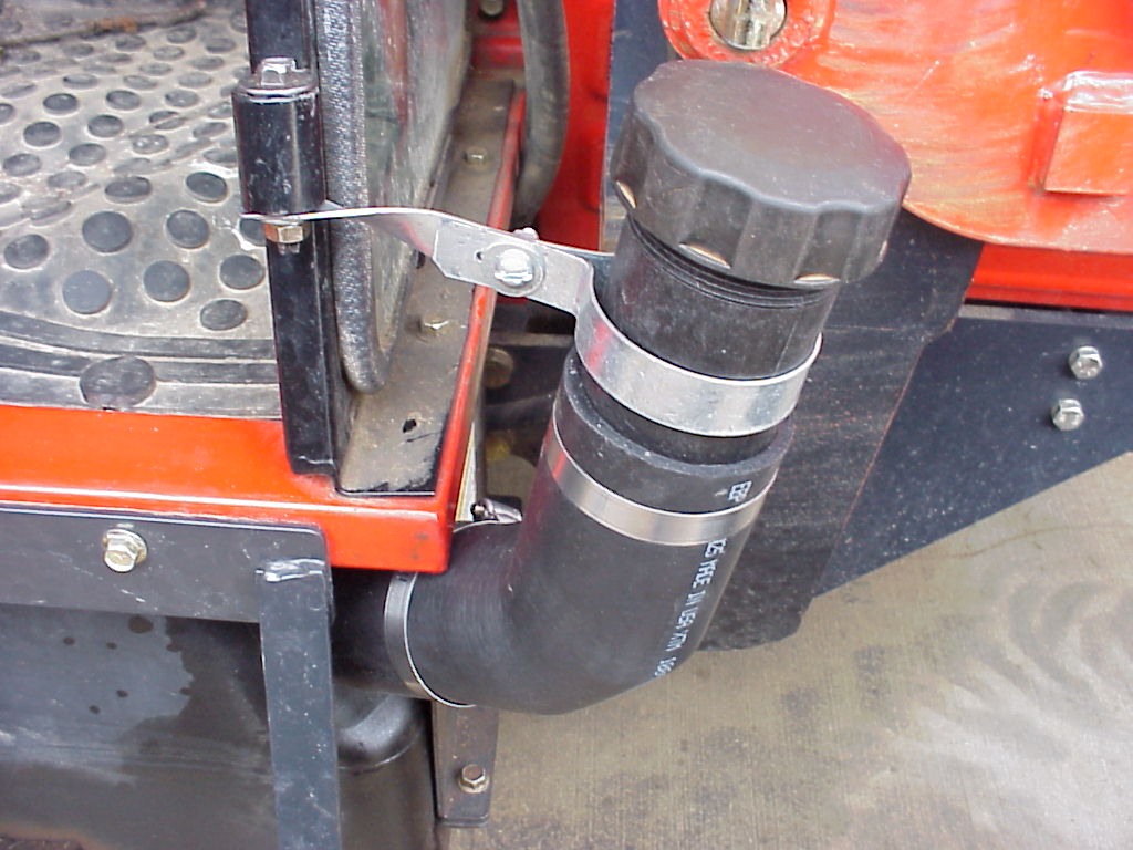

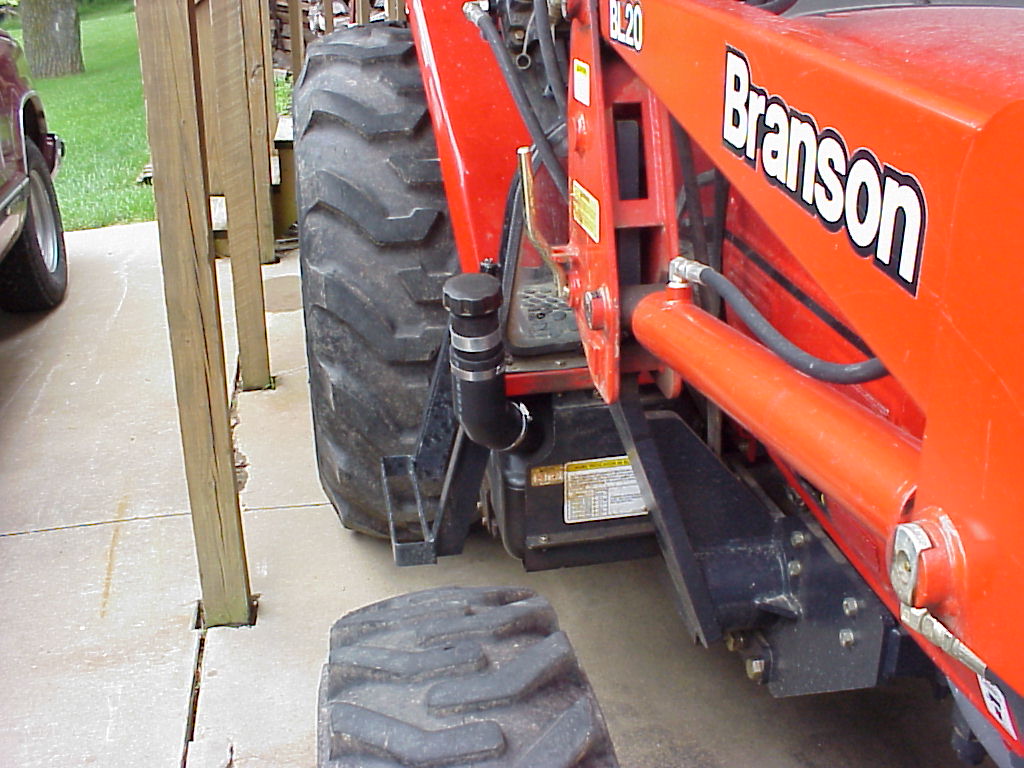

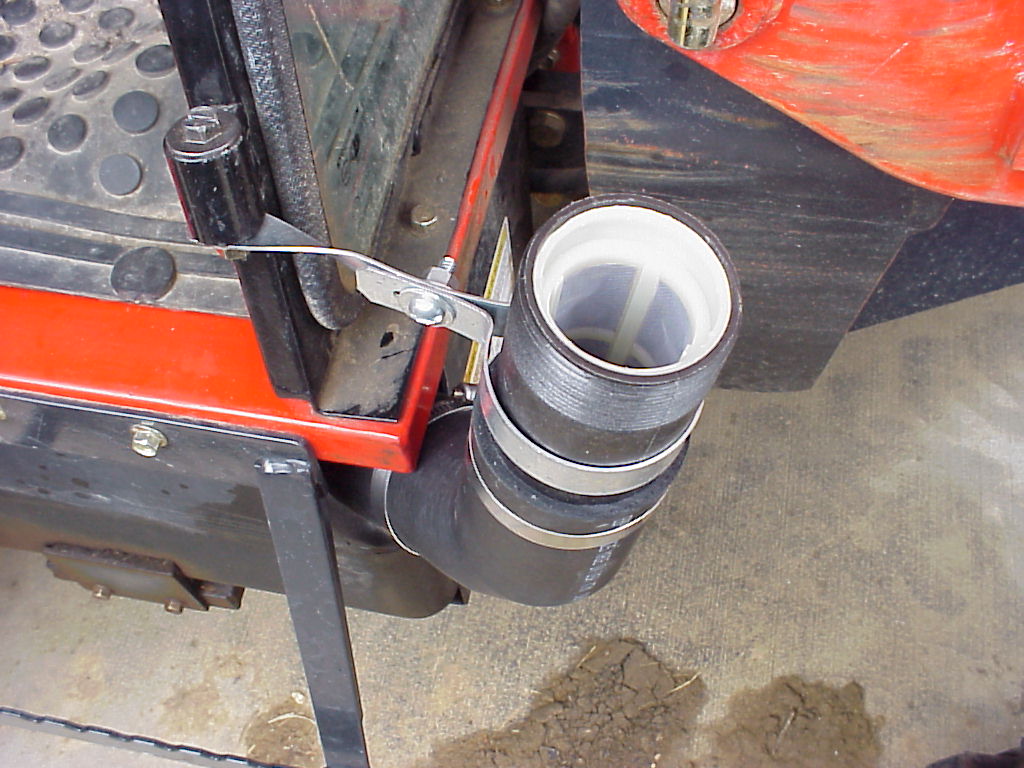

I didn't like my previous setup. I redid it, this one will hold up better. The angled hose is Gates 24713 Fuel Fill Hose. No leaks so far in a quick test but haven't put it in actual use yet. If it doesn't look like it is going to hold up I have one more idea.

Ron, what did you do there?
Did you just saw the short neck of the tank off, then put the hose and clamps in between?

anthony,
I left the fill tube as it was, so no damage there. I had an auto parts store order the angled hose from Gates. The other tube I picked up at a farm supply store. A description of it said for petroleum use so I'm hoping it holds up. It is threaded on one end but not the exact threads needed. I had a spare cap that does tighten down on it. If it damages the threads...it's only an extra anyway. If this tube doesn't hold up I was thinking about getting a piece of stainless pipe and have it threaded. Of course it would be even better if Branson could come up with a mod for it from the factory since they admitted that it leaks.
Have a good one.
Ron

Just a little update if anyone is interested.
Fuel still leaks out from around the cap but not quite as bad. The cap doesn't tighten tight enough since the threads are wrong. I need to get a fill tube from a Branson tank. That would work I think. Talked to Branson to see if they had a junk tank they could cut the fill tube off of and send it to me. They said no at first but will check. Didn't hear anything back yet.

Another update:
No More Fuel Leaks!!! Setup looks the same as last pictured but now with the right fill tube. Branson sent me the fill tube. Gave it a work out this weekend and didn't spill a drop. :)

Maybe this is a little late. I took a fine file and squared off the top of the filler so it was smooth. I then used a marker around the surface and screwed on the top to make sure it was making contact. No leaks.
